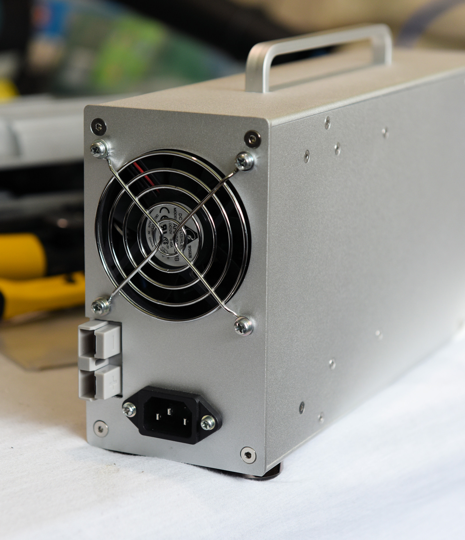

Remove the back plate , and you will reach the 2 output terminals .
You purchased pre-made SB50, didn't you ?
Posts: 4446
Postby Burgerman » 22 Mar 2019, 11:09
The andersons with cable already attached are going to be very hard to fit.
You will need a loose one. Easy to buy on ebay cheap.
Theres not exactly a lot of room in there. Mine has thinner silicone heat proof cable, (same size as the PL8 leads) since its more flexible etc. It runs from the boards output (with 2 ring terminals soldered on of course) to the Anderson. And a 2nd wire, from the anderson to the front facing connectors.
So the andersons have 2 wires in each terminal. Its the best way to make a neat job. Also everything is soldered.

Postby LROBBINS » 22 Mar 2019, 12:43
With a small screwdriver to hold down the springs you can also pop the pins out of the Anderson connector in order cut the case to fit it, then pop the pins back in.

Postby shirley_hkg » 22 Mar 2019, 15:02
I think BM means bi-wires at each Anderson pin ; as a Y-spliter.
One goes to the supply , and the other goes to the front power pole.

Postby Gnomatic » 22 Mar 2019, 15:53
Interesting. I have an Anderson on the back of mine, but wired it up a bit different. I have two sets of wires connected to the board's outputs(via crimped/soldered ring terminals). One set runs to the front connectors, and the other to the Anderson. I used 10 Awg silicon wire I believe. And yes its a very tight fit in there, especially with a 25mm thick fan installed. But it all fits after a bit of fuss.
Posts: 2118
Postby Burgerman » 22 Mar 2019, 16:03
Yes. Strip 1.25 inch of insulation in the middle of a wire. Easy on silicone as its soft. Fold wire in half. Insert into Anderson connector pin and crimp/solder.
Supply >>>>>>>>. Anderson >>>>>>>>front connectors
Makes the fight for space etc easier.
