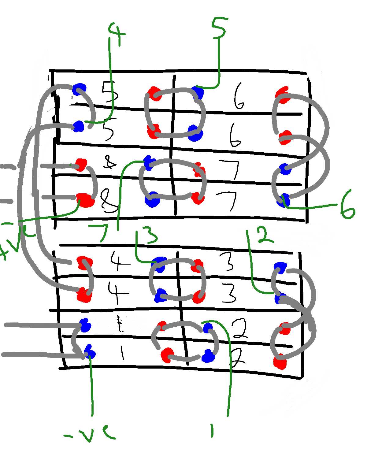

Postby Scooterman » 22 Mar 2019, 11:29
Can someone check these connections please?
A while back for the links I bought 6mm pvc (fine strands) and 6mm lugs.
On hindsight I probably should have bought 10mm, but the scooter only draws 100A max continuous (single motor), and I'm a lightweight.
I was gonna double up on the series links as shown in diagram. I messed up making the second pack, cells 8 should have been where 5s are and 6 & 7 respectively.
Green are the node wires, will it balance or :ambulance
I will probably use some of shirley's thick silicone cable for 24v to controller. In diagram it's shown as 2 x 6mm
EDIT because the seat post is inbetween the two pack, the series links between 4 & 5 will be longer than the rest. There's nothing much I can do about that.
Postby shirley_hkg » 22 Mar 2019, 11:44
IT IS CORRECT !
