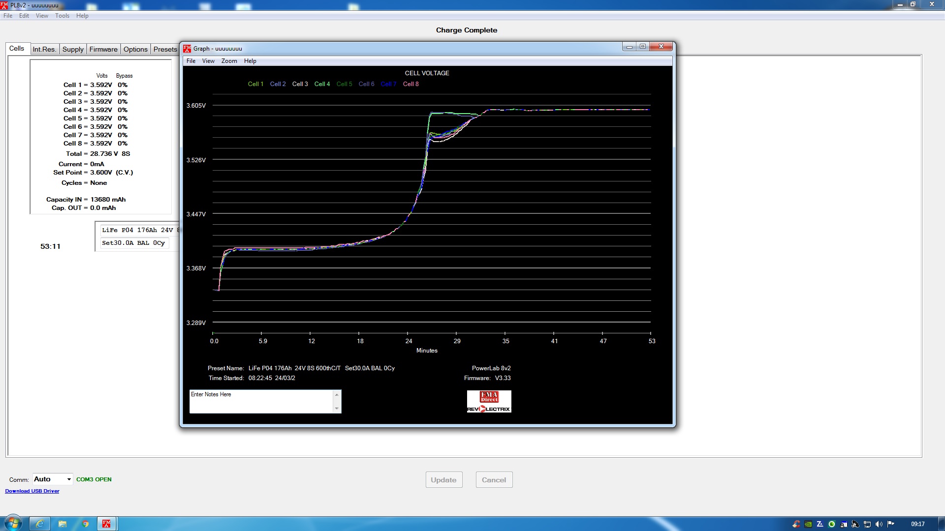

Postby terry2 » 24 Mar 2019, 10:21
Burgerman wrote:Did you go far? Compared to when lead?
Only the 2 miles or so.
I did discharge the pack a bit when I saw how the 2 cells was out of sync.
Just charge it and here are the results.
