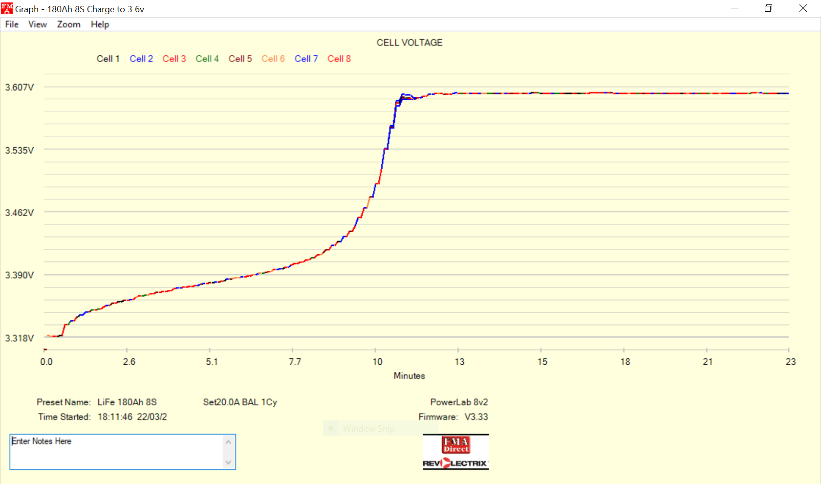

Terry, when you next charge your pack can you post a picture of the cell resistances, I'm just curious as I've never seen anyone elses.
If you don't know, at the top of the graph you click view, then cell restistance.
Thanks :thumbup:

If you crimped all those inter cell connections they will be all over the place probably. If not now, in a few months.
Also its normal for 1 and/or 8 to be high, because those cells also have long charge cables added into the measured data.

EDIT: This is what I got, I hope they're okay. But the charge was done on the bench and as you say I will probably get problems down the road in the scooter if I leave them with crimped connections.
Postby Burgerman » 24 Mar 2019, 11:04
Unless you are charging like a hobby pack with 3 inch cables thats quite normal.
The cell resistance is lower than that.What you are really measuring is the charge cable and connectors mostly...
So unless one of them is drastically different ignore it.
Do you realise that 2mOhm is basically a loop of wire cable? Its extremely hard to accurately measure battery resistance at such low levels accurately. 2 milliohms is equal to just 0.002 of 1 ohm.

Wow, thank you BM that's reassuring. When I compared my measured cell resistance with the spec sheet for my cells, the spec sheet stated a much lower level, and I was worried I'd done something to damage the cells when my old PSU went up in smoke and the graph went a bit haywire, and I was still learning then so wasn't very confident in my knowledge. I'm more so now.
This is the charge from 3.5v to 3.6v. When I'd built the 2P8S pack, to get the cells to balance I had to charge each 2P cell group up to 3.5v, then hooked them back up as 2P8S and charged to 3.6v. And I was pleased they seemed to balance okay.

Looks OK to me.

Here is the graph

Well you used 21Ah. Out of 176?
Thats 176 div by 21 = 8.3. So you can go 8 times further than that.
So 8x your 6 mile spin and shopping is 48 miles. If you skip the shopping you can likely almost double that. But you should keep 10Ah in reserve. So call it 70 miles with 6mph running. You better take some packing up.
However, take a look at the inter cell connections when you can get chance. They should all stay relatively close together on that graph.
