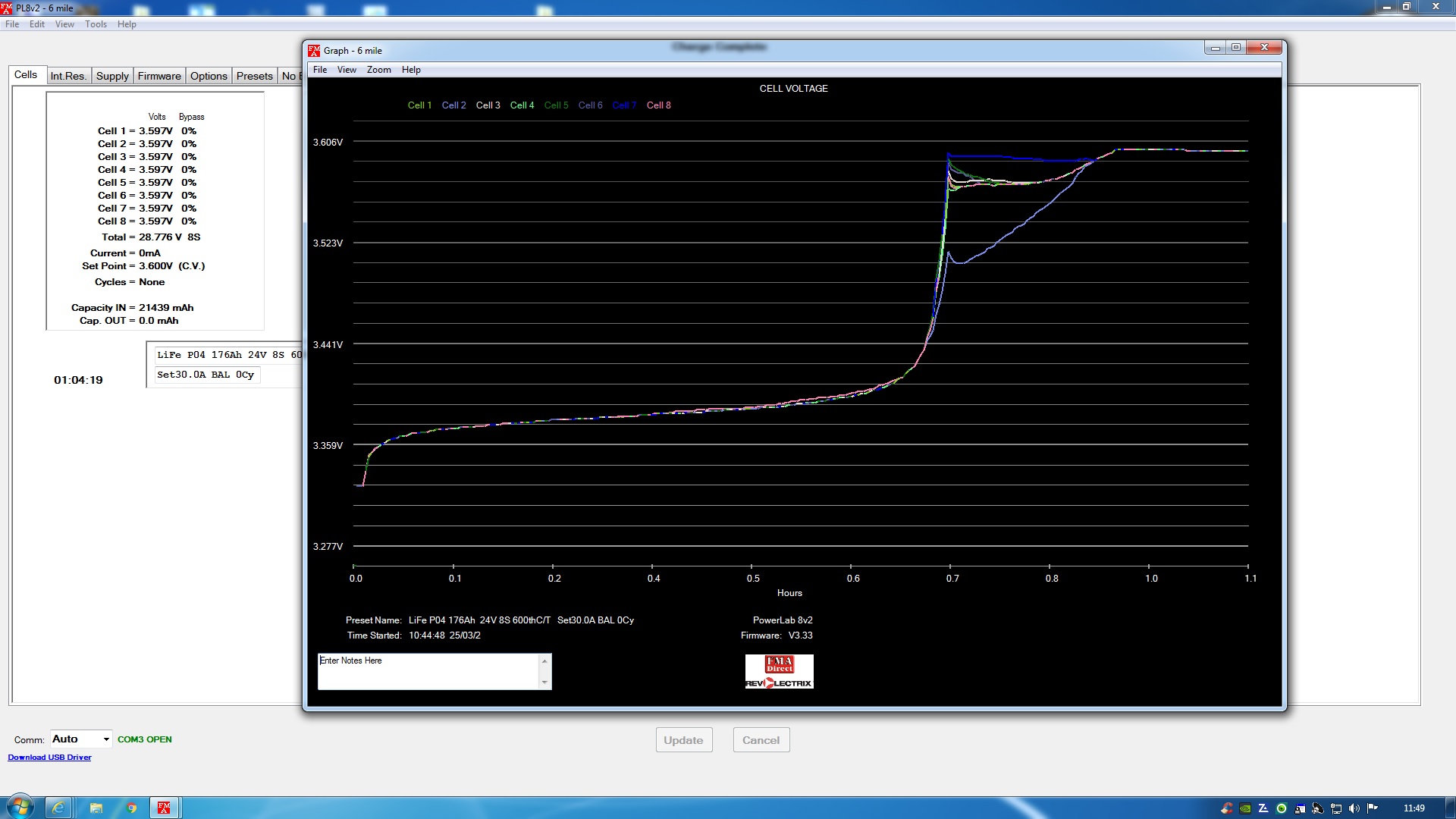

Postby terry2 » 25 Mar 2019, 12:51
Here is the graph
Postby Burgerman » 25 Mar 2019, 14:23
Well you used 21Ah. Out of 176?
Thats 176 div by 21 = 8.3. So you can go 8 times further than that.
So 8x your 6 mile spin and shopping is 48 miles. If you skip the shopping you can likely almost double that. But you should keep 10Ah in reserve. So call it 70 miles with 6mph running. You better take some packing up.
However, take a look at the inter cell connections when you can get chance. They should all stay relatively close together on that graph.

Postby terry2 » 25 Mar 2019, 14:30
Burgerman wrote:Well you used 21Ah. Out of 176?
However, take a look at the inter cell connections. They should all stay relatively close together on that graph.
That's fantastic news :D
I will look at cells 2 and 8 when I can get someone to life the chair up for me.
Thanks again BM.
