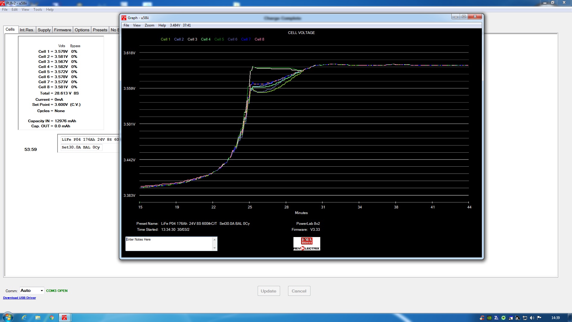

Postby terry2 » 26 Mar 2019, 20:01
@BM
If this discharge does not solve my problem.
Would discharging each cell to the bottom and then recharge them?
And if I do. Dies the profile you gave me stop discharging automatically?
Postby Burgerman » 26 Mar 2019, 20:28
No discharging will not change anything.
They balance at the top, when charged. Only above 3.5V.
Just use them and see what happens in a week or two.
Looks OK. The volts are not down! The charger charges each cell at exactly 6.000V to a couple of thousandths of a volt!
What yo see is the cells dropping to a lower voltage after charge ends. Which is normal.

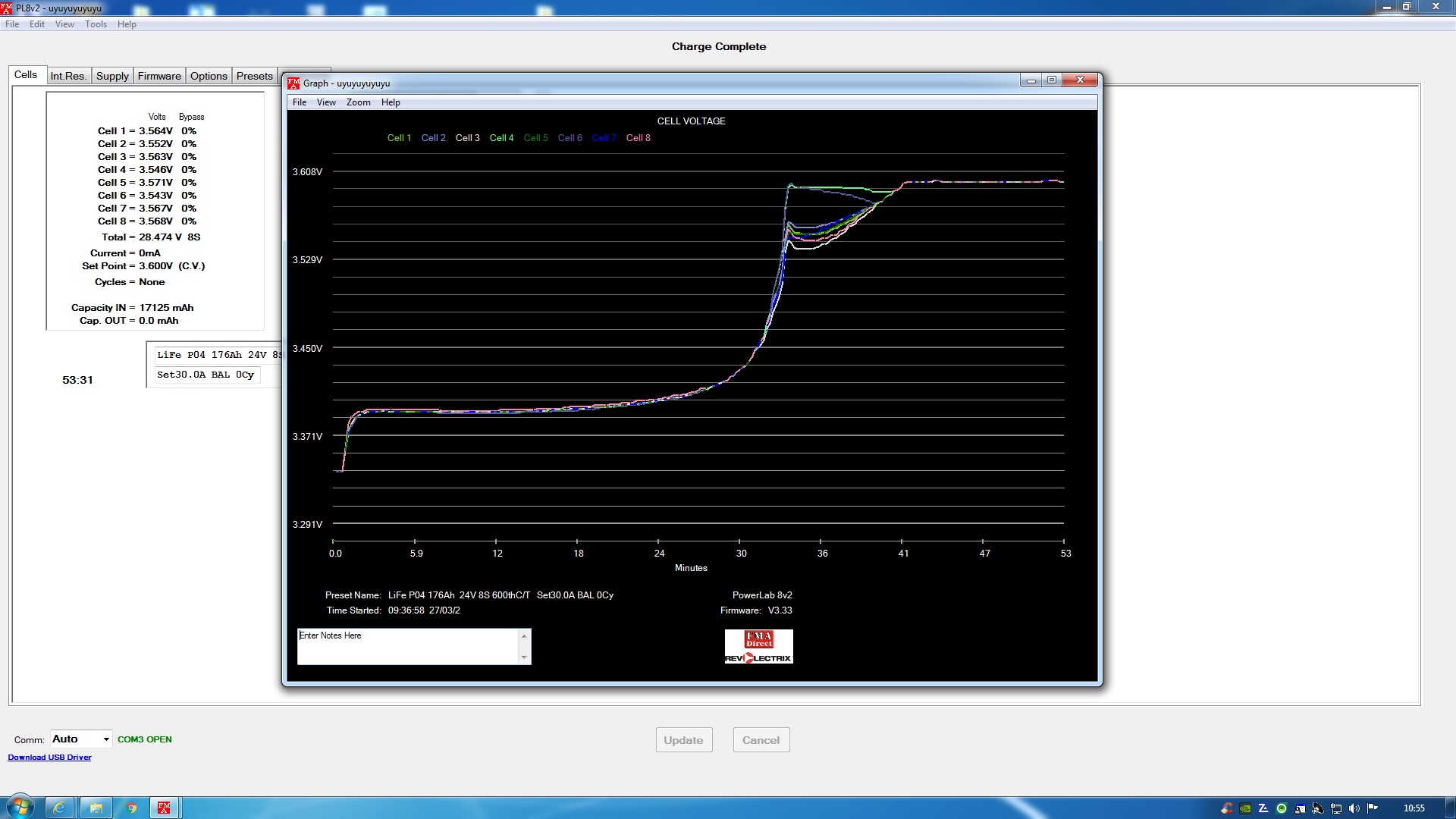

Postby terry2 » 27 Mar 2019, 12:00
Very early this morning I went out for a mad dash up and down the dual track by me.
I have just charged the pack. Now remember I replaced the connectors on cells 3-4 and 4-5 and 1-2
I also replaced the balance terminals. So what could cause this? Yes all was soldered.
Postby Burgerman » 27 Mar 2019, 12:38
You needed to check 345 and 567 as 4 and 6 were the issues ones.
If that doesent fix it its just how it is. Not all cells are identical. Did you use switch cleaner like de-oxit ion all plugs, connectors?
Its not a major issue, use it for a few weeks.
Posts: 71106

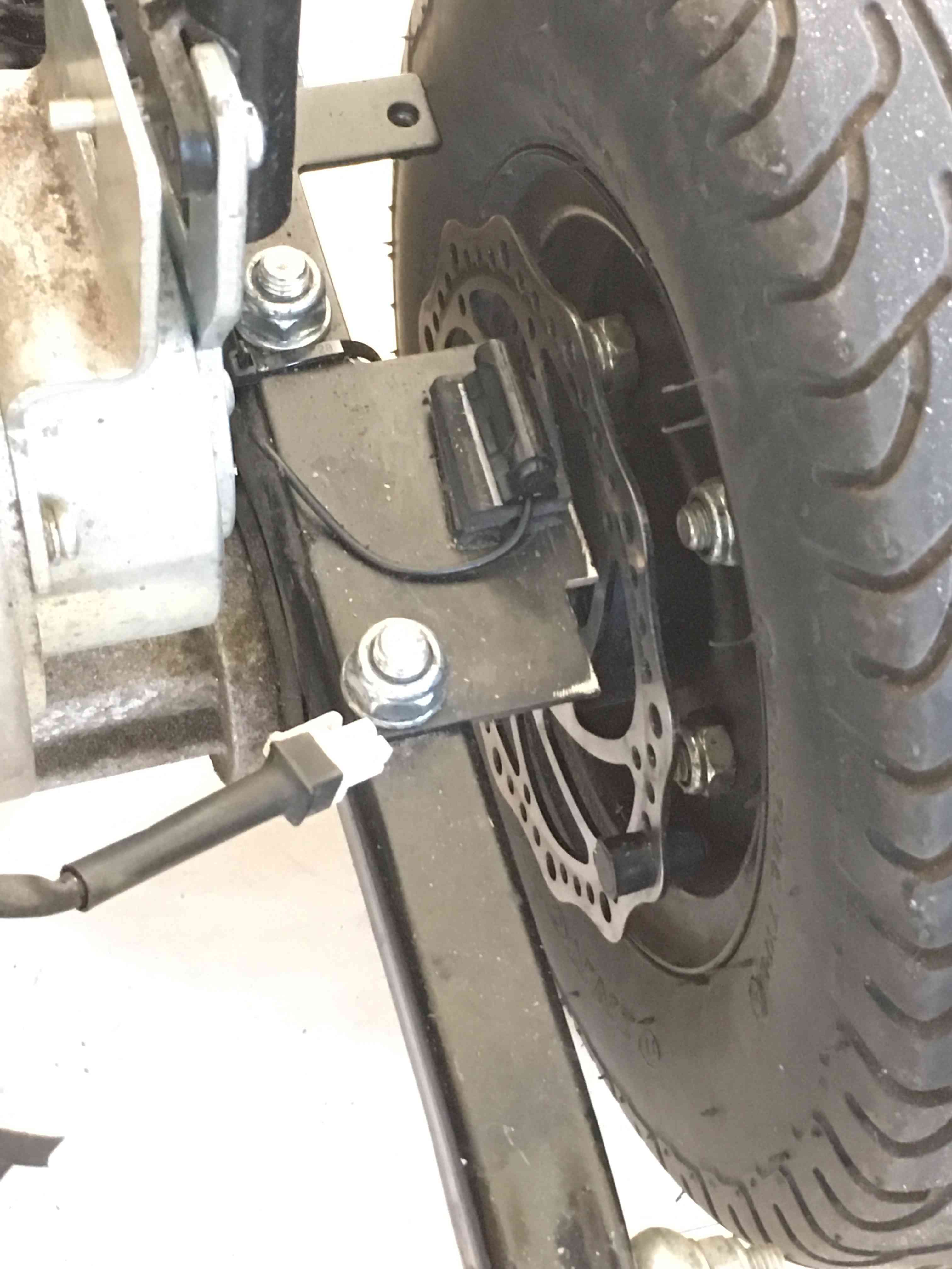

EDIT: I did away with the manual parking brake that I never used. The odometer is pretty accurate actually. The sensor is a reed switch and I counted 10 wheel revs, measured distance, divided by 10 and inputted wheel circumference in mm into dinky handle bar unit. It shows, distance, odometer, max speed, average speed, trip time, time. https://www.ebay.co.uk/itm/New-Bicycle- ... 0005.m1851

Postby terry2 » 30 Mar 2019, 15:45
Today I changed over cells.
I put the top 4 5\6\7\8 at the bottom, so they are now 4\3\2\0 and this is the graph
I did zoom in of the graph. Trying to work out what I am doing wrong?
I did use cleaner and contact cleaner ect.
