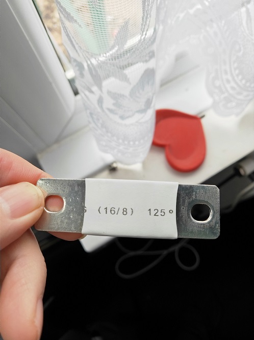

Postby terry2 » 08 Apr 2019, 10:55
Just had these come from the battery guy(I never asked or paid for them)
They are 2.2mm thick, but the middle is a bit bendable .
I have emailed him to see what he wants done with them.
Postby Burgerman » 08 Apr 2019, 11:28
Bin.
Posts: 70441
Postby terry2 » 08 Apr 2019, 11:31
Burgerman wrote:Bin.
:D
He may want me to send them back.
They are thin strips of copper plate. Solid at the ends and flexible in the middle.
Postby Burgerman » 08 Apr 2019, 16:55
How flexible? Like a cable?
Posts: 70441
