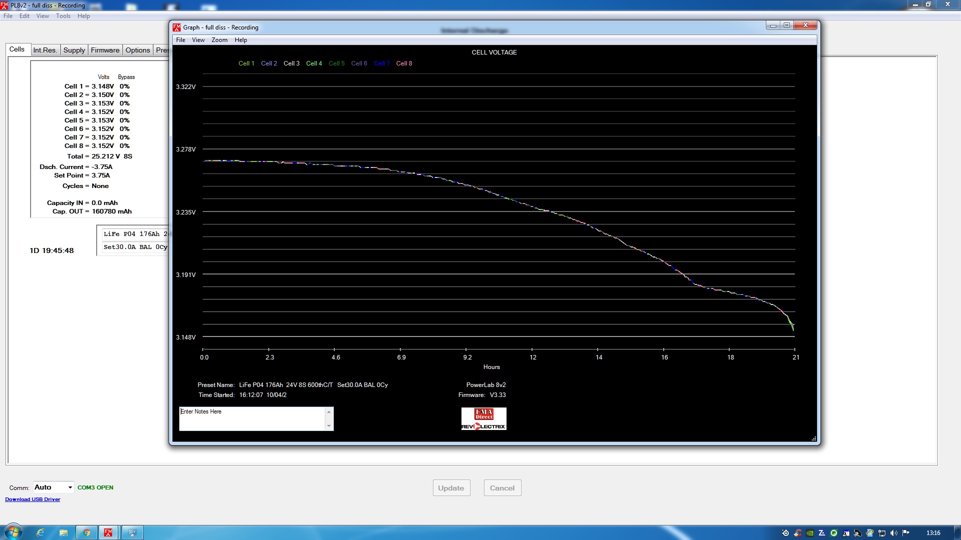

Postby terry2 » 11 Apr 2019, 11:13
Burgerman wrote:Keep posting voltage graphs and Ah.
For some reason the graph only started 19 hours ago.
Postby Burgerman » 11 Apr 2019, 11:16
Computer went to sleep? Or USB did. Or something. Keep going.
Postby terry2 » 11 Apr 2019, 13:18
Burgerman wrote:Computer went to sleep? Or USB did. Or something. Keep going.
Most likely. another graph. Not long to go now :)
Postby Scooterman » 11 Apr 2019, 13:30
It’ll finish any minute now Terry. See how steep the graph is dropping
Postby terry2 » 11 Apr 2019, 13:48
Scooterman wrote:It’ll finish any minute now Terry. See how steep the graph is dropping
Yep :)
The lowest cells is Cell one 3.108V
I wonder how many amps I will really get out of the stated 176Ah
Postby terry2 » 11 Apr 2019, 15:26
All done :D :clap:
Postby expresso » 11 Apr 2019, 16:09
very nice you got what i expected - which is great - alot of AH you have there 168ah - - our of 176ah spec. its pretty good - less than 10ah difference which i would consider great - its a pattern i been seeing with all these Cells - so far - 3 sets of Cells -- all showed the same very similar -
i would say what ever Cell you find - what ever Spec they rate it at - just remove 10ah and the Cells should give you no less than the rated spec minus 10ah - i would consider that very good - :thumbup: you should have nothing to worry about - if anything - then its the connections
how long did it take 2 days nights ?
Postby terry2 » 11 Apr 2019, 16:16
expresso wrote:very nice you got what i expected - which is great - alot of AH you have there 168ah - - our of 176ah spec. its pretty good - less than 10ah difference which i would consider great - its a pattern i been seeing with all these Cells - so far - 3 sets of Cells -- all showed the same very similar -
45 hours in total czy
Now I am going to recharge them up ready.
And you are right. These cells we are getting are awesome.
