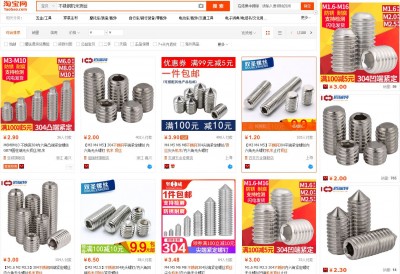

if space permits - would using the grub screws and locktite it down - with red instead of blue - then build ? doing this from the start - so it never gets stripped - this would be a problem if i had to do that procedure and for 16 cells - thats alot of work - one mistake and its ruined
Postby expresso » 12 Apr 2019, 18:44
https://smile.amazon.com/uxcell-Serrate ... 0X5XG&th=1
would these be any good along with grub screw and flat washer - little loctite on grub screw also ?
would seem very secure - if room permits

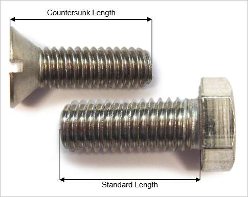

You measure the THREAD length. The part under the head. Where it says 'standard length'. Unless its a countersunk bolt.
Note, not related. The bolt look odd to me. Because it seems to have a left hand thread.

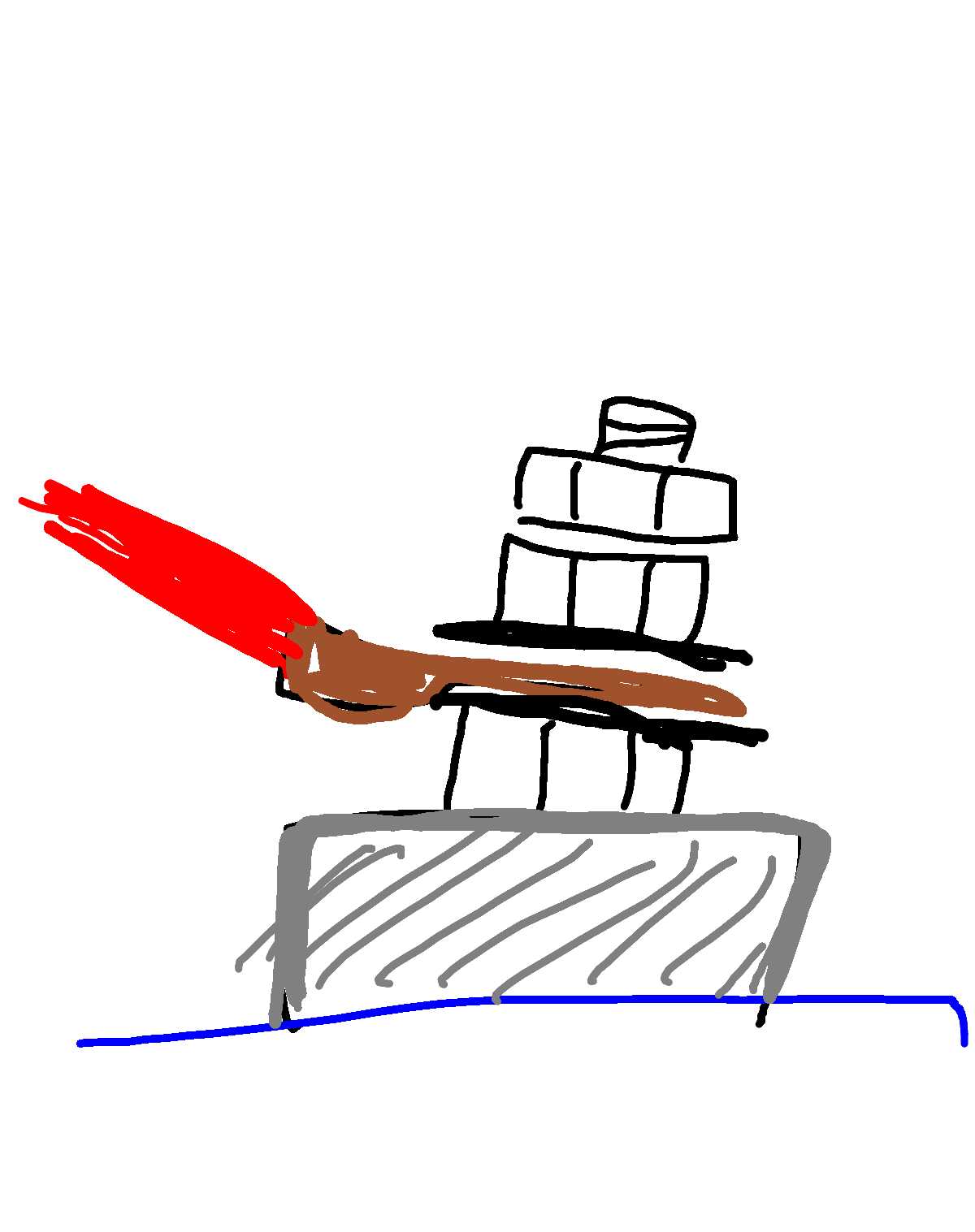

You can always do this if enough headroom. Stud, locknut, washer,lug, washer,nut, locknut. Locknut is just a phrase, doesn't need to be nyloc a normal nut locks down fine.
Just a suggestion.....
(Bottom locknut anchors stud into place)

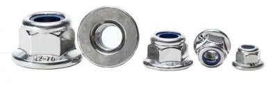

Instead of using 2 nuts
He can use the nylon topped nuts.

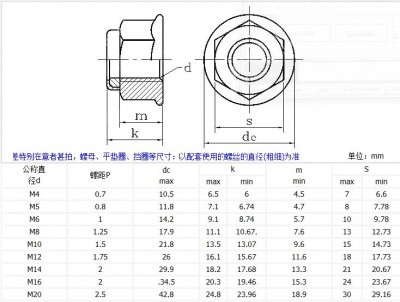

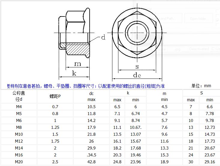

Stud with Loctite , and flange nut for better contact.
Found this flange locknut in one go.
