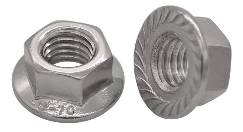

You can also get flange nuts with a serrated flange Shirley :thumbup:I

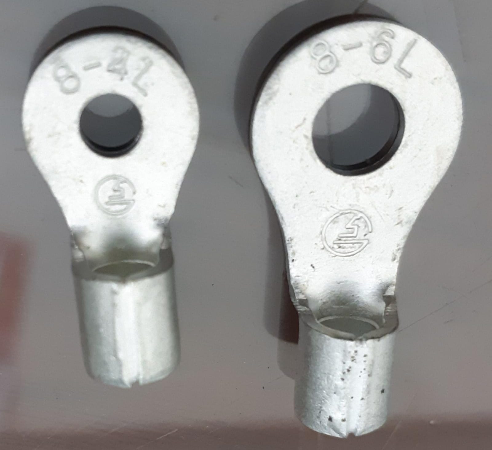

Ring terminals are ready .
OD : M6 is 14mm fits the cell terminal. M4 is 12mm, should not be too small.
Draws current from 2 cell terminals together, and hope they work

And NOT flange nuts! How many times. Nyloc and a stainless flat washer.

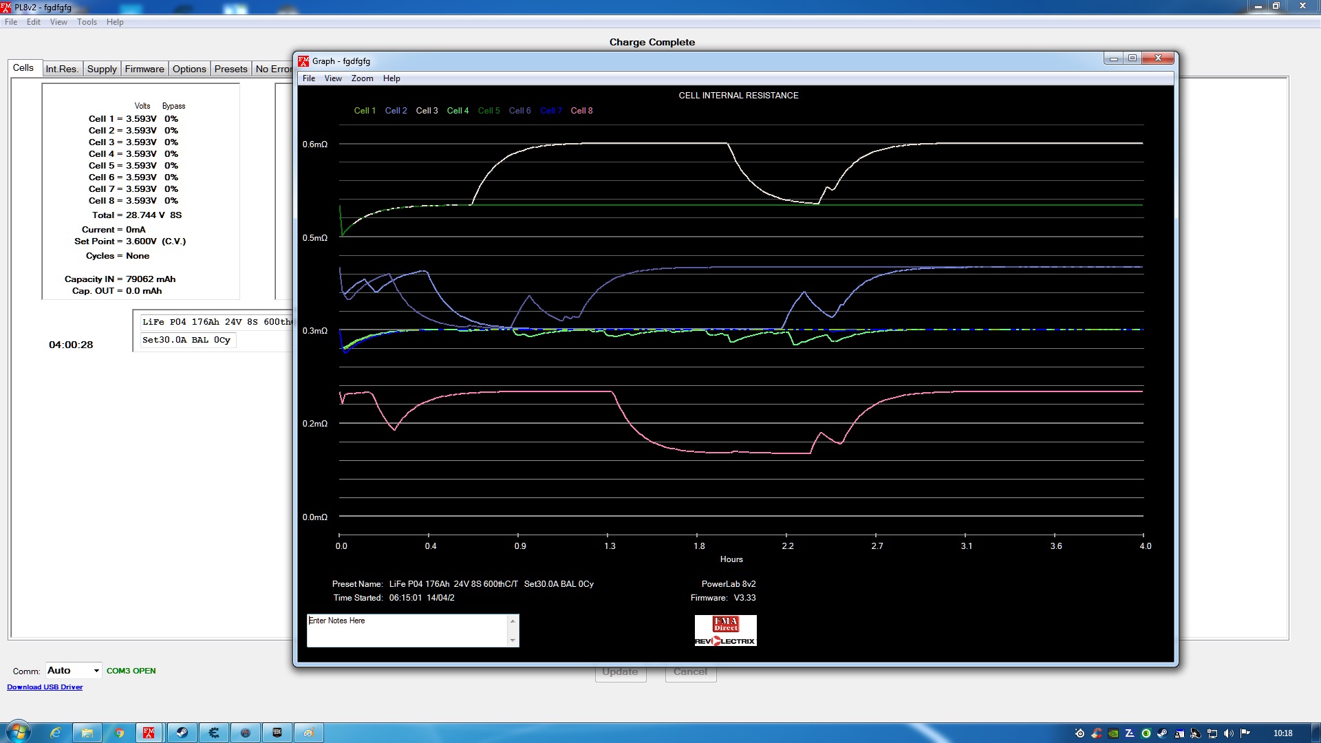

My latest graph from a charge today.
Funny this is I put in more AH than I took out :oops:
Postby Burgerman » 14 Apr 2019, 13:25
What you took out was very accurate.
What you put back is ALWAYS more than you take out. Usually with lead its around 30% more than what you take out. With lithium its usually much closer. Typically 3 to 4 % extra. Because charging wastes energy as heat, recombination of gasses, etc.

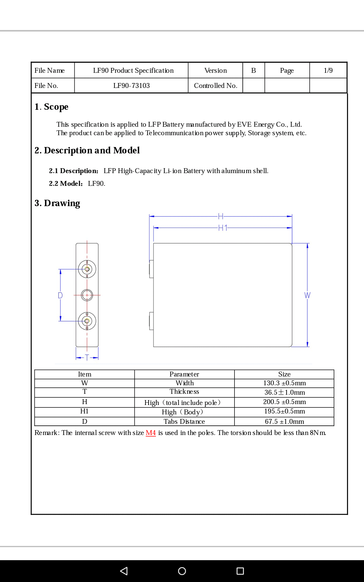

Says 4mm in spec but mine are 6mm. They must make cells in m4 and m6 unless they discontinued m6?
