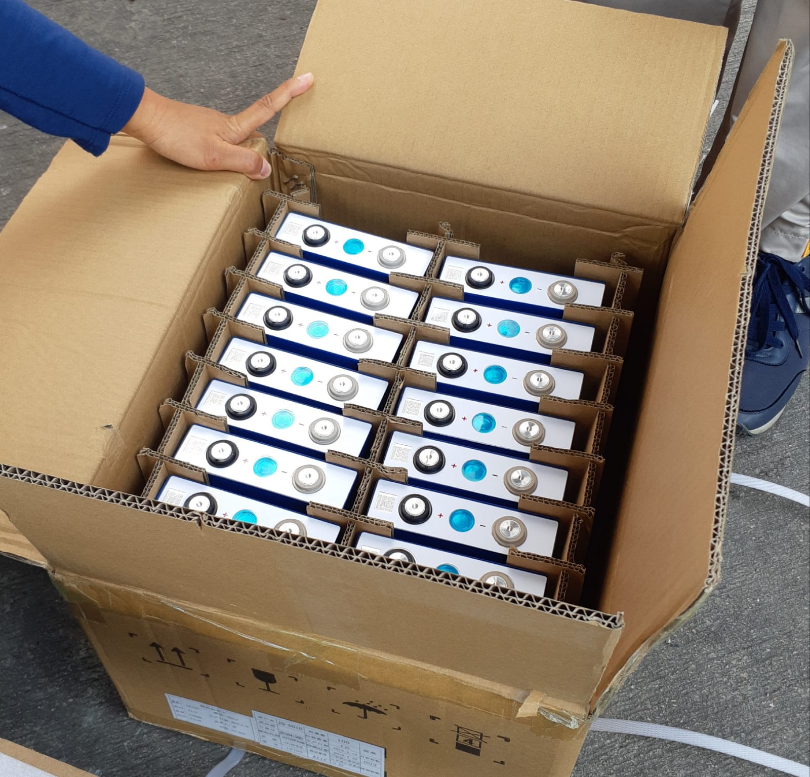

Postby shirley_hkg » 23 Apr 2019, 13:43
drunk2
Brand new from factory
@2019-04-19.
Posts: 4611
Postby shirley_hkg » 23 Apr 2019, 13:49
Will keep me busy for weeks . cheers .
Posts: 4611
Postby Burgerman » 23 Apr 2019, 13:53
Size and price for 16 delivered please!
210 Ah -- keeps getting better. :fencing

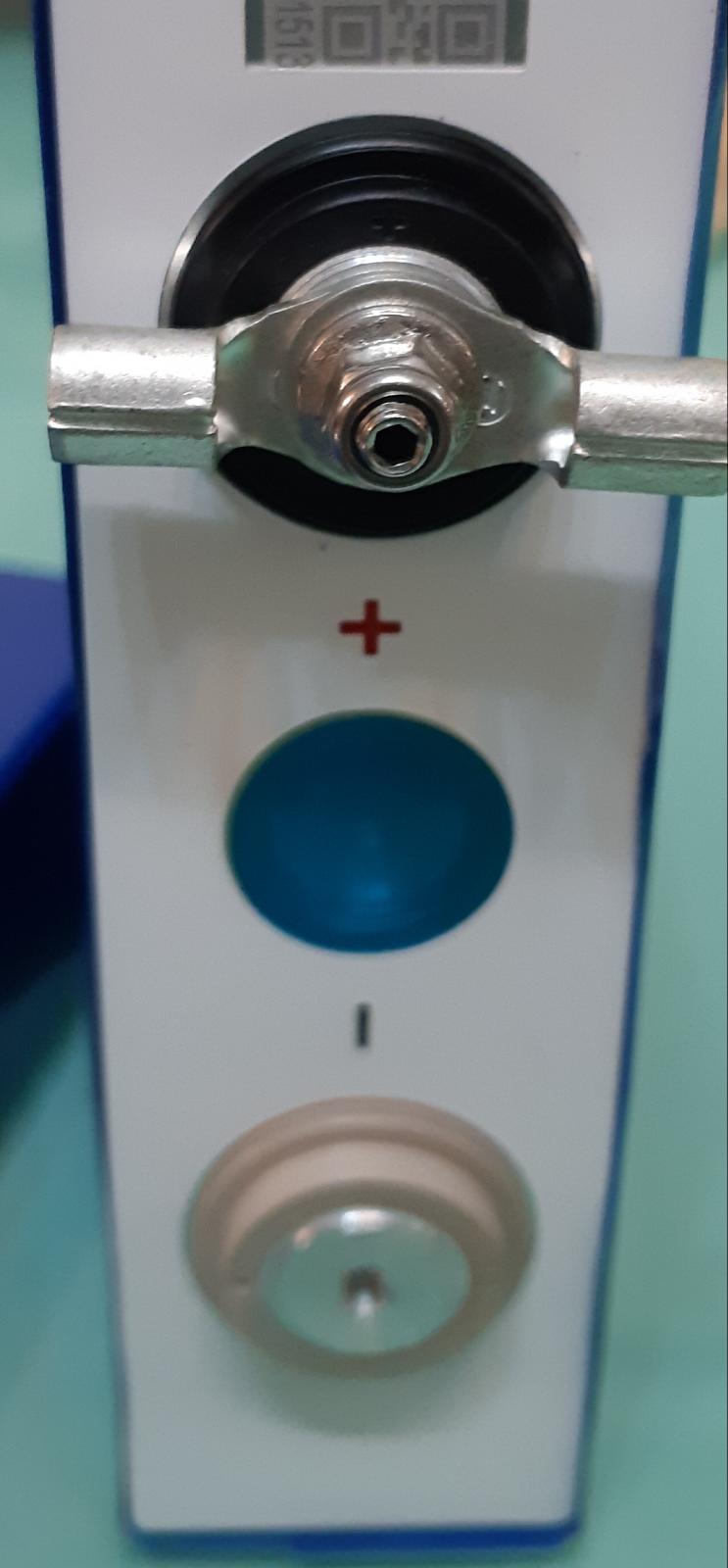

Postby Gnomatic » 23 Apr 2019, 16:19
Wow, that's awesome shirley! 105Ah per cell that is nuts! czy

Found it. http://www.dcmax.com.tw/LF105(3.2V105Ah).pdf
Specs are good.
