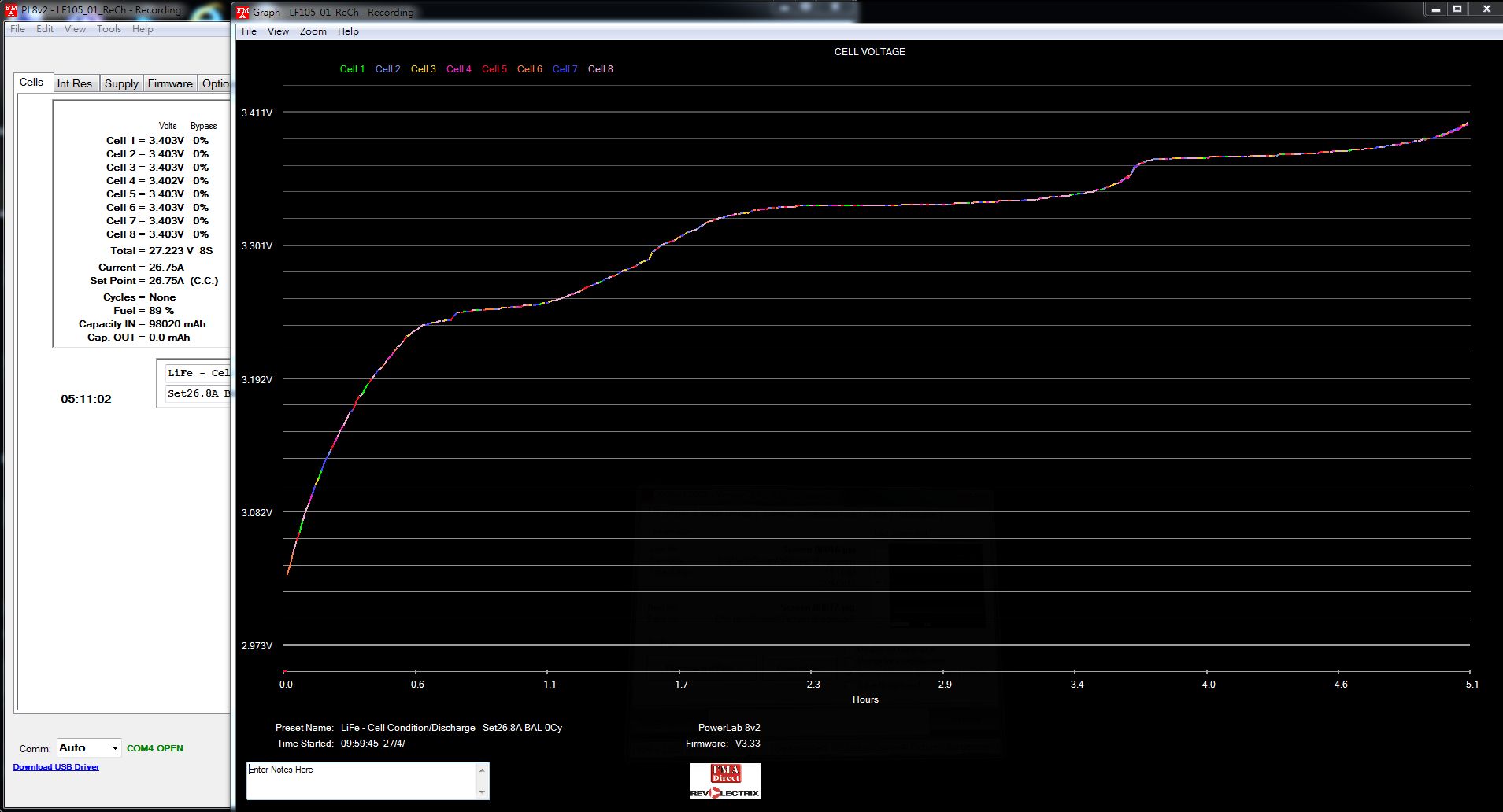

Postby shirley_hkg » 27 Apr 2019, 08:39
Recharging. Lines are solidly close so far, 98Ah back already. Will be full in minutes. cheers

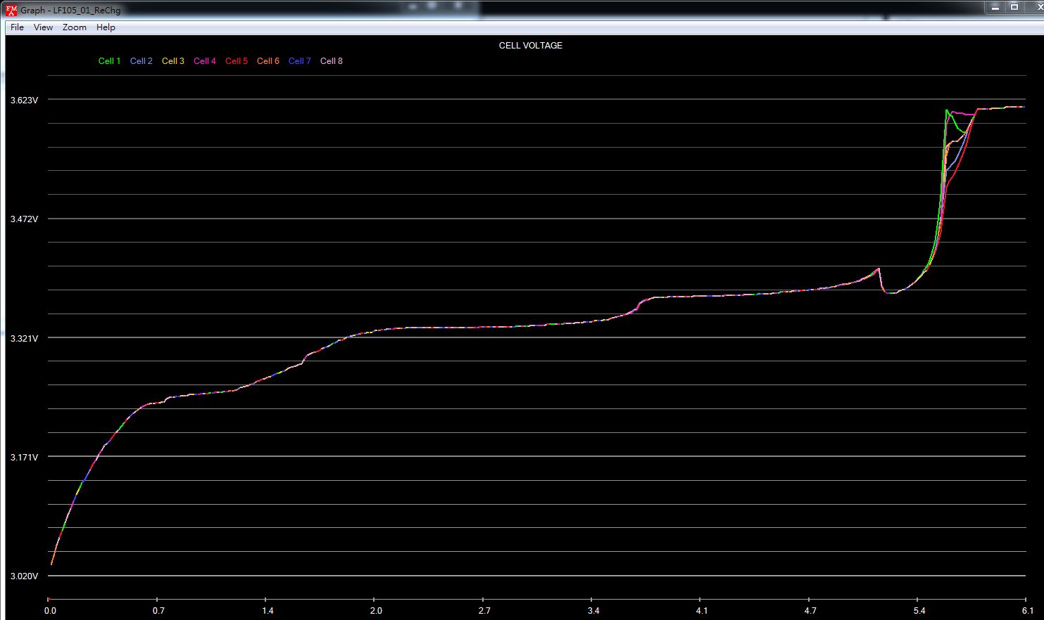

Postby shirley_hkg » 27 Apr 2019, 09:22
Put back less than 103Ah. :fencing drunk2
102.639 Ah.

Postby Burgerman » 27 Apr 2019, 12:58
bECAUSE SHORT cv TIME. dAMNED KEYBOARD! nEW ON ORDER.

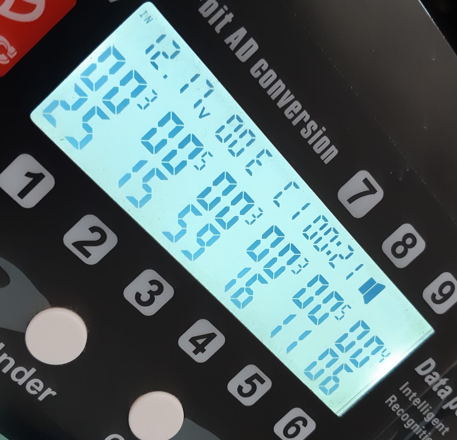

Postby Scooterman » 27 Apr 2019, 13:55
This is pretty good i reckon :thumbup:
71.7 accurate road miles + 14.3Ah manual discharge + 4Ah manual discharge.
Before recharging I thought I'd discharge to 3.15v, but after 14.3Ah decided to only go to 3.15v. So stopped discharge and reset to 3.15v and carry on but abandoned after an hour or so as I wanted to go to bed.
Recharged in the morning and put back 144.2Ah.
So by my figuring that's, 144Ah - (14Ah + 4Ah) = 126Ah / 71 miles = about 1.75Ah per mile :dance
So that's a long way, 'on warm desert highway with the wind in my hair', or something like that...

Postby shirley_hkg » 27 Apr 2019, 14:37
Recharge graph looks solid as a rock . :clap: cheers

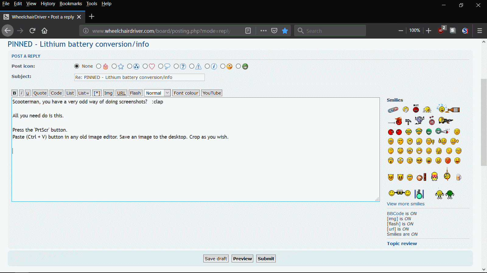

Scooterman, you have a very odd way of doing screenshots? :clap
All you need do is this.
Press the 'PrtScr' button.
Paste (Ctrl + V) button in any old image editor. Save an image to the desktop. If its graphics, save as a .GIF preferably as it looks sharper. Crop as you wish.
Then upload here with your post.

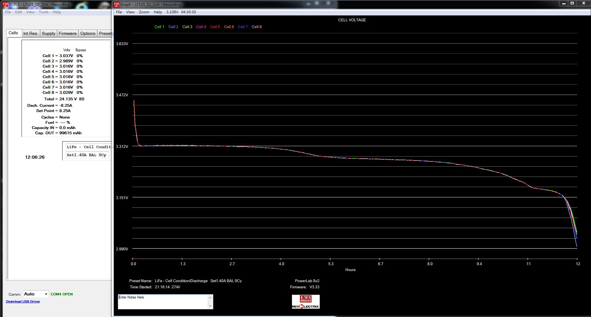

Postby shirley_hkg » 28 Apr 2019, 14:14
Second half of a 2P8S pack. Cell #2 is the weakest . Bucket effect allows only 99.615 Ah only.
Draied all cell to their 3.00V , to record their actual capacities.
Cell #1. 99615 + 1350 = 100965
Cell #2. 99615 + 0457 = 100072
Cell #3. 99615 + 0860 = 100475
Cell #4. 99615 + 0965 = 100580
Cell #5. 99615 + 0794 = 100409
Cell #6. 99615 + 0765 = 100380
Cell #7. 99615 + 0742 = 100357
Cell #8. 99615 + 1168 = 100783
Two halves are close actually,except that cell #2 .
