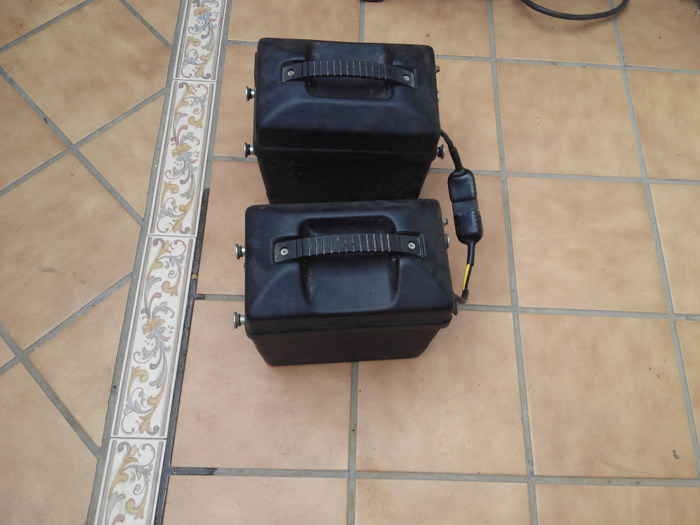

Postby martin007 » 08 May 2019, 00:11
Boxes...

Postby Burgerman » 09 May 2019, 01:17
If both are 24V boxes, and both connect via andersons, then it will run on one or two boxes, and no connection issues with those. The charge cables will be sub D connectors, one on each box.

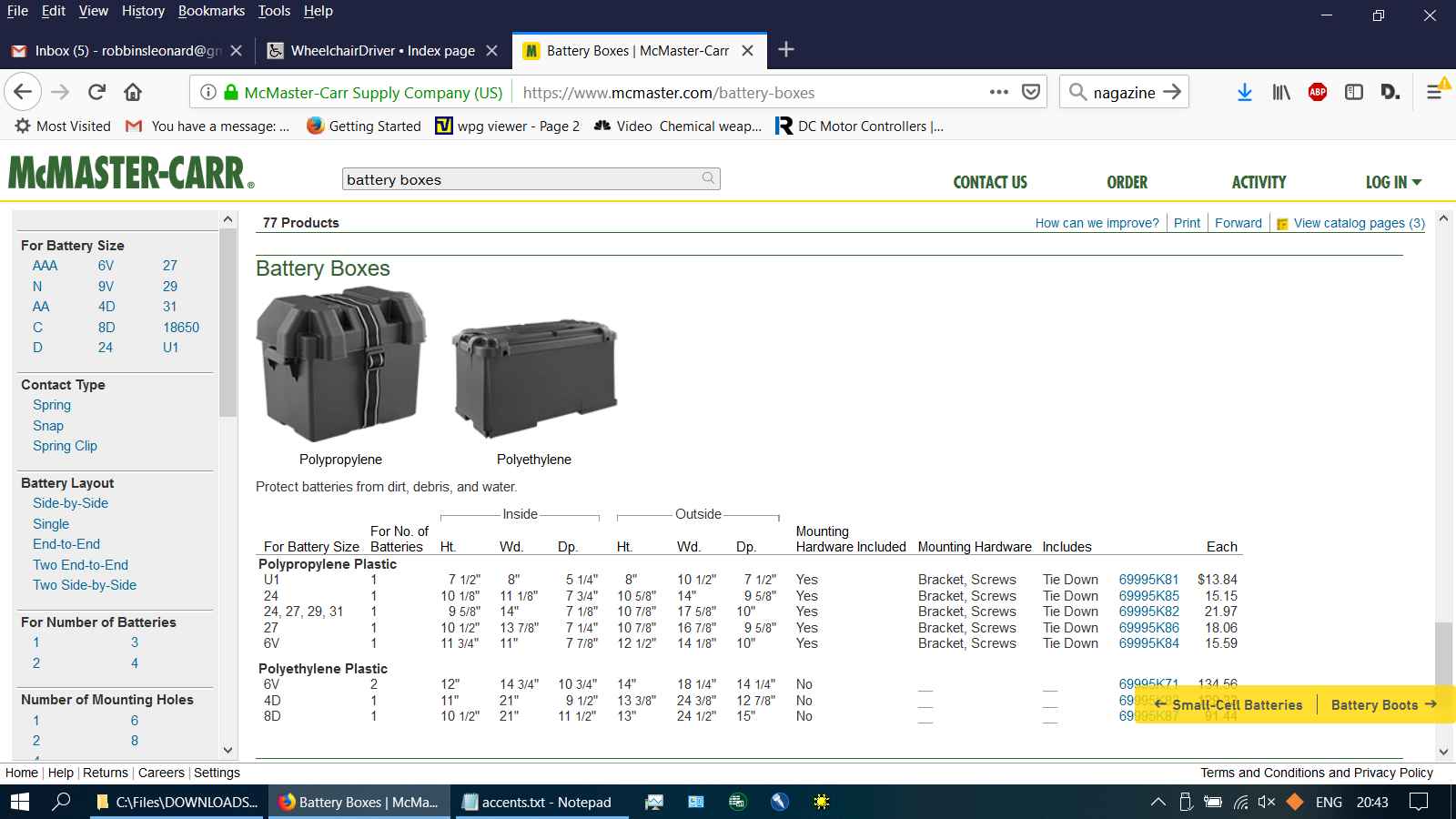

Postby LROBBINS » 10 May 2019, 19:48
Yes, they are used elsewhere and in English they're called "battery boxes". Here's what McMaster-Carr stocks:

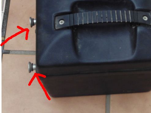

Re: Make Lifepo4 cell box
Postby martin007 » 10 May 2019, 19:58
And what's this technically called?
Posts: 4105
Postby Burgerman » 11 May 2019, 01:14
I doubt anyone knows. You could create that from bolt/spacer/washer. Theres hundreds of different types of bolts and fixings.

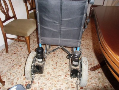

Postby martin007 » 14 May 2019, 21:46
It may be worth looking at the chair design to see if it would be possible to fit a larger box or set of boxes...
The space available is very small and fair. banghead banghead

Postby Irving » 07 May 2020, 11:20
Would be good to have pics of boxes in chair to get feel of layout. Personally I'd ditch boxes, make new 4S packs out of largest cells in space available and fabricate simple U-shaped hangers to match the fixing points - maybe just webbing straps would suffice since LiFe packs are much lighter...
