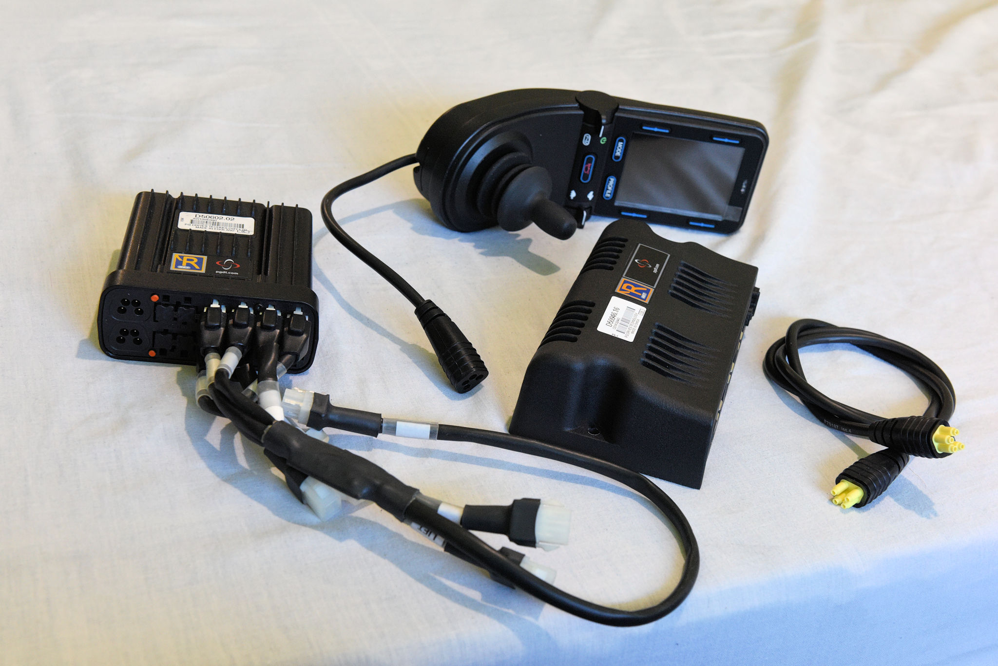

I am converting all my old Pilot Plus chairs to R-Net.
And any future chairs.
Right now the R-Net system is the best. Its the most developed, easy to get parts, and relatively easy to get programmers to OEM level.
With by far the best and most complete configuration settings and flexibility.
So since I seem to need tilt at very least to prevent sores, and preferably recline too. Well you may as well go the whole hog, and have power footrests and a lift too. In for a pound as they say.
Thats was the reason for buying my salsa powerchair complete, and adapting it a little so it works properly!!!
See: viewtopic.php?f=2&t=7455&start=600#p122818
Be sure to read the first post before looking at the pretty pictures as the devil is always in the details.
It NOW works well, and is nothing like my usual short, sharp, light chairs.
Back to R-net. They introduced a new joystick with bright clear large graphics. Its got a metal case/chassis. Its big, which annoys but if you are going to have a lot of seating options, then its a royal pain figuring out whats going on without a screen you can see clearly outdoors.
So I bought a spare one one these new for £125 : (EDIT, now have 3!)
I then bought a R-Net 120 Power Module (NOT the 60, 80, 90A ones) on eBay US site for £53 :clap (EDIT Now have 3 of these)
I then bought a full house Seating and lighting module in the UK for an even sillier price. I wont say how much because it will make a dealer cry. (EDIT, also now have two)
These are available in 2, 4, 6, and apparently 8 channels, + lights. (never saw an 8 channel version). This does 6. Its labled ISM-6. So lighting, and every seating option reqiuired. MOST are ism-6. Some are less, if theres only say tilt and recline.
Complete with a loom and connections for Lift, Tilt, Recline, L-Footrest, R-footrest so I can fit a salsa style seating lift / recline module to my BM1 chair. At least thats what I think I will do with it.
Full R-Net top of range kit, best of everything for £268 delivered. Amazing really. All 3 expensive bits that someone like permobil would sell for literally many thousands. In fact some of it IS permobil... Like this seating lighting module inc wires. At least I think it is. May be Sunrise.
Now need motor, battery connectors, and 2 bus cables. Which should be soon. Who says hi end gear to build a mega chair has to be expensive? And of course I already have an OEM programmer. (EDIT now have a bunch as they appeared on eBay etc)
So this is EVERYTHING needed for a chair with every possible seating option, best highest power 120A controller, and highest quality BRIGHT CLEAR METAL joystick. Everything powered covered! This is the most expensive system you can get on a powerchair.
EVERTHING! And cheap.

I have 2 120A R-Net PMs, both off Permobil chairs. Guess I should swap my 100A Pilot+ soon. :geek:
Re: R-net
Postby Gnomatic » 07 May 2019, 22:22
I could have got that joystick for the chair I just got, but declined to get it. Too big and bulky and not easy for my club hands to use. I went with this one.
My new chair has power tilt/recline/elevate/legs/lights/retractable docking pin. So six power options. The part of the chair lights up on the joystick to the corresponding mode. But most importantly the joystick fits in my hand much better and the buttons are much easier (for me) to operate than the big LCD R-net joysticks.
Of course this will very user by user.

The ism-6 will do six actuators and lights/indicators/horn.
