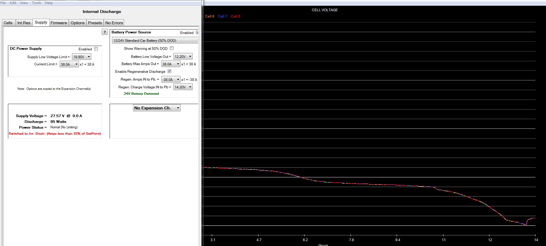

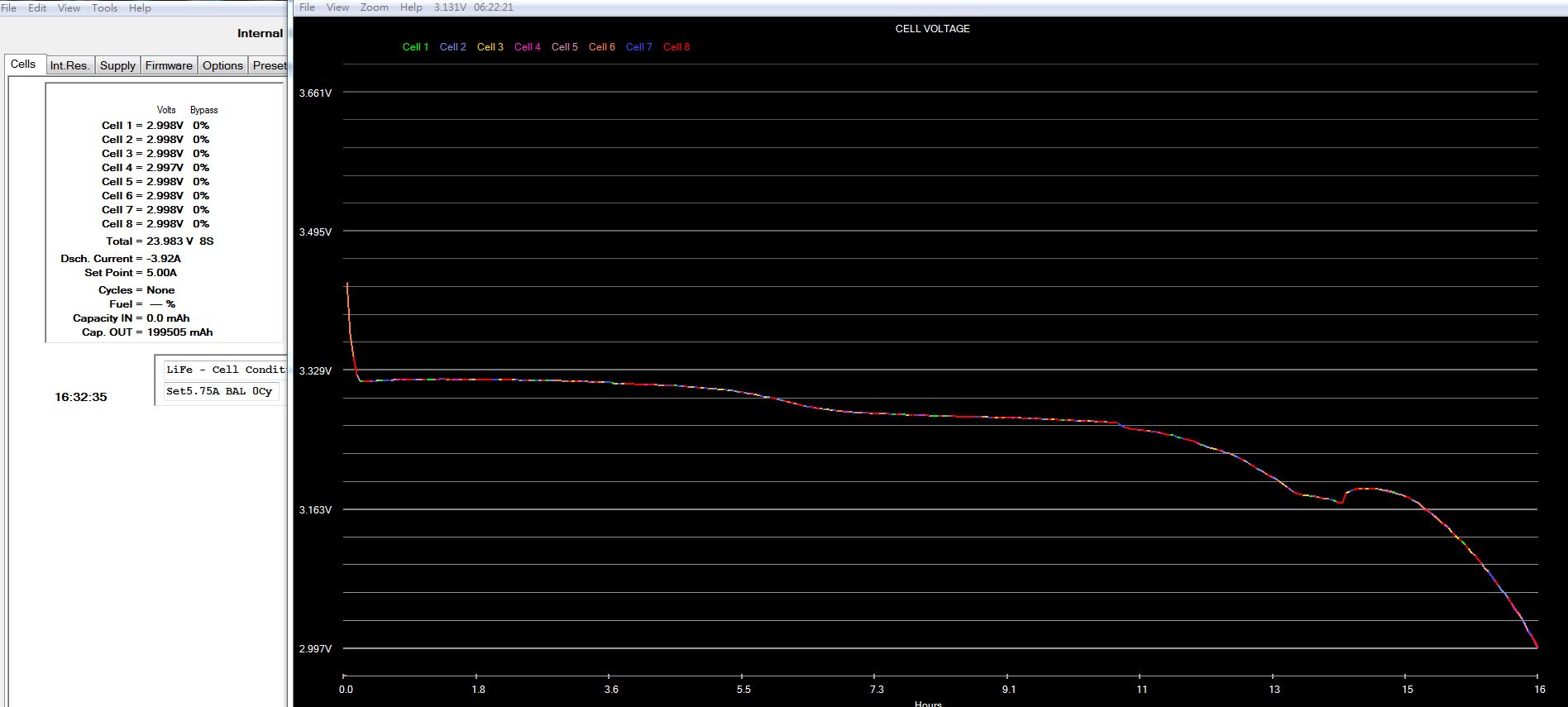

Postby shirley_hkg » 08 Jun 2019, 10:01
Did a quick match of 16 cells to form my 2P8S @EVE-LF105 pack , and perform a 200Ah discharge.
Voltages of the 8 groups stayed closely packed :dance , till the last Ah.
Will be a pretty balanced pack , down to 24V.
Chair's battery ran out of storage. PL8 switched to its internal discharge mode, AUTOMATICALLY. cheers drunk2

Postby shirley_hkg » 08 Jun 2019, 10:19
Only 1 mV , while discharged to the last 0.1 . . . . amphere hour. goodpost
