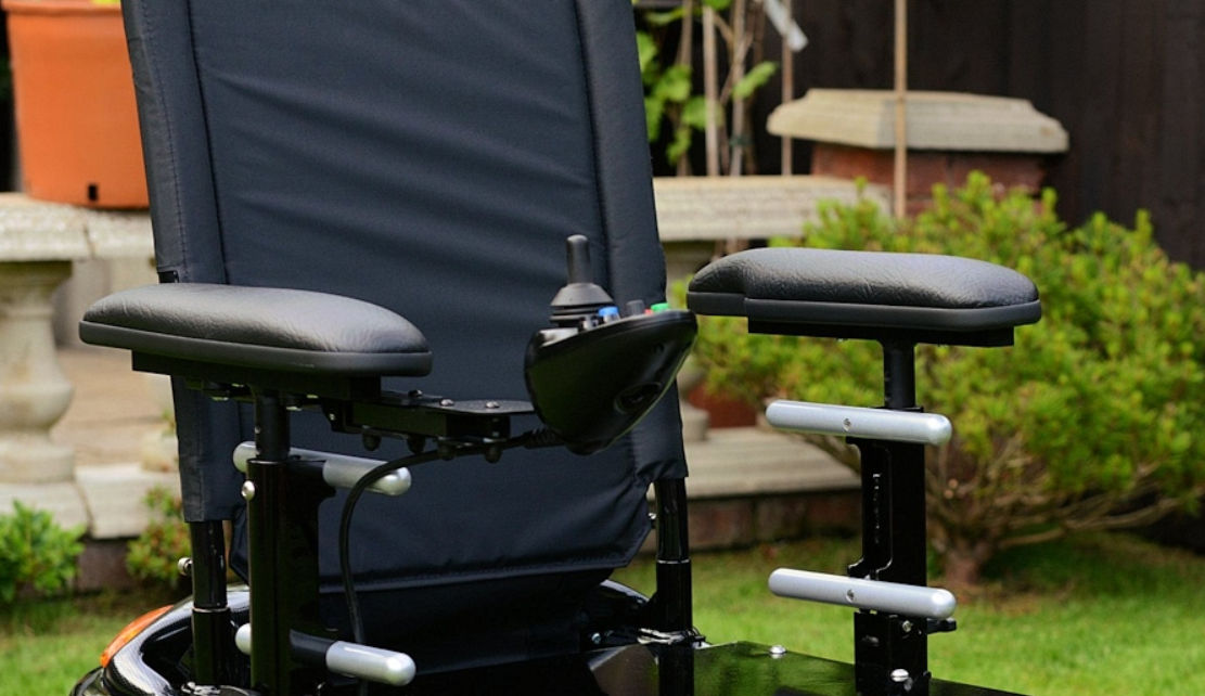

IMAGES -- Which means that this way of controlling a joystick wont ever work properly. Definitely will never allow you to control a chair properly, and certainly will not allow you to program a chair for instant linear proportional easy control. And is what I see on the vast majority of chairs.

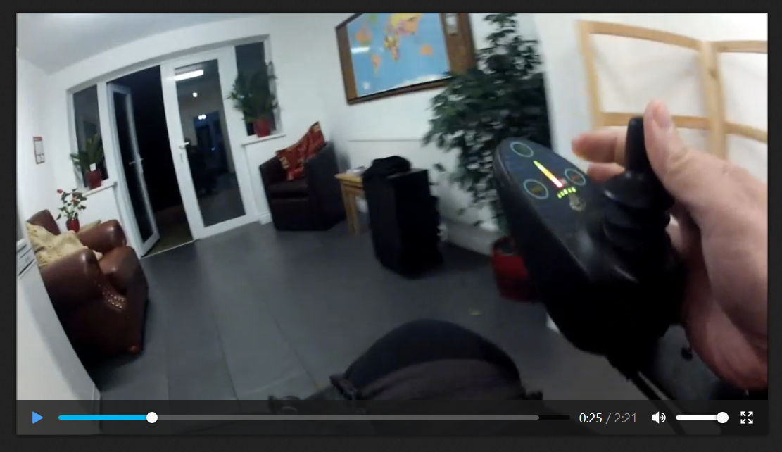

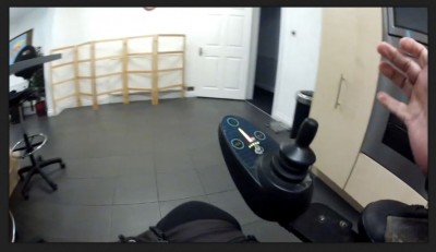

Postby Burgerman » 29 Jun 2019, 01:24
This is in the correct position for most humans natural wrist position in regards being positioned to the LEFT.
But its a fraction too low, and is too close to the arm.
There must be a gap, around 2 to 3 inches, between arm top and joystick.
Remember that you should be holding the joystick pods right side. Like a gun. Like a handshake. With your thumb on top.
Forget the joystick for a minute. Hold your hand out. its natural resting position is like a handshake. Notice that it also curls in towards the middle. This is where your joystick should be when your arm is on the armrest.
Your hand should not be flat like you have it on a worktop. Or a piano.
And with the arm top so close to the joystick as in this picture, the lower part of your hand(shake) cannot reach the pod. Its too close, and its still slightly too low. Remember that you are SHAKING HANDS with the pod, with thumb, and one finger on the joystick lever. In this slightly inboard position.
Now watch my HAND...
WWW.WHEELCHAIRDRIVER.COM/gopro/control.mp4

Postby expresso » 29 Jun 2019, 01:25
yes i agree - those pictures are not good - and its not like mines at all or how i hold mines :lol:
Re: Rnet Settings issue - Volts etc
Postby Burgerman » 29 Jun 2019, 01:27
No, but its how MOST chairs are. P.S. I added a lot more after you replied.

Postby Burgerman » 29 Jun 2019, 01:52
In order to have real control (and be able to program your chair to go where you tell it and have absolute control and confidence to wheely through doorways or just drive in comfort) you MUST hold the side of the joystick pod for reference and stability. Its a HANDSHAKE with the pod. In whetever pod position YOU need for comfort.
See below. There MUST be a gap big enough for your hand to get in and cup the pod. Sideways! A handshake. Your hand must be vertical. Not flat!
The gap... REQUIRED!!!
The REQUIRED gap!!! Use a short ARM TOP, do not move the pod further away!!!
The gap in use!!! + This is to show that the pod is more INBOARD by around 2 inches than the ARM CENTRE LINE. It is enough that your hand will never touch a doorframe. When the ARM top will. Or your arm may. This is where your hand will naturally form unless you are a mutant.
Inboard Position. Slightly high. GAP!!!
This is how it looks in use. Here while wheelieing. No amount of crashing up, down, or bumps in the street will caise ANY unwanted input or stick movement. And its completely comfortable for hours on end as its the natural position your hand prefers to be in when relaxed.
During use. WATCH THE MOVIE, WATCH THE HAND.
WATCH THIS MOVIE, ignore the chair, look at the HAND only!!! Coplete stability, comfort, and no unintended inputs allow wild programming to be absolutely natural and easy and accurate. http://www.wheelchairdriver.com/gopro/control.mp4
Posts: 71100
