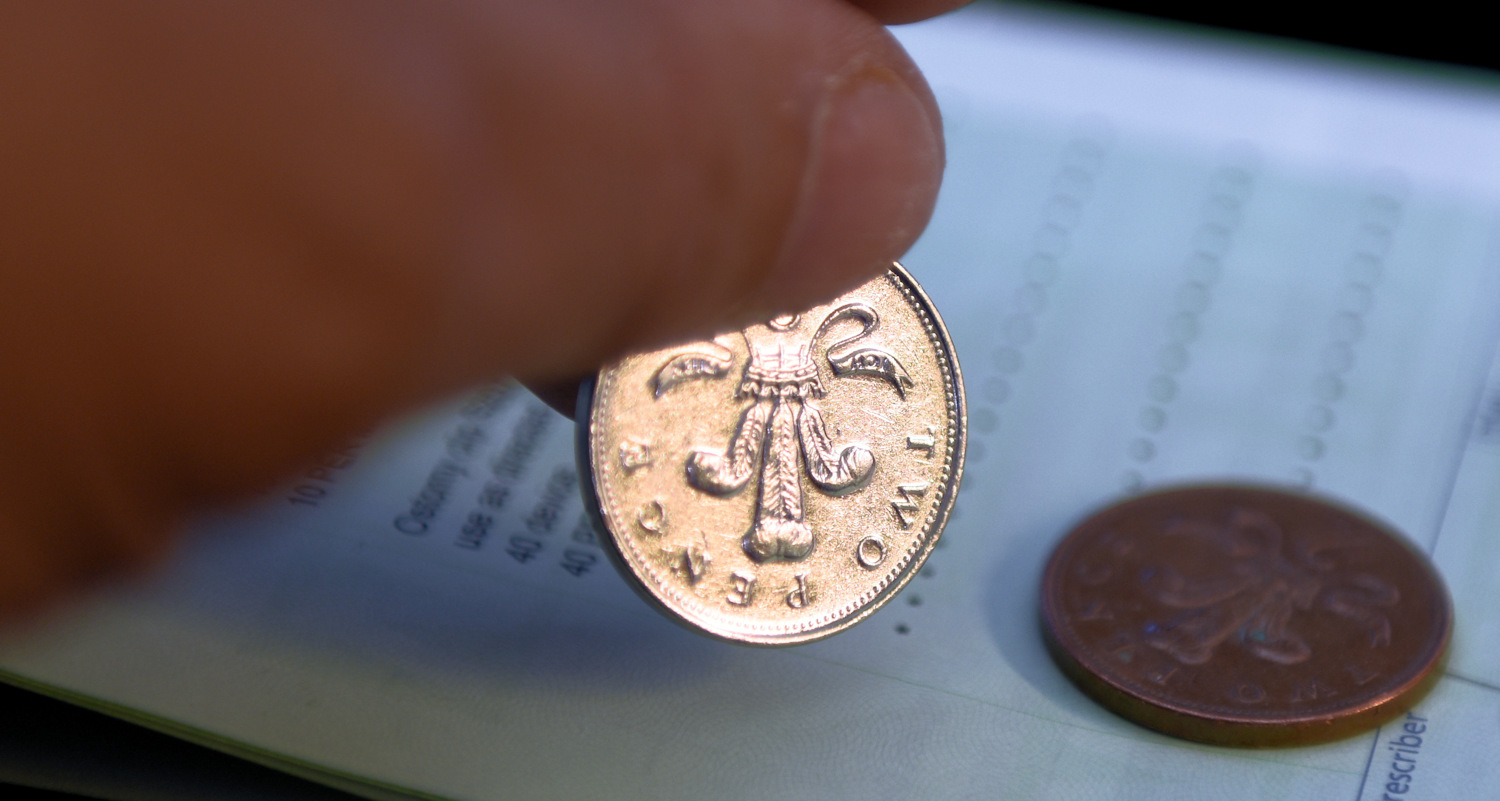

Heres 1 example.
Heres my attempt at nickel plating. My first attempt and TOTAL settings guess! :fencing
2.7V actually 3.0v but limited by the Amps set to 0.3A. Turns out this is too high, it plated in seconds.
I tried plating a coin and ignoring all the acid bath cleaners, and distilled deionised water baths etc.
I simply cleaned it with washing up soap, as used for dishes, with scotchgbright cloth. For all of 15 secs...
Then straight in the plating bath, after a rinse under the tap. And no gloves, handled by fingers etc. Everything wrong!
So power on for 30 seconds, and at 30C (too cold by all accounts, needs to be 50C? But I have no patience!).
Its super shiny, and totally covered, and its so easy. I dont know what the fuss is about.
Now all my money will be worth more and shinier than other normal peoples money... :clap :admirer
FIRST EVER ATTEMPT, 1 WEEK BACK.
Nickel plated copper coin.
Postby Burgerman » 04 Jul 2019, 21:02
Obviously, the plating is not intended for my money! That was a test. But to nickel plate any copper, brass or steel parts. So that they have a shiny chrome like plating that prevents oxydation and looks pretty. Every washer, bolt and nut, or part for hobby stuff. For instance I have a new chinese hit and miss engine on the way. The brass parts will go brown and oxydise. The steel crankshaft will rust. So I will bright nickel plate all those parts.
Theres many coatings.
You can cote in copper easily. But it goes blue and is soon covered in a mass of blue powder. Copper oxide..
You can cote in zinc or a zinc yellow passivate. But it soon goes black and dull.
You can coat in silver or gold. But its soft, and wears off easily. And its $$$$$$$ to do.
You can cote in cadnium. But its not bright, and it dulls fast.
You can cote in chrome. Many chemicals, and its all harmful acids and many baths. And its not easy to do at home.
OR you can plate it in NICKEL which stays silver/grey and looks similar to chrome but is less blue.
You can also do BRIGHT NICKEL by adding a few extra chemicals that make it look very shiny, or by buying the whole green electrolyte in a bottle ready to use. Its harder wearing than zinc, etc and is good for electrical parts and so on. The other advantage is that its stupidly easy!
