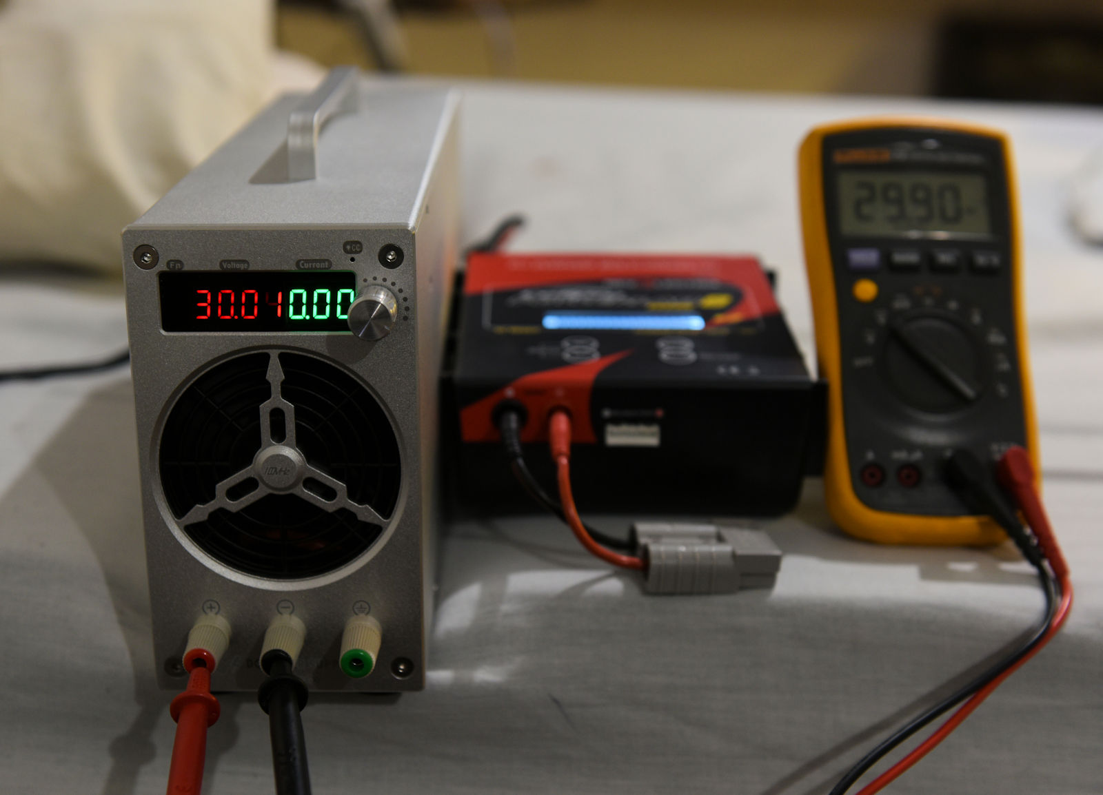

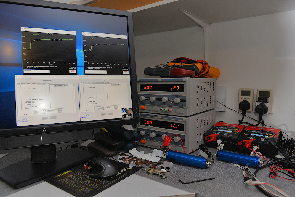

Postby Burgerman » 24 Jul 2019, 08:33
There is.

Postby Scooterman » 24 Jul 2019, 11:22
BM - has your VDU got a Matt display?

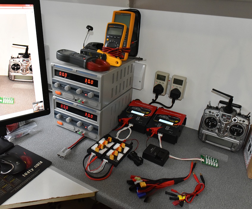

Postby Burgerman » 24 Jul 2019, 11:39
Not the multi meter. The power supplies. Both are good, need no checking. The problems arise when people use converted computer supplies, cheap chinese things etc. Then you need to be careful.

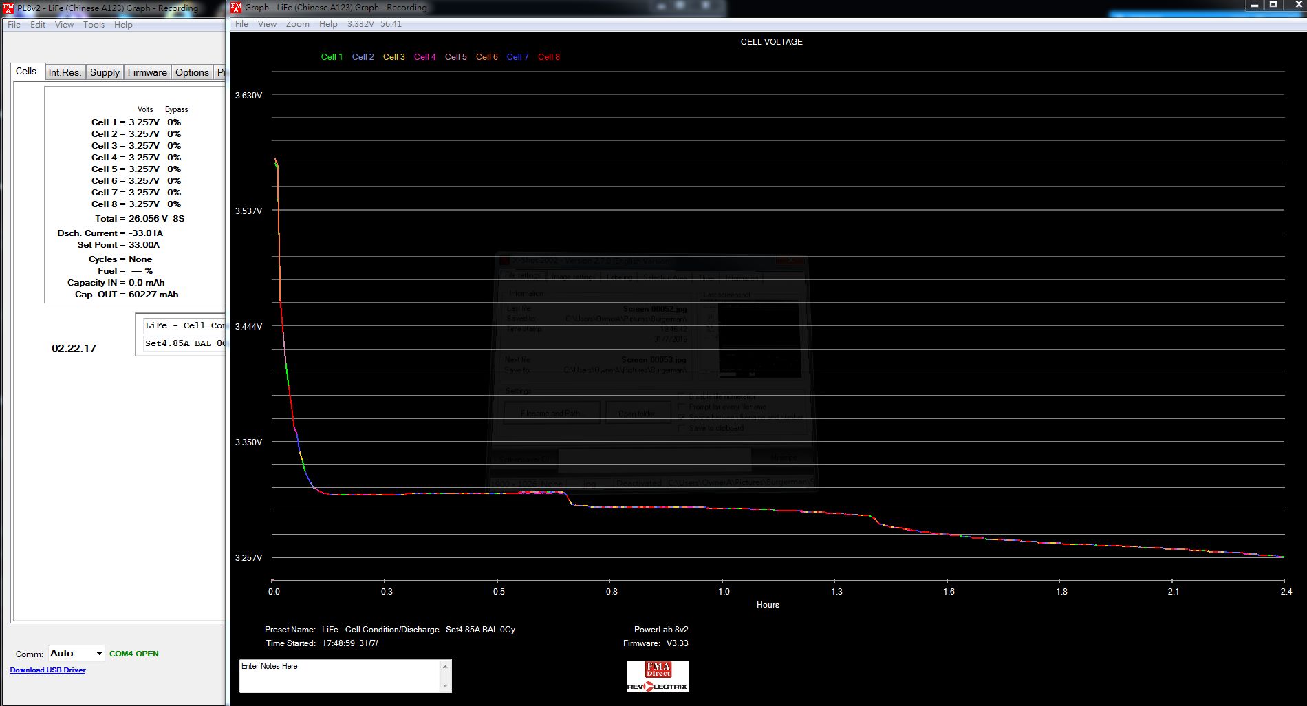

Postby shirley_hkg » 31 Jul 2019, 13:12
Testing to discharge @0.3C , ie 33A , to see if more Ah could be recored , compared to 15A that I used to do. Cells get warm up a bit now. :fencing
:ak47 Risking my PL8 to me, hope it will survive. :worship
Postby Burgerman » 31 Jul 2019, 13:48
Well it might well give more. Warm cells are better. But voltage sag is higher. So... will be close. I would set 2.5V end at higher current.
Posts: 70446

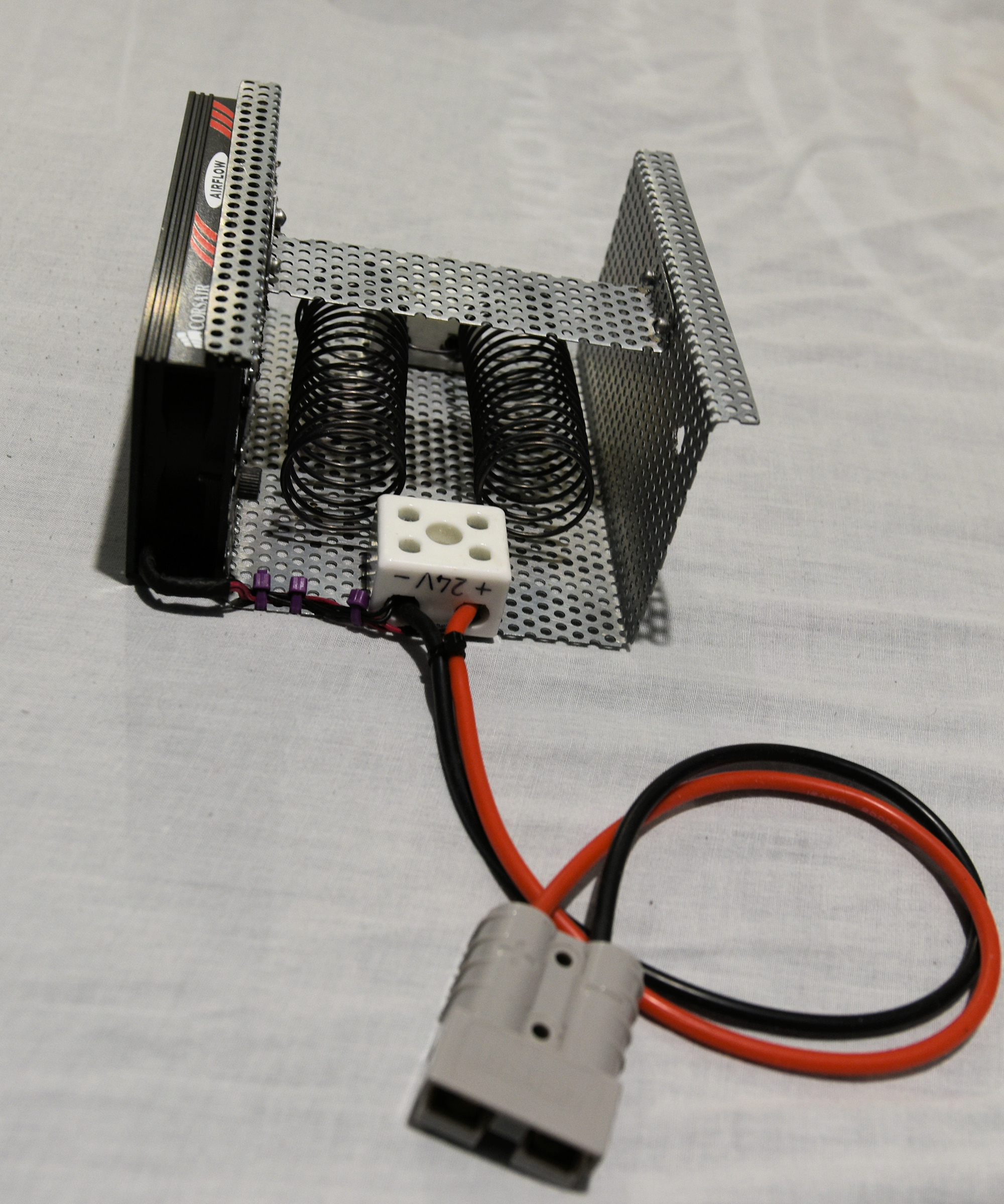

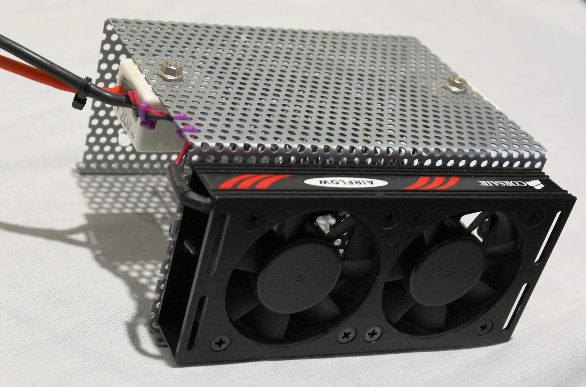

Postby Burgerman » 31 Jul 2019, 21:32
Yes. Its fine to do it too. As long as you have somewhere to send the power. I use my power supply with voltage carefully set, to run the PL8, and thie load device in the picture.
Then I set it to charge or dump its power into a lead battery at its standard voltage. Once you figure out the settings, you can discharge at 30, 0r 40A. Set it to 12V and power the PL8 at 12V and set to charge (DUMP its power at 14.4V) and you can discharge a pack at around 20A. You will need to understand whats going on, and use an adjustable power supply. Or things get complicated!
Posts: 70446
Postby Burgerman » 31 Jul 2019, 21:34
Blows hot air.
You CAN also use a bunch of car headlamp bulbs. Or A 12/24V inverter to power say a hairdryer or room heater, or kettle...
Theres many ways.

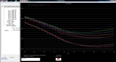

Postby shirley_hkg » 01 Aug 2019, 13:04
Bulk discharge stopped with 99,990 mAh.
Cells' actual readings @3.605V - - - 2.98V
101,212
100,971
99,998
99,990
100,511
100,680
100,561
100,606
Postby Burgerman » 01 Aug 2019, 13:19
You stopped too soon. The voltages bounced back. Thats not a full discharge. But its close. But you can see that too.
Posts: 70446

Postby Burgerman » 12 Aug 2019, 19:20
Whats a VDU?
The PL8s are kind of matt. My PC monitors are dell 30 inch in the photos above, and yes matt surface. But I got rid of those and now use an OLED gloss screen, 4k 55 inch TV in place of a monitor(s)... Its gloriousand way superior to a pair of large computer professional monitors. My laptop is 4k as well, and gloss screen. I dont like matt screen monitors. It ruins the blacks.

Postby Scooterman » 12 Aug 2019, 22:26
This looks Matt to me
My Mac :admirer has a retina display butred
Postby Burgerman » 12 Aug 2019, 22:55
It is. Its a single 30 inch dell pro 2560 x 1600 resolution monitor. Around 1500 pounds when new. I had 2 on my bench side by side. I am greedy.
