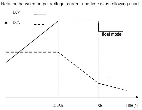

Postby Burgerman » 17 Aug 2019, 19:43
Heres a 3 stage graph. Idealised drawing rather than measured.
Remember if you continue the CV stage for long enough (1000thC or 8 hours typically) at the CORRECT voltage for the specific chemistry no float is needed. And 100% charge completion happens overnigh usually. Which is why its the best way to do this in cyclic use.
Also remember that no mobility chargers or any cheap generic chargers come close to achieving this. So you get short range, and short battery lifespan.
WHY it matters!!!

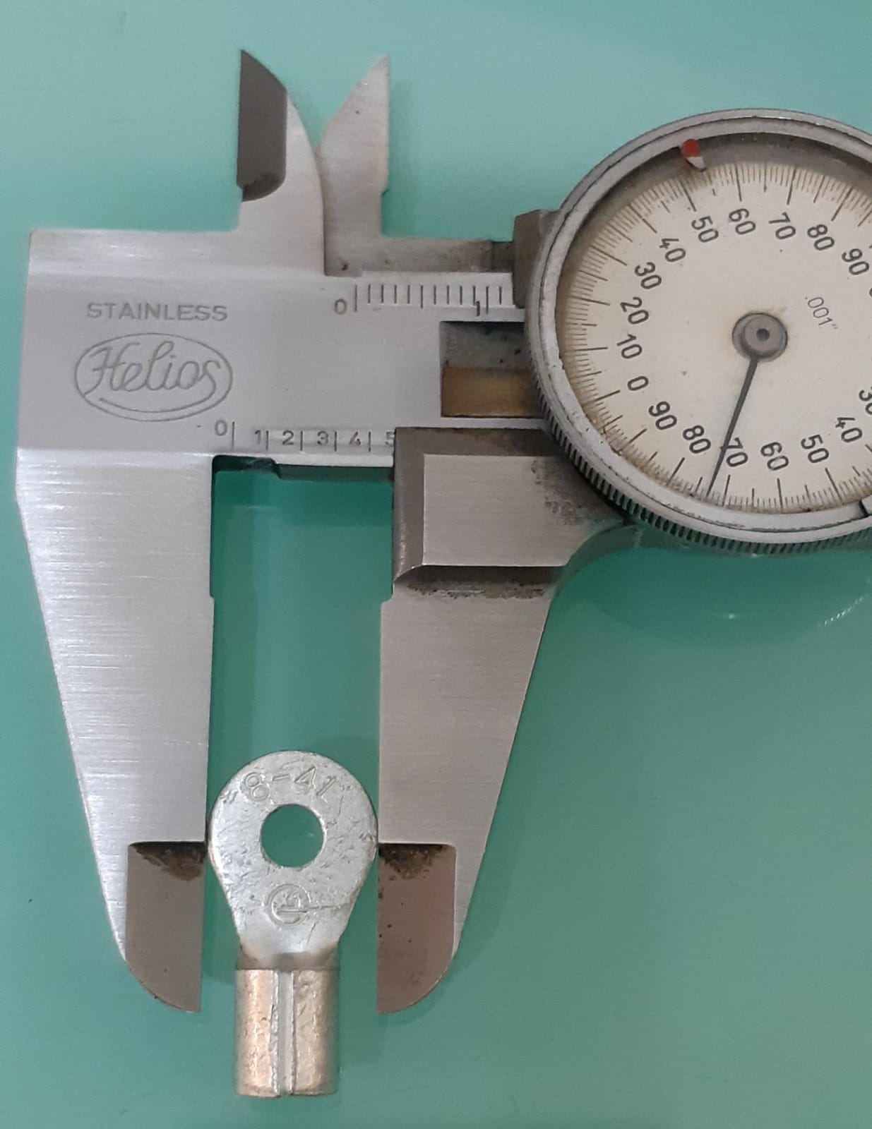

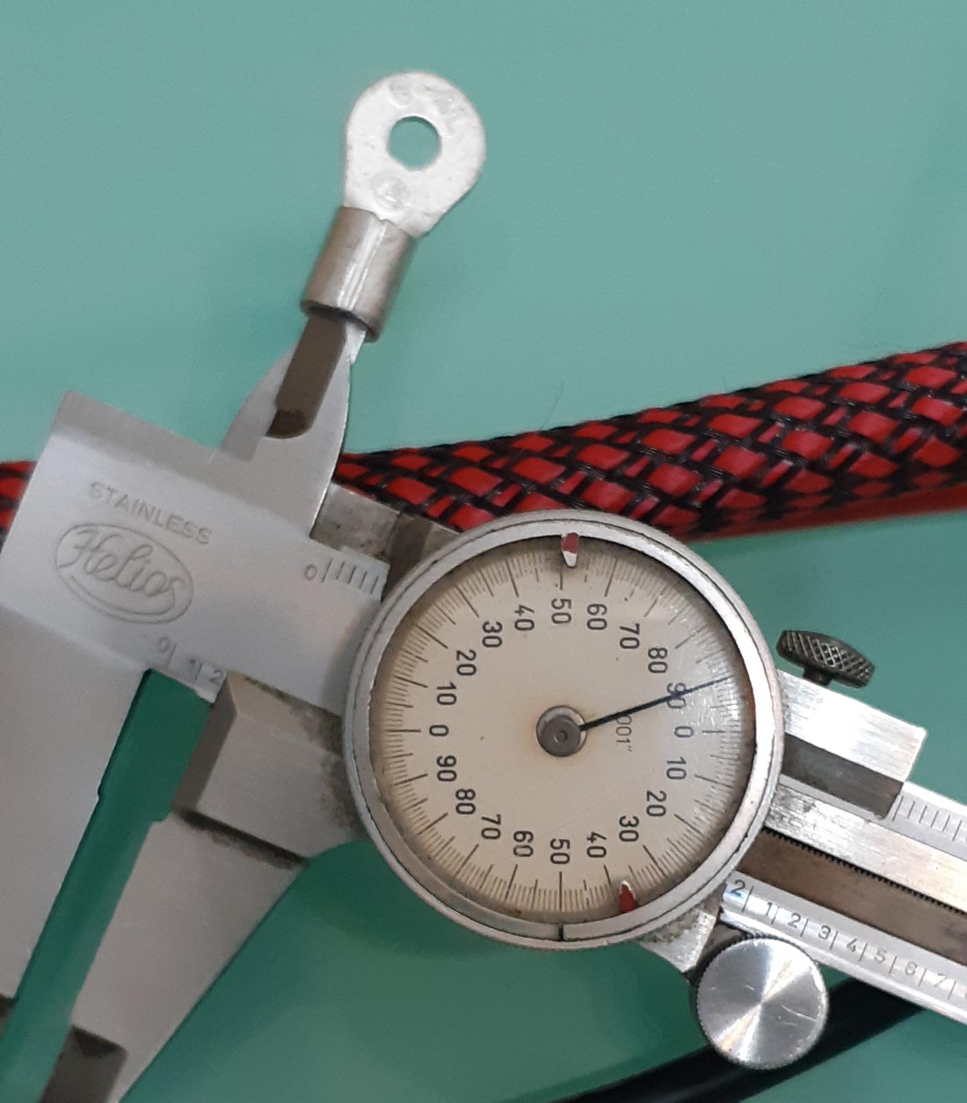

Postby shirley_hkg » 20 Aug 2019, 14:44
Scooterman wrote:Are lugs available that can accommodate a large diameter cable but still have only an M4 bolt clearance hole?
The reason I ask is usually the larger the cable size the bigger the lug bolt clearance hole?
At least that's the way it tends to be in the UK but I'm only familiar with power/mains electrics so perhaps automotive lugs are different? But then it seems everything is available in China. Some of the stuff you post Shirley you'd never get over here.
It can take 8awg cable.
Ring OD @0.473''
Barrel ID @0.19''
Thickness 1.5mm.
Battery has 10mm round terminals .
Posts: 4565

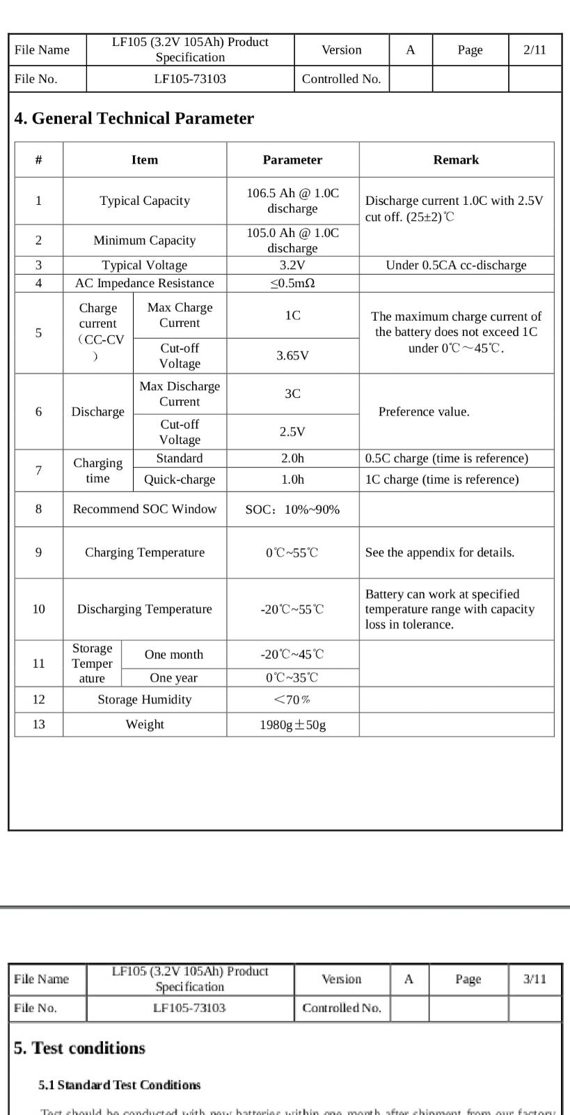

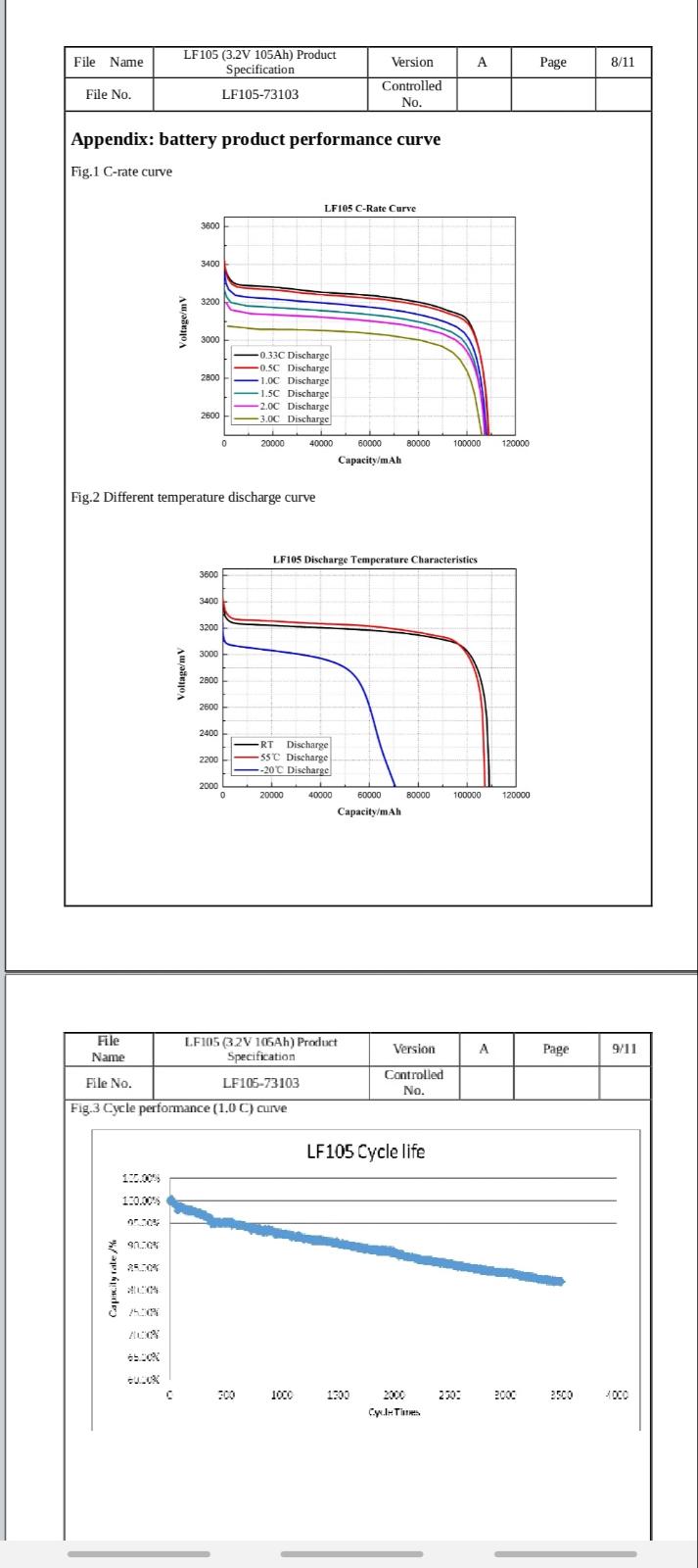

Postby shirley_hkg » 20 Aug 2019, 15:19
Can I have a link to accurate measurements of those 105Ah cells?
They are not perfectly flat. I will pile them up and measure the thickness of 8 cells .
Official specification file too big to post , 775k.
Still want it ?
Posts: 4565

Shirley tested a set. Full capacity. Low resistance for a high capacity low C rate type cell, and consistent. Only negative is the small M4 thread. But if you are not ham fisted and understand what you are doing that need not be an issue.
Posts: 70462
Postby Irving » 26 Aug 2019, 11:30
Burgerman wrote:Shirley tested a set. Full capacity. Low resistance for a high capacity low C rate type cell, and consistent. Only negative is the small M4 thread. But if you are not ham fisted and understand what you are doing that need not be an issue.
M4 definitely isn't an issue. Get a bike stem torque wrench 0.5 - 10Nm set for 3 - 4Nm or finger-tight + 1/2 turn approx, or better still stud them. Use the right ring terminals (e.g. AMP Solistrand 324061 Nickel/tin plated copper 10mm dia, 4.4mm hole for 6mm - 10mm sq wire, from Farnell or Chinese knock-off) to give the right cross-section for the current - I think this is important, there's not much contact area with M4, its much more critical than M6 and cheap ~6.5mm dia terminals might get hot at high load.
