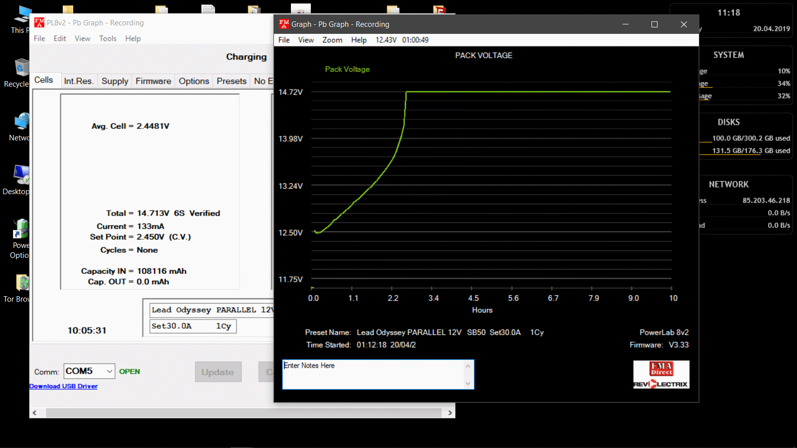

Postby Burgerman » 17 Aug 2019, 19:33
And here is a hobby, PL8 charger CHARGING the battery properly!
In this case its an ODYSSEY battery, so correct CV voltage is 12.70V at 20 centigrade.
First part is CC. 2nd part is CV stage. Only 2 stages are needed if the CV stage continues until a very low 68mA. Or double this if charging in parallel (2 batts) as shown. Or 8 hours CV whichever is sooner.
THIS is what the yellow graph SHOULD have looked like.
Posts: 70459
Postby Burgerman » 17 Aug 2019, 19:38
Here are the AMPS gradually falling away.
Stage one is CC (Constant Current)
Stage 2 is CV but the amps naturally fall to an extremely low level in time. Only then is it charged. Many chargers stop far sooner. And rely on around 6 to 12 hours float to top up completely. If you do not allow that time, they will become rapidly sulfated and deteriorate.

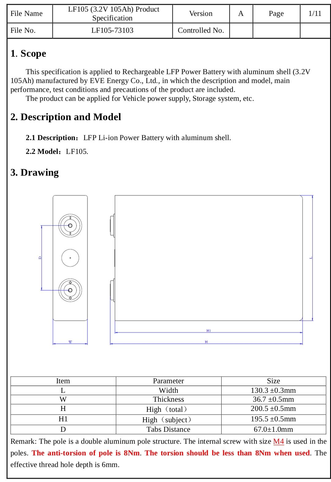

Postby shirley_hkg » 20 Aug 2019, 15:19
Can I have a link to accurate measurements of those 105Ah cells?
They are not perfectly flat. I will pile them up and measure the thickness of 8 cells .
Official specification file too big to post , 775k.
Still want it ?

Shirley tested a set. Full capacity. Low resistance for a high capacity low C rate type cell, and consistent. Only negative is the small M4 thread. But if you are not ham fisted and understand what you are doing that need not be an issue.
Posts: 70459
Postby Irving » 26 Aug 2019, 11:30
Burgerman wrote:Shirley tested a set. Full capacity. Low resistance for a high capacity low C rate type cell, and consistent. Only negative is the small M4 thread. But if you are not ham fisted and understand what you are doing that need not be an issue.
M4 definitely isn't an issue. Get a bike stem torque wrench 0.5 - 10Nm set for 3 - 4Nm or finger-tight + 1/2 turn approx, or better still stud them. Use the right ring terminals (e.g. AMP Solistrand 324061 Nickel/tin plated copper 10mm dia, 4.4mm hole for 6mm - 10mm sq wire, from Farnell or Chinese knock-off) to give the right cross-section for the current - I think this is important, there's not much contact area with M4, its much more critical than M6 and cheap ~6.5mm dia terminals might get hot at high load.
