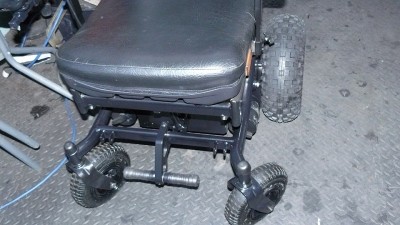

Postby duke1 » 20 Oct 2019, 17:50
rest of pics
cheers

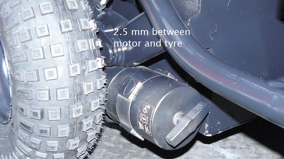

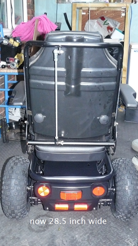

Your width measurement must be wrong.
145 TYRE + 90MM MOTOR + 275MM BATTERY + 90MM MOTOR + 145 TYRE = 754MM Width even if all these components were actually touching. with just a tiny 5mm gap between battery and motor thats a fraction over 30 inches wide with your 2.5mm tyre gap.
The battery can be replaced with any group 24 battery. It will be 15mm less long. So MK gel 74Ah.
Posts: 69890
Re: polishing the turd!
Postby duke1 » 20 Oct 2019, 19:17
Burgerman wrote:Your width measurement must be wrong.
hi it was 60cm wide as standard hence the very tippy feel to it anywhere uneven also being topheavy did it no favours,either way it still fits through the doors which is the main thing and it is now far more suited to tinas needs and if needs be can still have standard size wheels for indoors which was reason for using stock hubs as they fit both now :D just need to get christmas over before i can afford new lead bricks,cheers :dance :joint

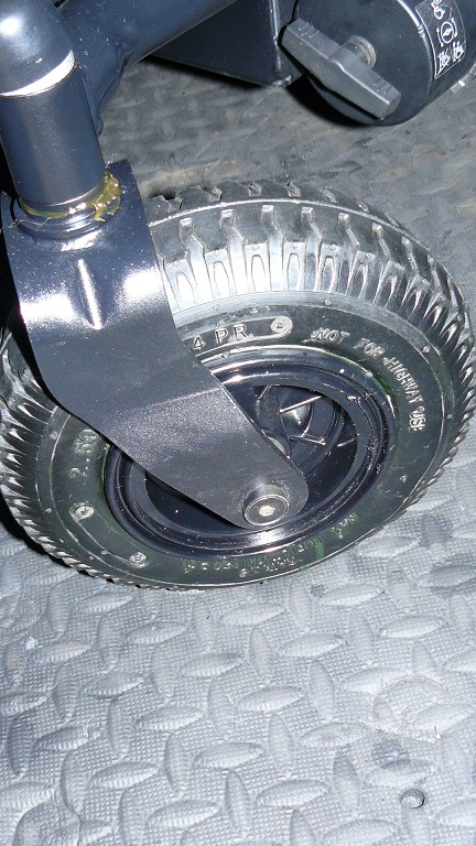

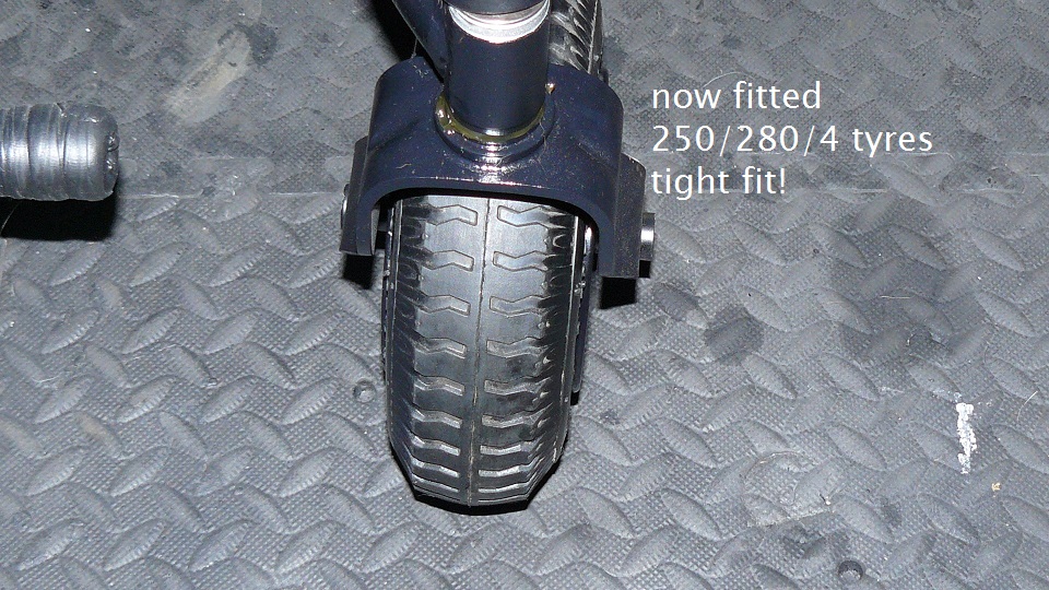

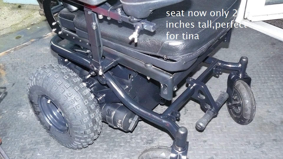

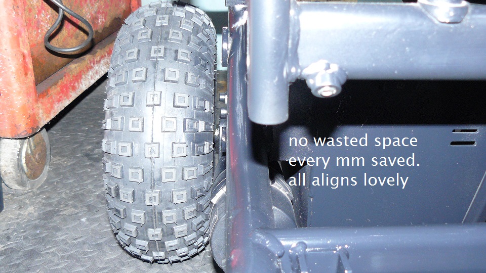

hi all well after a bit more diy i have the 250/280 4 tyres fitted to the turd now and there def as wide as can be fitted to the manky design standard fork should help with not sinking in the quagmire around here i had more trouble getting the tyres on the rim than the big buggers on the back! i have found a set of wheels from some sort of mobility scooter i think but they are suitable for experimenting with fitting tubeless valves and tyre to them in the same manner as the rear using the continental tyre cement and if i can make a pair work i shall test them thoroughly and report findings for anyone interested,the other experiment split rims with a diy gasket leaked at the valve and so needs redoing but did stay inflated and on the rim at 15 psi squeezed tight in the vice!peace :joint cheers

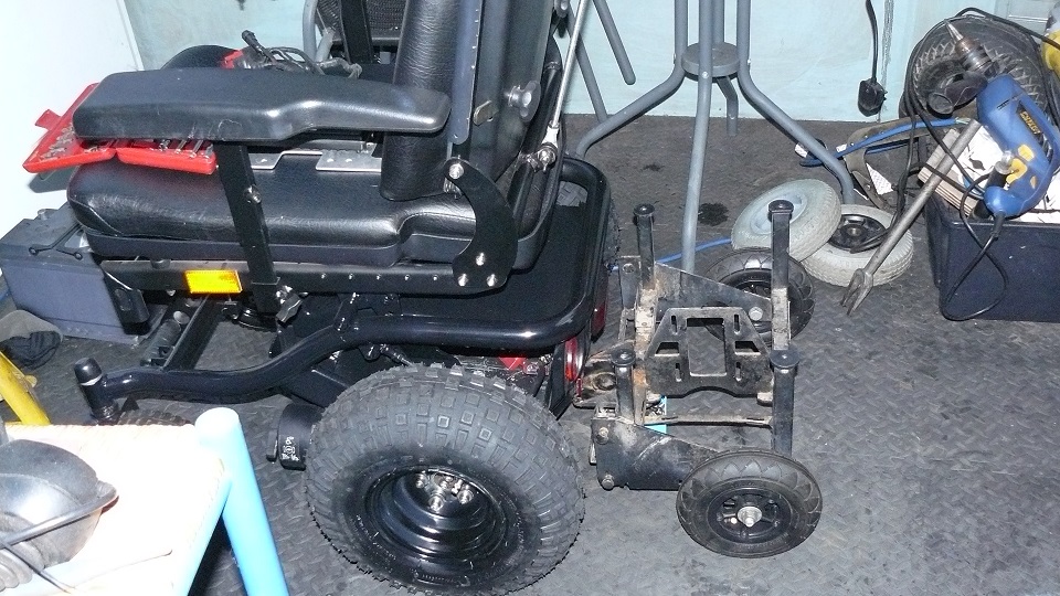

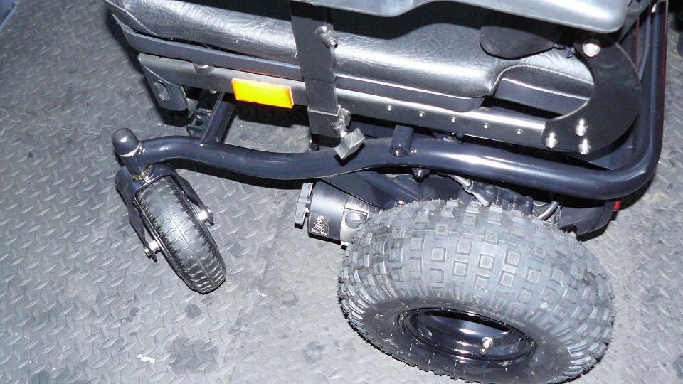

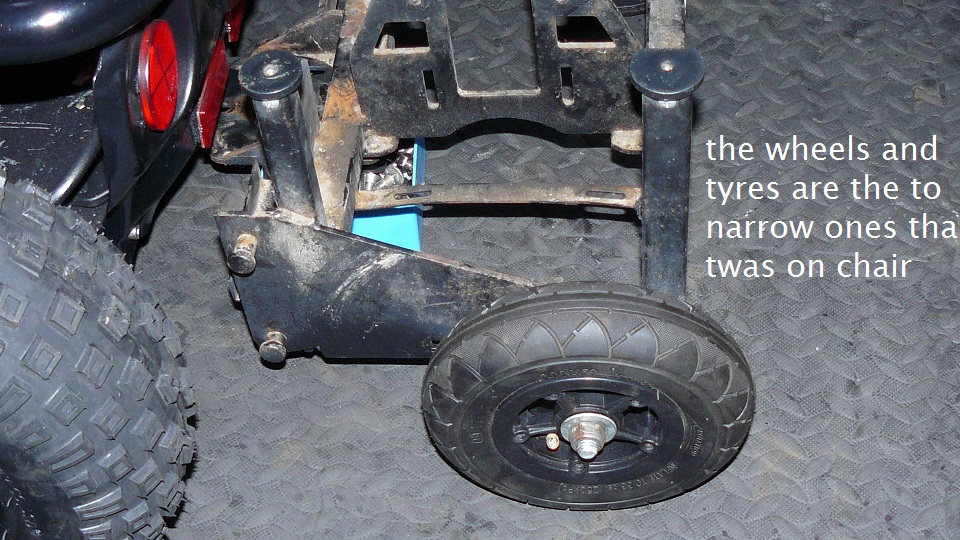

Postby duke1 » 27 Oct 2019, 17:14

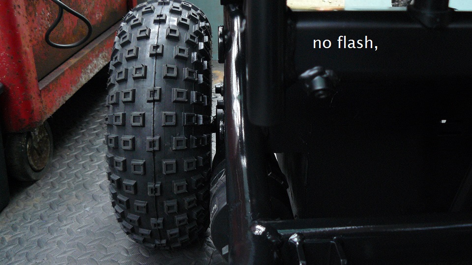

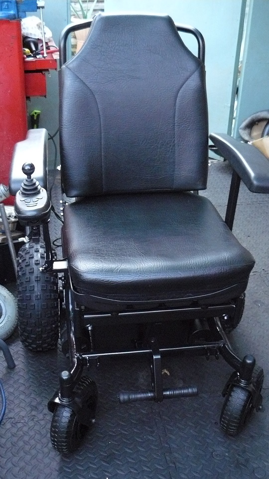

hi all some pics of the turd sporting new front tyres and wheels (wheels from scrapile repainted) had to have tubes but there extra thick ones and tyres are suprisingly thick for cheapies and have ok profile but due to the shonky design of the caster forks there widest possible to fit that i could find,also had a fiddle with some of the settings on the posh camera see if pics are any better,not sure if its camera or me as i have a continuous shake due to nerve damage so tried the anti shake setting this time and turned exposure down a bit,maybe better!
getting there not quite such a turd now! tina seems keen to try it out i just wish batteries was a bit cheaper its a big chunk of cash for us to come up with esp with the current system its hard getting the vat of the cost unless you want pay and reclaim it later which is stupid also notice in the link @scooterman left they say there is no vat relief? anyhow heres my best effort at pics,peace all :joint
cheers more to follow,

Postby greybeard » 27 Oct 2019, 21:00
Looks to me as though your turd now has a very acceptable shine. Great improvisation and persistence. Your lady should be rightly proud of you.

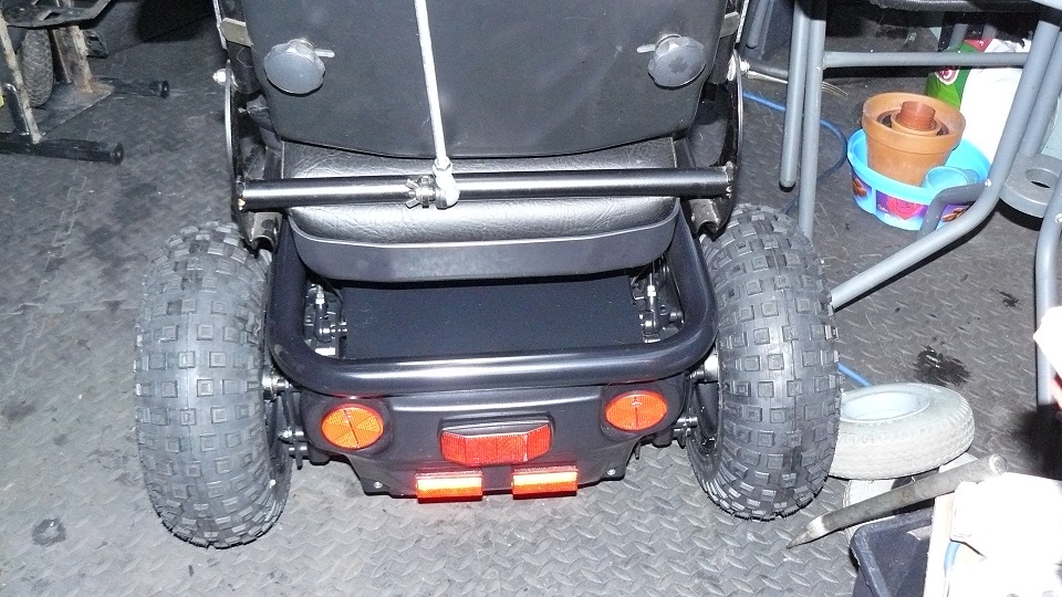

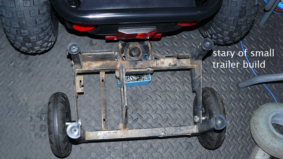

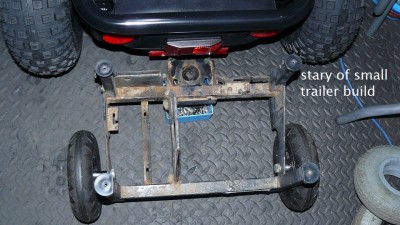

hi cheers she is worth the effort,tina that is not the turd! well i thought while i have to wait to save enough dosh for the lead bricks id get on and build a useful small trailer that will fit either the turd or tinas current chair and save her having heavy bags on her lap or hung from the back of her seat which means her lifting them,or god forbid asking for help! so the wheels are what was the front casters from the turd and frame is half a mobility scooter frame and some bits and bobs from my odd box.lots of uneeded metal still to be removed and obviously derust and paint,cheers cheers :joint

Postby foghornleghorn » 29 Oct 2019, 19:43
Are you going to be running it with no anti-tippers on the back?
Posts: 706
Postby duke1 » 29 Oct 2019, 19:53
foghornleghorn wrote:Are you going to be running it with no anti-tippers on the back?
hi i decided to wait until i have everything else finished and batteries in place and then see what it balanced like and then if needs be i have a plan of how and where to fit anti tip system but if its anything like tinas gunter meier chair it will need them but as to position is the crucial bit as it has to climb a ramp into the car and cant have anti tips where they was before as it causes the chair to bridge on the ramp,crap design! i do take the gm chair up the ramp in reverse and only have trouble if the ramp is wet,peace :joint
