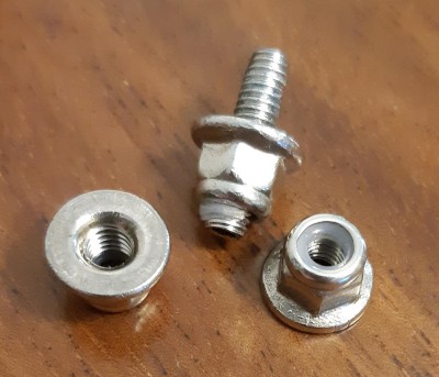

Postby shirley_hkg » 20 Nov 2019, 13:31
I like this SS M4 flange lock nut.
Large contact ,
Plain base,
Thick means more threads .
Will grease it for perfection . :wave: :clap
Posts: 4481
Re: 200Ah Pack
Postby Burgerman » 20 Nov 2019, 13:48
With a wide base, if you tug a cable anti clockwise it will loosen the nut rather than sliding around under it, and remaining tight. But as long as that doesent happen...
Personally I would use a plain, stainless, nyloc nut! And stainless loctited in place stud.

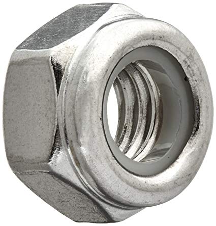

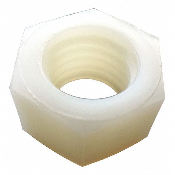

Also you dont have nylon locknuts. You have Nyloc nuts. See: https://en.wikipedia.org/wiki/Nyloc_nut
You may confuse people. Because nylon locknuts means using two nuts, made of nylon locked against each other.
A Nyloc nut (self locking, nylon insert)
A Nylon nut
