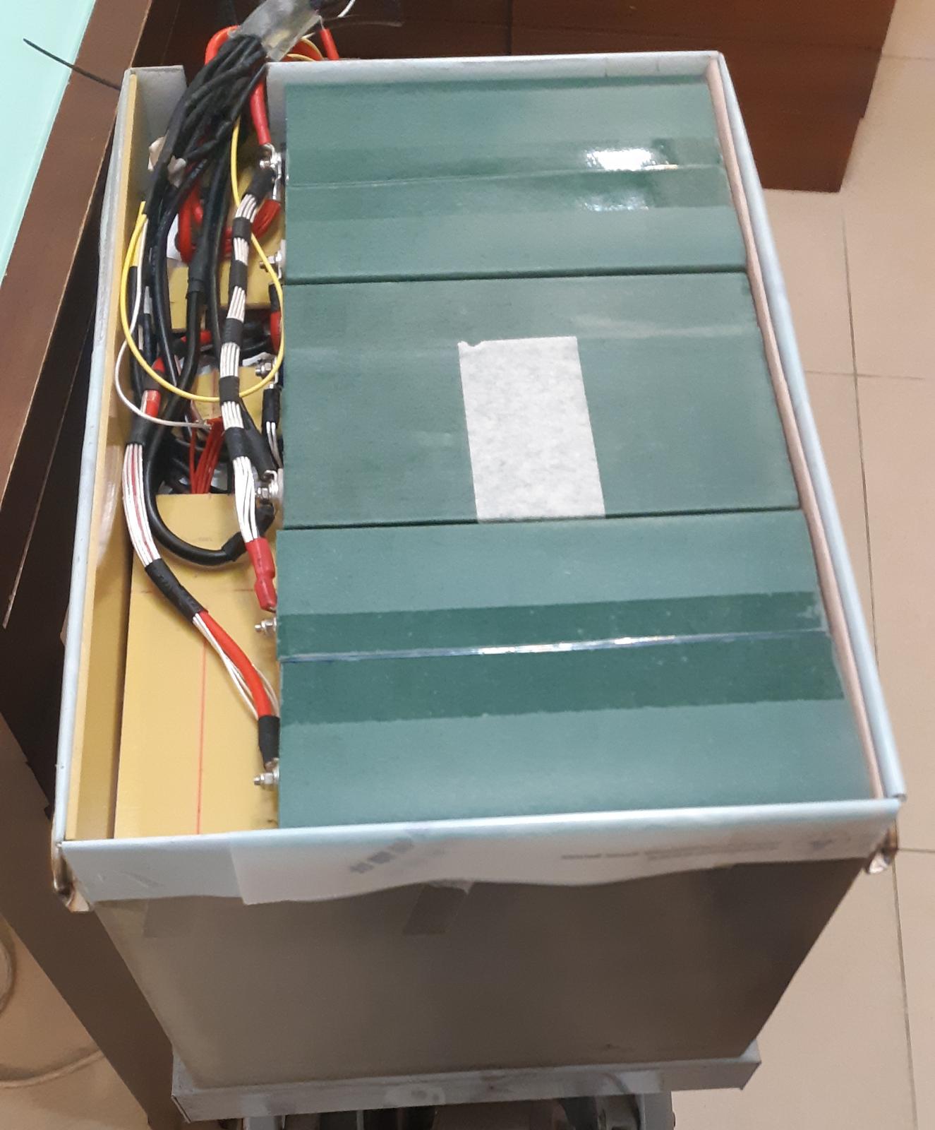

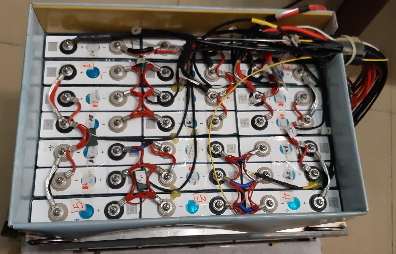

Postby shirley_hkg » 03 Jan 2020, 11:14
Screwed up by the extra 75Ah pouch cells, move forward to a pack with 24 EVE LF-105 cells; ie 3p8s @24V 300Ah (usable) .
This is the bottom layer. cheers
drunk2
Posts: 4481
Postby shirley_hkg » 04 Jan 2020, 15:08
Top layer completed.
Time to fully charge and balance it. cheers

Postby Burgerman » 04 Jan 2020, 15:09
You should make it to the UK by road.
Posts: 69896
Postby steves1977uk » 04 Jan 2020, 15:19
Nice going Shirley! :thumbup: You should be good for 120 miles+ with that pack! drunk2 :mrgreen:

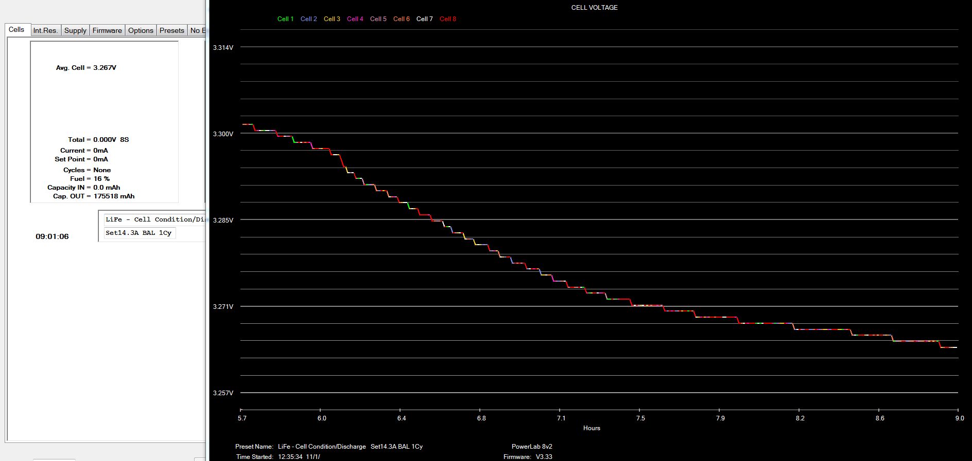

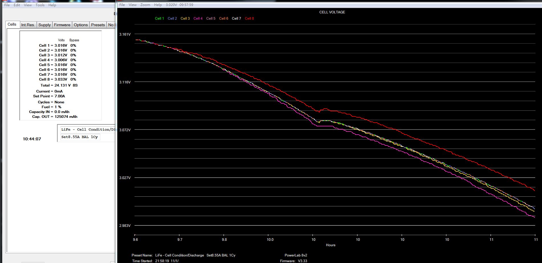

Postby shirley_hkg » 12 Jan 2020, 08:12
Did a capacity test to my Mega_Pack
@3.605V ⇒ 3.00V.
Out of one single reservoir , have to dump it to my two empty chairs by 2 sessions.
175.518 + 125.074.
Total : 300.592Ah.
(real usable @3.006V lowest, pack voltage at 24V , without harm done to cells)
End of race. hanged cheers drunk2

Postby Burgerman » 12 Jan 2020, 10:51
That rediculous. :clap

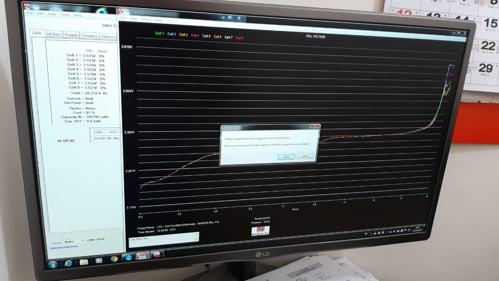

Postby shirley_hkg » 13 Jan 2020, 02:21
Put back 307Ah (15.00 + 292.795)
Posts: 4481
