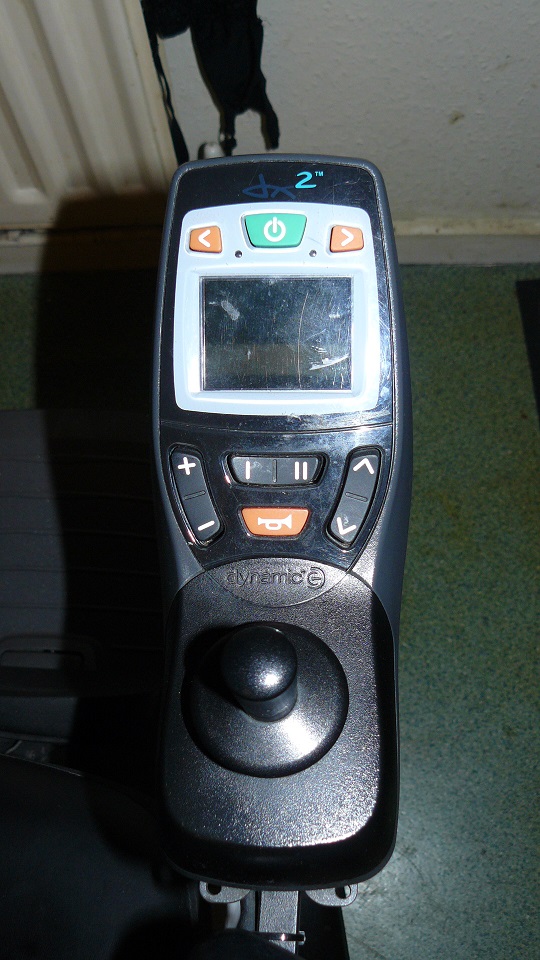

I'm not sure if I'm posting on the right topic, but I'm curious if it's possible to change the boot logo on R-Net devices?

Postby Burgerman » 04 Jan 2020, 17:10
Only if you are the manufacturer of the joystick. They are made as either generic (Displays R-Net) or for each manufacturer as a branded item.

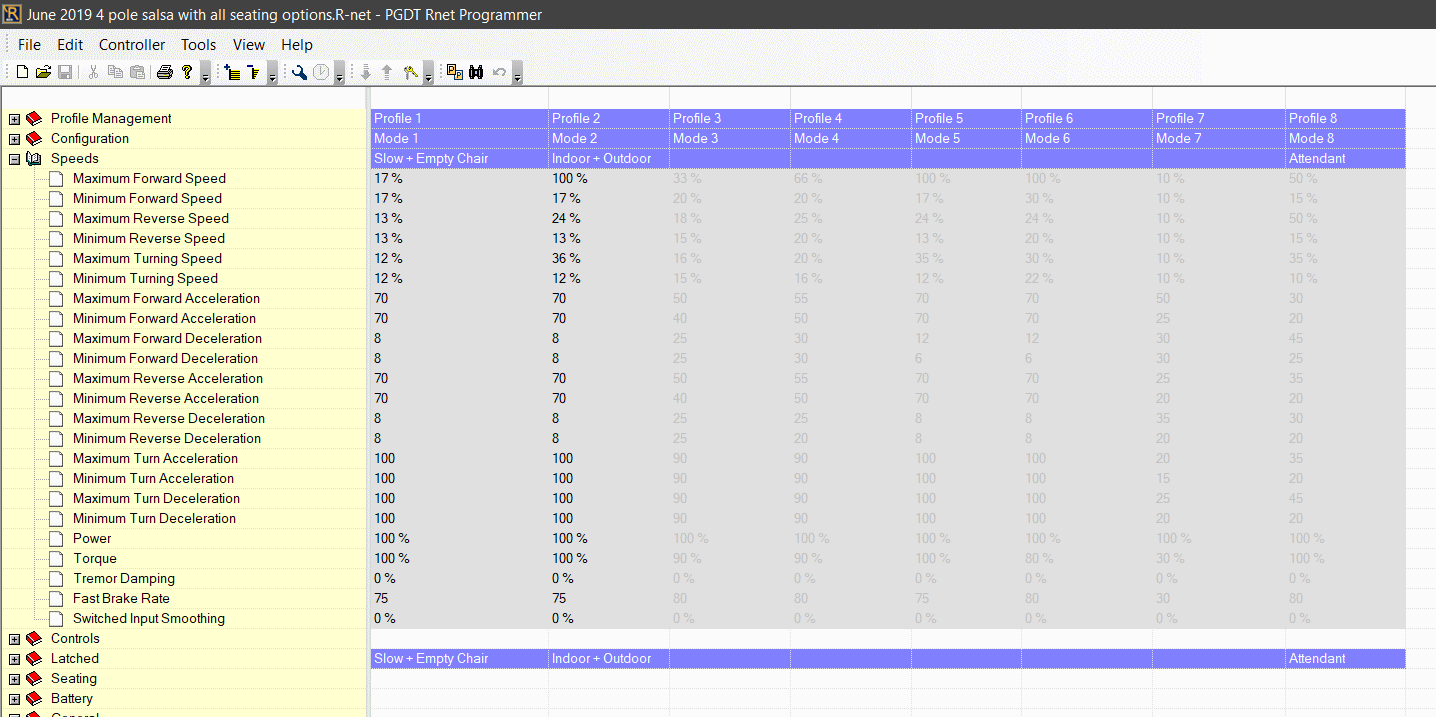

Postby Burgerman » 13 Jan 2020, 13:53
he means do this, my profile 2...
I use ONE profile, for every speed. And once correctly programmed thats all anyone needs.
I have 2 profiles. Profile 1 ONLY does SLOW. Its for moving the empty chair about by a carer.
The 2nd Profile, Profile 2 below, does from very slow so you are bored waiting, to max speed. And I simply choose a suitable speed. One profile is all you need. Disable all the rest.
See download/file.php?id=12645&mode=view

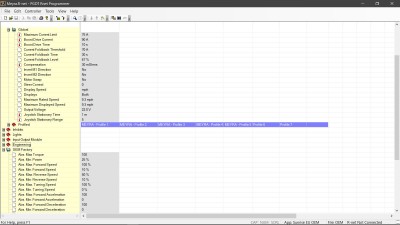

Postby terry2 » 15 Jan 2020, 15:53
Here is my save from the dongle.
Going to study it now. But the program said I was using older software. So I will get that now.
@BM have you got the code\number for that fancy 3,5 inch screen controller please.
Meyra.R-net
(3.81 KiB) Downloaded 301 times

Looking at BMs file. I'm missing a few things.
The software does not tell you what hardware you have like the DX2 software does.

Postby Burgerman » 15 Jan 2020, 17:13
You will be missing many things. I just looked. That file is DEALER level.
Posts: 71099
Postby Burgerman » 15 Jan 2020, 17:28
I can UNLOCK it, with the OEM software, and then see many more parameters. For e.g in the motor section, and elsewhere. Like the settings in the ESP section, with loads of settings for you to experiment with!
As expected it appears they sold you the DEALER version which is useless for all intents. They wont sell you OEM.
Posts: 71099
Postby Burgerman » 15 Jan 2020, 17:35
Once UNLOCKED I can see more.
For e.g 70A current, 90A boost... 22V max
And a few ABS walls set.
Posts: 71099
Postby terry2 » 15 Jan 2020, 18:05
Burgerman wrote:You will be missing many things. I just looked. That file is DEALER level.
The CD had the 6.1.0 OEM software which I installed.
On the back of the dongle it says D50609,03 and in the little box on the bottom right is an A
How do I unlock it or should I send it back?
Just checked and yes they have sent me the dealer version :fencing

Postby Burgerman » 15 Jan 2020, 19:38
If you use the OEM PC software, you can CONVERT your DEALER level file, the one on here, to an OEM one. Then you can see and edit everything. Then you can save that back to your desktop, and write that with the DEALER dongle to the chair regardless. Should you want. I used to do that, then got an OEM dongle to save the extra steps.

Postby Burgerman » 15 Jan 2020, 19:57
Your DEALER dongle marks the file DEALER.
If you see at the bottom it says file: dealer.
If you then save that to the desktop with a new name like OEM1 and then shut down. The OEM software marks the file OEM.
Then, Re-Open that file with the RE OPENED OEM software again, you will see its now an OEM file. And more options...

Postby terry2 » 15 Jan 2020, 20:24
Burgerman wrote:Your DEALER dongle marks the file DEALER.
Nice one :worship

Postby Irving » 15 Jan 2020, 21:46
There's one crucial step missing...
Disconnect the dongle from the PC else the next step appears to work but doesn't always (or in my case, never)
