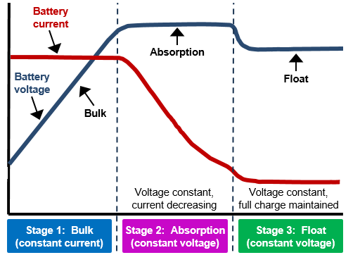

As you begin to charge, the voltage should slowly increase to this level over a few hours, unless its already pretty full. And it should sit there solidly at this voltage for around 8 hours or a little more. The green light should then come after around 12 hours total. At this point they are charged. And the charger does not need to do anything else.
But some charger will now switch to float. So now the voltage drops to 13.5V indefinitely. If your charger does NOT take 10 to 12 hours to go green, then this means its far from fully charged. It means that this float stage (on green) needs to stay connected for another 6 to 12 hours or longer. And only then is the battery fully charged.
Obviously if you have 2 batteries the volts are double all the figures above.
This shows what will happen if your charger is working properly. Note that it always takes 7 to 12 hours on the absorption stage. At your voltage.

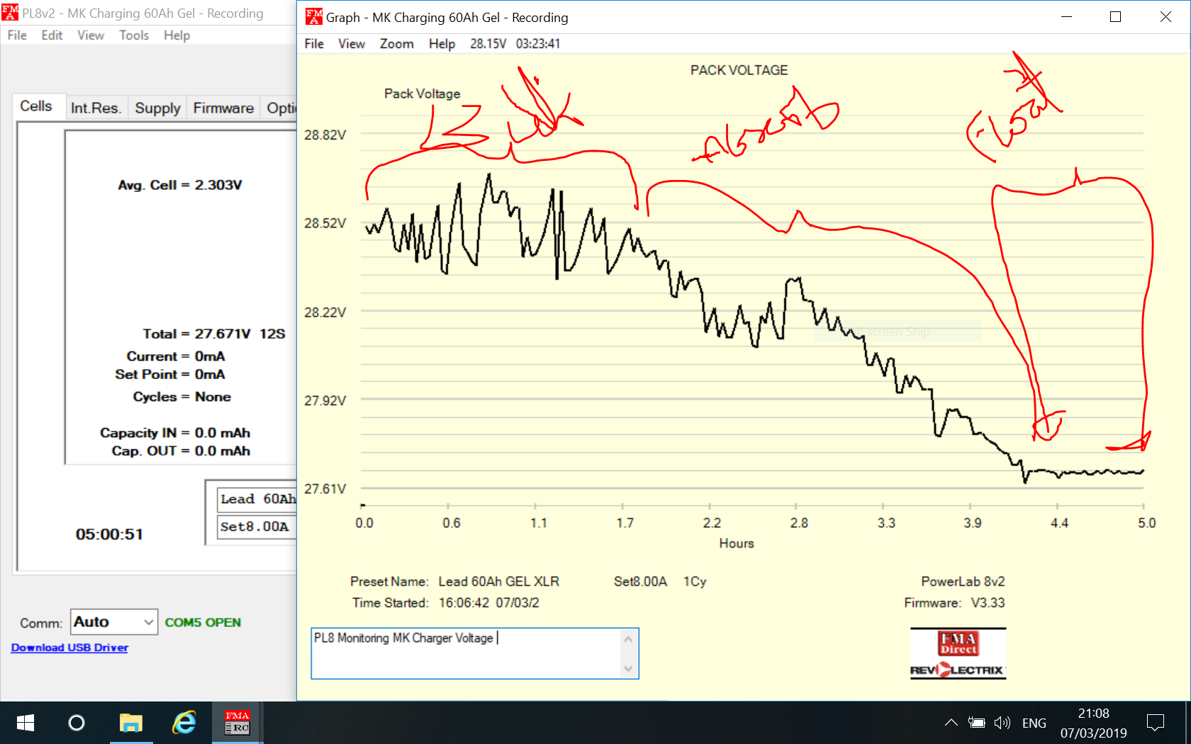

And THIS is the same pl8 charger, NOT charging. It is being used to MONITOR voltage only. In this case not by me,
The battery is being charged on scootermans chair, from memory, with a invacare upright style mobility charger...
Notice that its a complete mess, all over the place, wrong voltages, and it stops way too soon. Unfortunately, this is all too common.
Maybe you can see why I like the PL8! It should have looked the same as the first black graph above. If it was charging properly. Unfortunately non do!
Note that the scribble all over it was scootermans attempt to figure out what the hell was going on. This graph SHOULD have looked like the black ones above! :lol: Mobility chargers are generally junk. This was an invacare one. And it will destroy batteries. Note that it only "charged" at the wrong decreasing voltage, for 4 hours. Then appears to go to a too high 13.8 (double this as its 2 batts) float. They dont care. Its all £££$$$...

It only measure volts. Or amps. You only need measure Volts for this though. As a quick guide.
I just use my accurate clamp meter thats accurate to 1mA to measure Amps. Every now and again. To check its still dropping away. I use the small yellow one here. https://www.youtube.com/watch?v=1sq2WRGPABw Or this does the same thing for 1/5th the price. https://www.youtube.com/watch?v=r7QjTEE2Sn0
Same with the PL8 if MONITORING another charger. Volts only.
If you CHARGE with the PL8 it automatically graphs both Amps and Volts as you watch...

Okay just measure and log volts during the day while on basic 8amp charger is what I understand. Just looking for the curve to go up to something near 24volts correct? Measure at the battery post or ??? If I need to do this to each battery separately that needs a bit more effort. Probably good to run down the previous charge so there is work to be done. Almost sounds like a plan:)
I won't see a smooth curve...mine will be more like scootermans? That curve goes the wrong way I think.
Thxs
