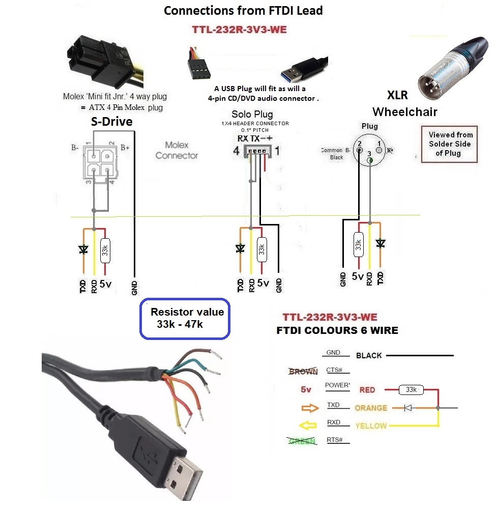

Postby Cornishman » 03 Apr 2020, 06:29
I have just built a new programming lead but when I try to connect to the S Drive I get the message unable to connect to serial port. I had this lead working OK six years ago but do I have to alter the comms settings on my laptopto make it work. I cannot remember what I did last time to get it to recgnise the controller.
Can someone please advise?
Cornishman
Posts: 37
Joined: 12 Feb 2016, 12:32
Postby woodygb » 03 Apr 2020, 09:37
The Programming software only recognises Com Ports 1-8 inclusive.... So what number has Windows assigned to your lead?
What chipset does your lead use and which model of S-drive ?
Also note that YOU must inform the Software what Comms port number the lead uses.
To do this ... Click Tools ... Comms ...then pick the number ( 1 - 8 ).
Postby Cornishman » 03 Apr 2020, 19:20
Thank you for your reply.
I assume that I can find the comms port assigned in Device Manager.
I have built the lead exactly as shown at the beginning of this post, not sure what the chipset is.
My controller is either an S120A or S140A. Device is at my sons at this time.
The software has comms port 3 selected.
I assume this should match the comms port in Device Manager.
Cornishman
Posts: 37
Postby woodygb » 03 Apr 2020, 19:45
Information for building a lead taken from the beginning of this post is now a bit dated.
Device manager is the place to go to find the Com Port number AND it should also tell you the chipset type.
Postby woodygb » 03 Apr 2020, 20:40
Yes
Postby Cornishman » 04 Apr 2020, 07:34
I have just come across your lead in another post which looks the same as the one I built, but does it have an option of connecting through the s drive charging point?
This would save taking off the cover to connect through the molex socket.
Is the lead I built out of date now?
Cornishman
Posts: 37
Postby woodygb » 04 Apr 2020, 07:59
The option of connecting thru the charging port depends on if the molex is actually connected to it by the wiring loom.
You could buy an 4-Pin ATX 12V Extension Cable (12") and extend the S-drive molex to somewhere more convenient ...
https://www.amazon.co.uk/kenable-Female ... 84&sr=8-13
This is a fairly up to date schematic.... I use a 47k resistor but others have suggested a 33k.
The attachment plugs pgdt 2.jpg is no longer available
I have also recently tried and had success with just two Schottky Diodes.
