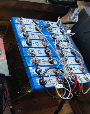

Alot of sweat and toil has gone into my lithium pack, i am pleased with result. I will start charging tomorrow,
ICEUK
Posts: 580
Joined: 27 Apr 2013, 11:51
Postby Burgerman » 04 May 2020, 23:21
I am seeing a lot of very battered looking crimps. I do hope they are soldered... Or there may be trouble ahead...
Posts: 69775
Postby ICEUK » 05 May 2020, 00:39
Yep all soldered, will charge pack tomorrow so hopefully resistance will be kk
ICEUK
Posts: 580
Postby swalker » 05 May 2020, 00:46
You have short, straight cables between the cells.
It would be better if those were longer and curved a bit. That would allow for some movement without stressing the posts or connectors.
Other than that, it looks good. It must be exciting to be at this point!

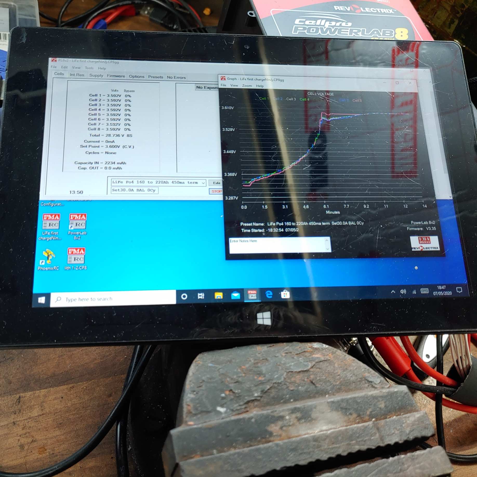

Postby ICEUK » 07 May 2020, 18:53
Here is a ss of the pl8 when finished, i will charge pack a few times.
ICEUK
Posts: 580

Postby Burgerman » 08 May 2020, 04:13
Looking better.
Posts: 69775

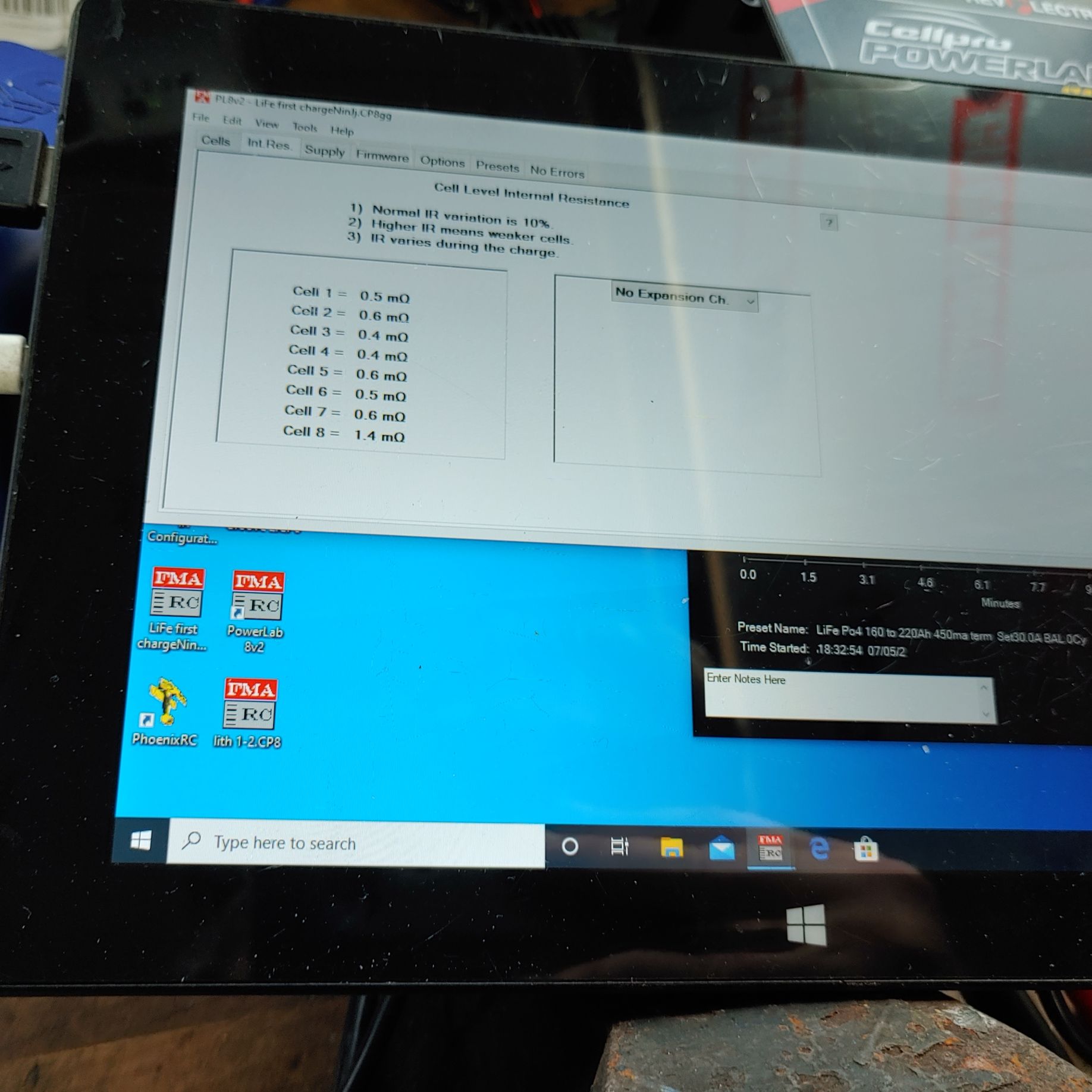

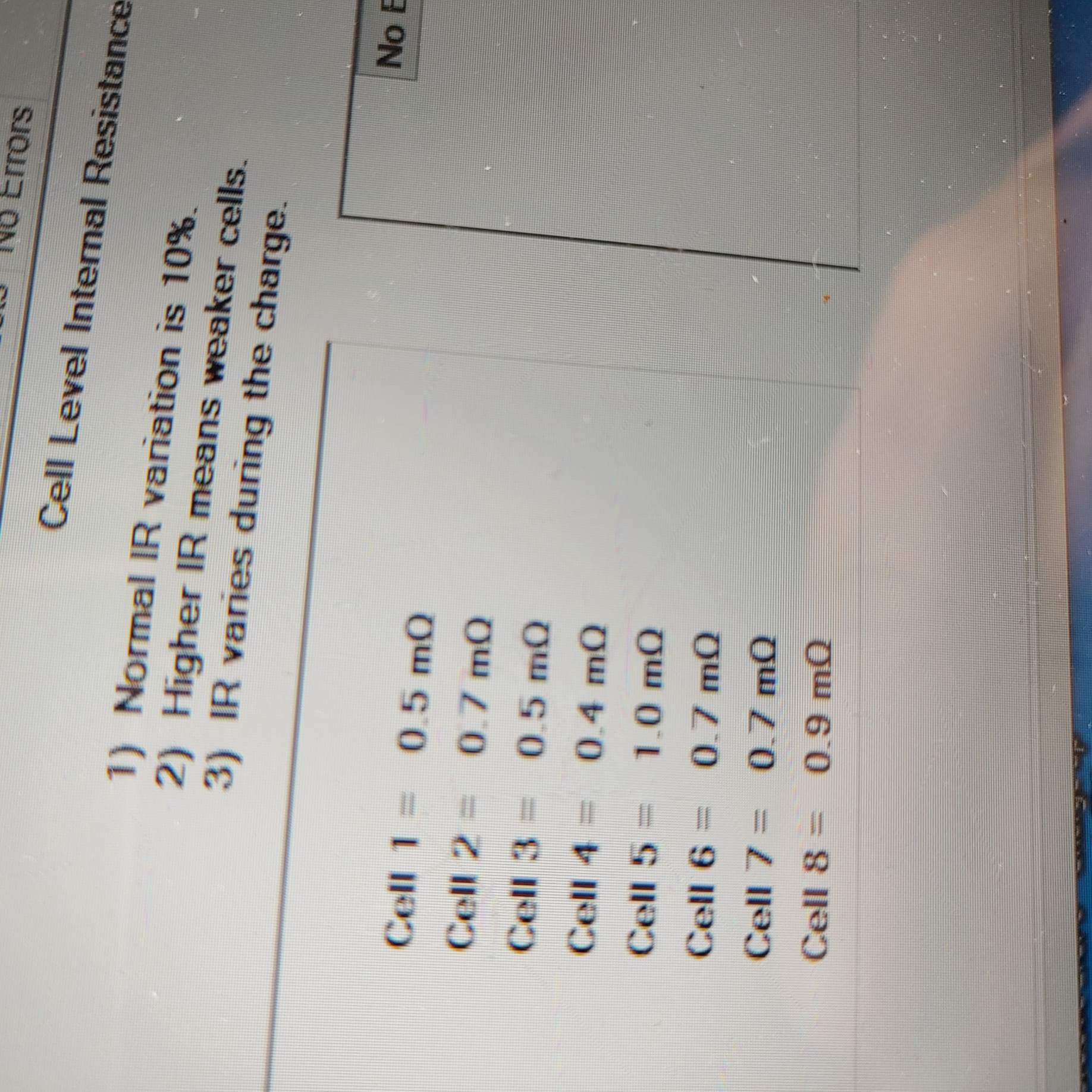

Postby ICEUK » 16 May 2020, 19:32
A couple of pictures showing resistance and the pack charging up, it looks ok?
ICEUK
Posts: 580
Postby Burgerman » 17 May 2020, 09:33
So far. Screen shots area bit literal! And hard to see though.
Posts: 69775

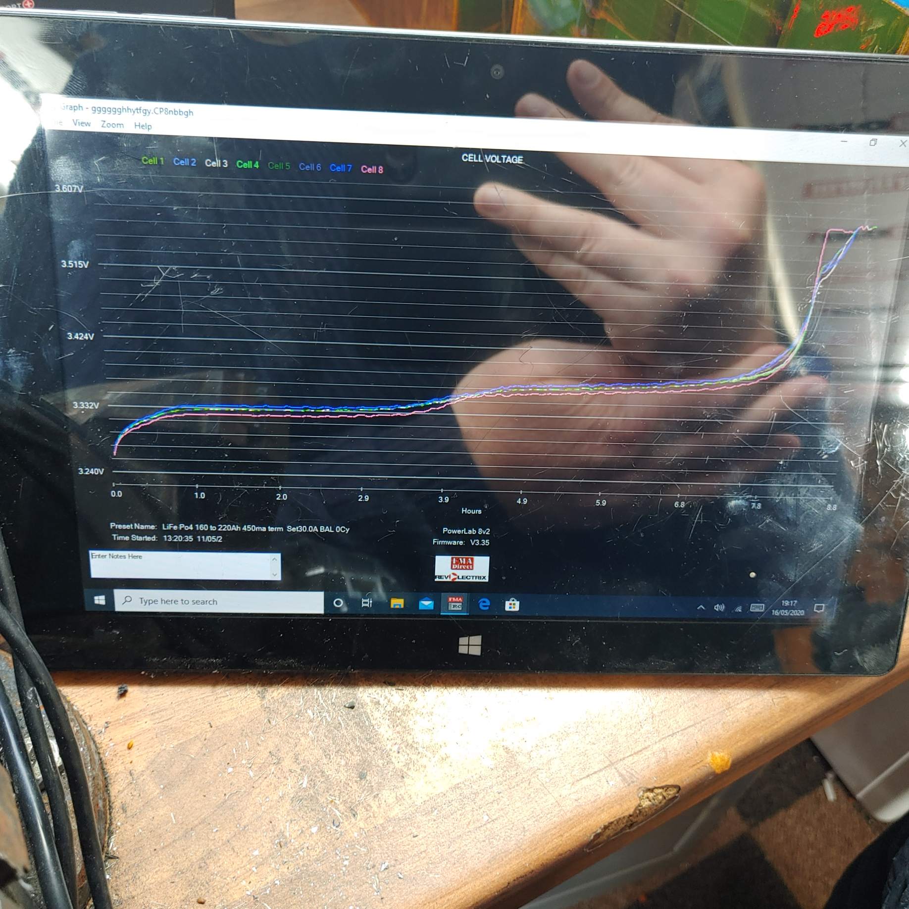

Postby ICEUK » 24 May 2020, 12:32
If i charge my lithium pack all cell voltages are 3.595 then it stops but if i continue to watch the voltages one cell in particular loses more voltage than all the rest, is this a weak cell?
ICEUK
Posts: 580
Postby Burgerman » 24 May 2020, 14:48
Depends on your definition of weaK.
Some cells will have a greater self discharge level. So if all charged equally that cell will drop in voltage faster. But voltage isnt capacity.
Some cells may have a greater capacity that other cells. Those become empty first. Or if unbalanced are full first.
But also, some cells are LAST to be charged full. While the rest are sat and soaked at the full voltage. This last cell as less time sat full. So discharge by 5 or 10 Ah, and recherge. Do this half a dozen times and that lower cell may vanish. Alternatively charge all full. And then charge ONLY THAT ONE, to 3.625V for a while. Then discharge, and recharge.
Also it matters how fast it discharges. And do you have any graphs, or screenshots?
Posts: 69775

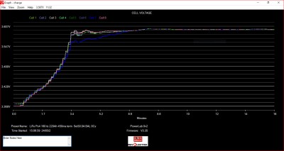

Postby ICEUK » 24 May 2020, 15:33
Here is a charge file, i think it looks ok?
I added .txt. To file extension so i could upload ot
charge.CP8.txt
(9.24 KiB) Downloaded 189 times
ICEUK
Posts: 580
Postby Irving » 24 May 2020, 16:22
ICEUK wrote:Here is a charge file, i think it looks ok?
Looks OK to me, you added just a few Ah to bring all cells to balance...
