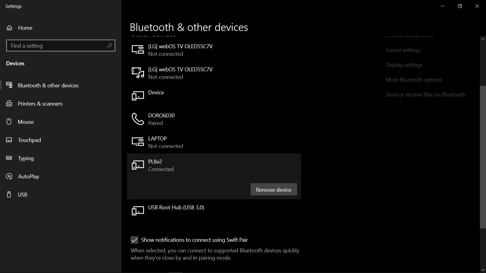

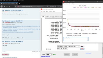

You must do the following. Set BT to be visible to other devices. Set to allow it to initiate connection. When it finds it, add the 1234 serial or whatever yours is. And then check it appears and connects in the black screen below. Then open the DEVICE MANAGER. Be sure the program is open. It MAY crash if you do not DISABLE the extra added com port. Its usually the higher of the two ports. In my case here its the lower one.
The BT device added com3 and com4. Its USING com4. See the software screenshot. So DISABLE com3. If you dont you will get frequent lockups and PL8 program may crash. Once you do it will be easy to connect and reliable. All automatic.
As you can see I am discharging a chair via BT right now in my kitchen. NOTE: It is using COM4.

And this is the settings screen.
Once BT is configured to be , on, visible, allow incoming connections etc it will do so in future automatically.
See black screen here to check its connected and will have the name on the BT card you fitted.

And in DEVICE MANAGER and with program running and connected, DISABLE the COM port that it has added that is NOT used. Dont delete it. Dont uninstall it. DISABLE it!
Be sure it appears under BlueTooth, and also that the STANDARD serial over bluetooth Adapter COM ports lower down. Note that Com 3 is disabled.
Now it will wok reliably.
