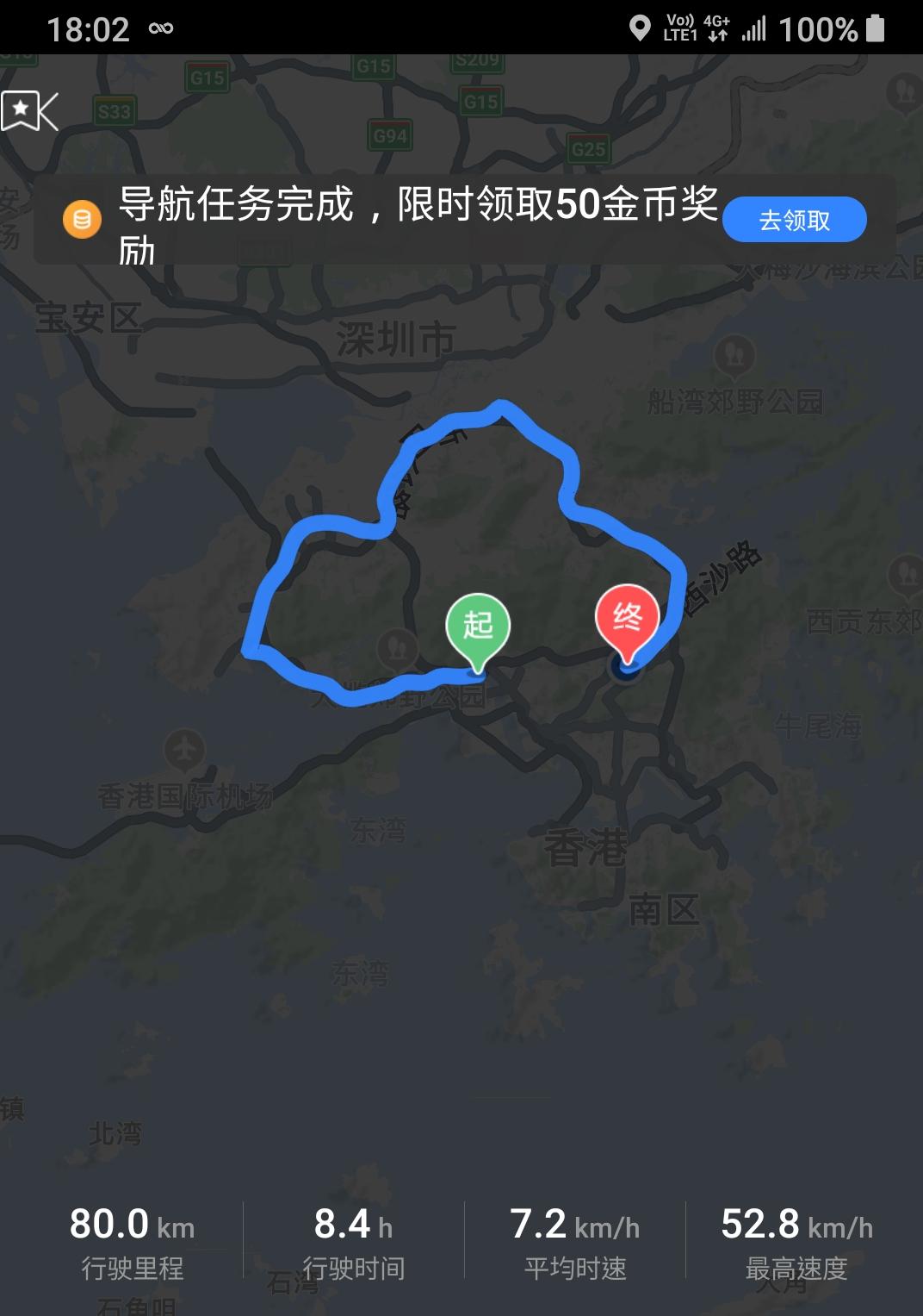

snaker wrote:My maddest range: 83km/89.5 returned Ah. :clap
In fact I was nearly unconscious in the last 4km :cussing A kind guy along the road gave me a 'red bull', it saved me. I should better prepare for long ranges, e.g some beer drunk2
You see the avg speed is 14.29kph. Its max speed must be greater than 15kph because I had to run at very low speed in some dangerous roads. That great speed was achieved just by increase motor voltage from stock 21.5V to max 25V.
https://drive.google.com/open?id=1zVOpR ... sp=sharing
The attachment 82km.jpg is no longer available
Tried the newly completed 65km cycling track in Hong Kong last weekend. 80km recorded with my wife behind wheels , and 102Ah recharged.

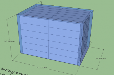

JoeP wrote:I just had my backup chair's battery box measured. My back-up chair is also a TDX-SP.
Unlike my primary chair, the backup chair has no elevation post so the battery space is unobstructed.
As measured, the open area available for batteries is:
9 5/8" wide x 15" deep x 9.75" high, or in metric:
244.475mm wide x 381mm deep x 246.65mm high
The attachment TDX SP LiFePO battery configuration back PNG.png is no longer available
@Joe, would you be so kind as to tell me what software is producing this image please?
TDX Wheelchair Battery Compartment PNG.png (106.23 KiB) Viewed 15206 times

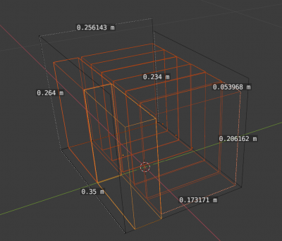

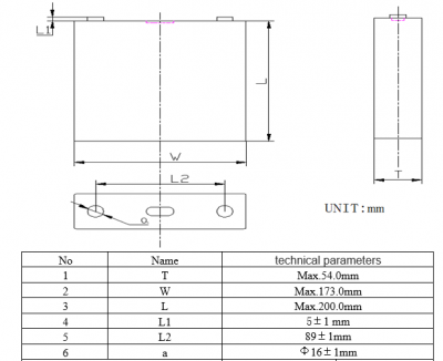

His reference to "glad to hear those info" is his acknowledgement that he's visited this forum with the URL links I referenced in my email so hopefuully some good comes from that.

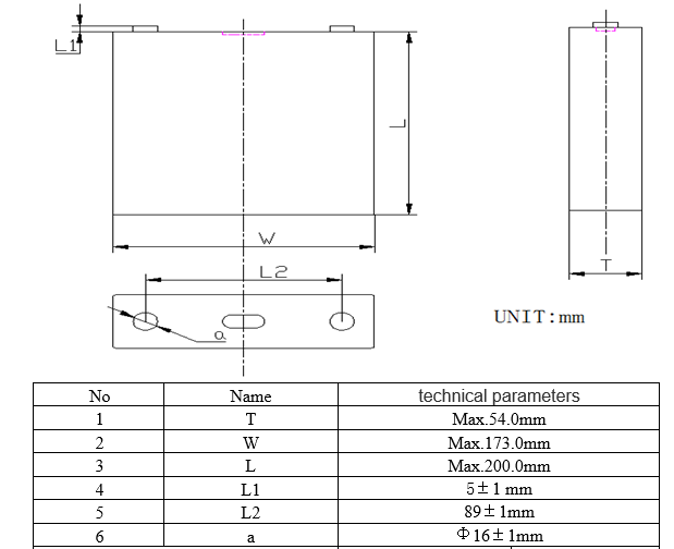

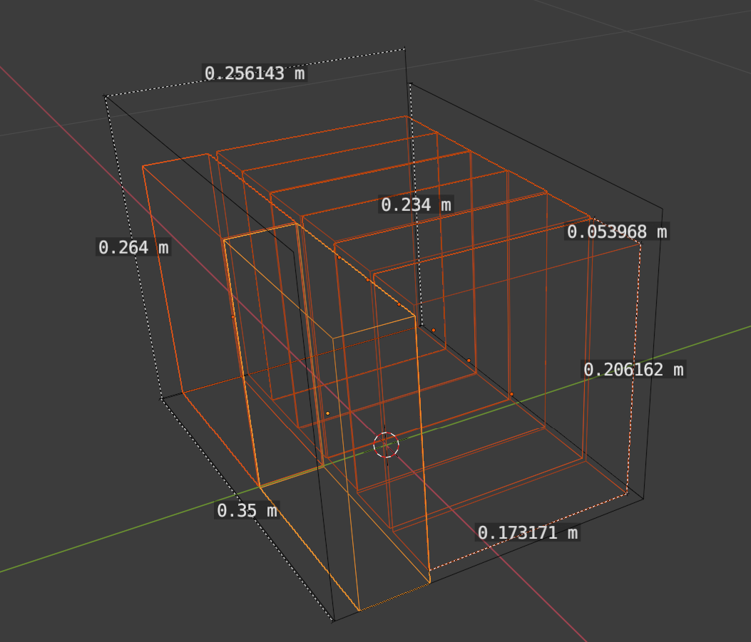

I was able to squeeze eight cells into the salsa R2 by moving some of the R-Net modules to the exterior of the battery area with other quickie equipment covers from other models modules :) ,
Portable 3.2 Volt 200AH Lifepo4 Battery Cells Li-ion LFP Battery Diamensions.png
what do you think BM on the quote and have I screwed anything up so far?

Looks OK to me. Carl is a member here. He was rather spamming a lot so got a small telling off. But seems at least to be consistent! He gave me a similar quote.
I too think they should fit the Salsa, with a little adjustment here and their.
It makes buying 2x MKs at £440 plus delivery (at 35Ah usable) look rather expensive compared to lithium with a real 200Ah usable doesent it... Never mind the throwing away every 9 to 12 months.
Lithium is around double the price, for 6x MORE Ah. And about 7x GREATER service life. Lead made absolutely no sense for a decade now at least.
If you set off with them charged, you dont need worry about voltage monitoring as you or your missus will wear out first. When you see a light or two disapear from the salsas display, you will likely already have gone to bed no matter how far you go.

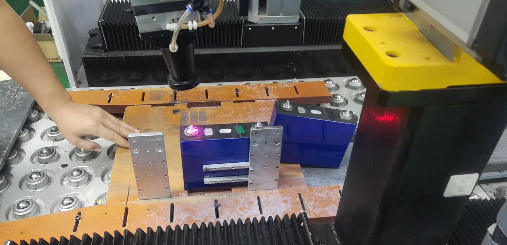

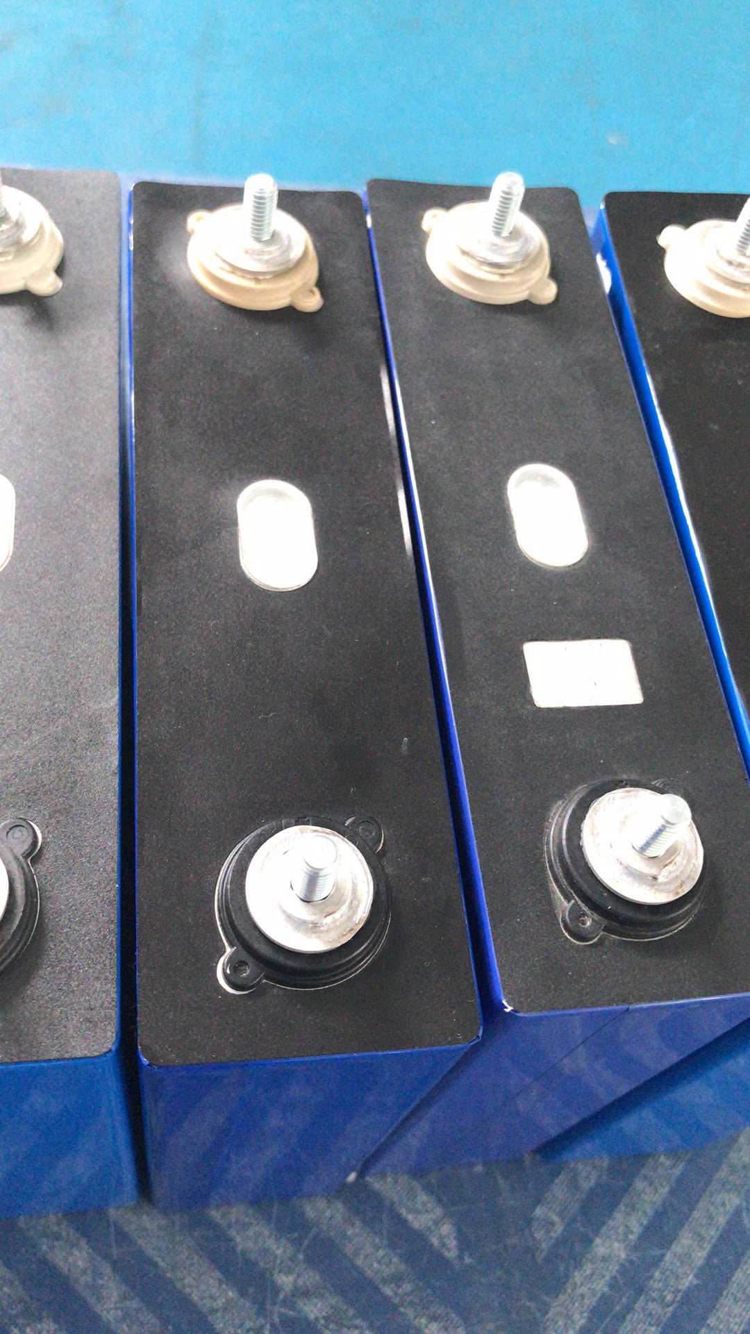

BM as I was about to order and reminded Carl to have a word with the engineers who are drilling the bolt holes to take care et cetera and he's just sent me a reference images to laser welding some bolt into the terminal point, do I want this, is it better then our DIY Loctite solution?
Cheers
Here are the images he sent me:

Postby terry2 » 09 Oct 2020, 08:17
optical10 wrote:
Burgerman wrote:Looks OK to me. Carl is a member here. He was rather spamming a lot so got a small telling off. But seems at least to be consistent! He gave me a similar quote.
Cheers

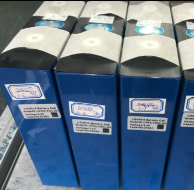

Are those used cells?
New ones should have a Holo-marker.
The ones he sent me was used, but they are going ok.
Look at the video on this page to show you what I mean https://www.aliexpress.com/item/4000973 ... web201603_

Postby optical10 » 09 Oct 2020, 12:29
terry2 wrote:
Cheers
okay Terry, I'll check with them and report back, just the info I needed thanks.

Postby optical10 » 09 Oct 2020, 14:48
Just got this reply back from Carl and it looks like they are new for this particular quote, it would be good if we could compare prices on your used supply from them if you don't mind? I know quotes are based on supply demand etc and it varies day-to-day but still.....
"Hi
The cells were produced on June, and in our stock now.
But they are brand new not used cells.
Thanks.
Best regards
Carl
Overseas Manager
RJ Energy(CRJ Technology Limited)
Mob: 0086 13430203848
Whatsapp: +86 13430203848
Address: NO.16 RongHe Road Nanhai District Foshan China"
Terry the link you sent me at Aliexpress was a good comparison as I didn't even have any other suppliers before for the same size cells however they have a 71 day delivery compared to 40 days from this firm RJ Energy even though they are both coming from China . Shame as I thought that they might have enough stock in Poland which would have been a seven day delivery and the USA is also unavailable from them :-(.
Also RJ Energy will not charge me extra to laser weld the bolts which I'm going to take a chance unless anybody had bad experiences laser welding stainless steel bolts to the terminal posts?

Postby terry2 » 09 Oct 2020, 14:54
"Hi
Thanks.
Best regards
Carl
Overseas Manager
Thoose in the picture are used.
