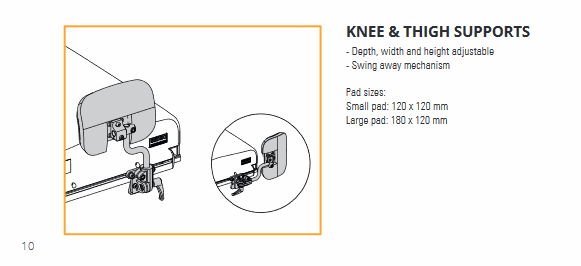

Going to get some of those knee or thigh pad thingies. On this Sedeo pro seating brochure. I usually have a "bumb bag" velcro strap etc around my knees to stop my legs splaying. (centre footrest causes that). But it leaves a mark around my legs...
Page 10. Keep trying to get a price but sunrise seem to go home at night!

Postby Burgerman » 11 Nov 2020, 12:27
No I am not. Not at 500+ a set approx! :argument banghead
I will make better ones for around 20.

I need them to flip up and down and be padded. But I will be doing something similar! I could actually do with in on all my chairs.

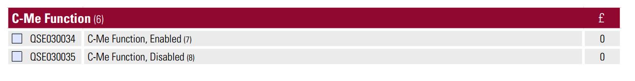

While examining the Q 700 ordering form one can either check QSE030034 C-Me Function, Enabled (7) or QSE030035 C-Me Function, Disabled (8). What does this mean? Thank you.

Postby Burgerman » 11 Nov 2020, 20:35
Post the full prescription form?
Never mind.
C-Me® enables you to elevate up to 12" while traveling up to 3 mph (weight limitations may apply). You can lift or descend at the touch of a button with no need to stop while transitioning.
I do wish they would stop with all the stupid marketing names and just say what things actually are.
Personally I wouldt bother. It feels like you are going to die sooner at great expense. And 3mph is mind numbing. Driving around on our uneven footpaths and pavements while elevated like a bar stool is NOT safe no matter what they say. I manage to tip them up regularly without the higher up barstool effect! Your mileage may vary! Might work safely inside a shopping centre. Again your streets may be a lot better than the ones I frequent. So its up to you.
Its pretty much irrelivant anyway. Its just programming. I think. You can change it (disable it) later if you wish so no reason not to have it if free...
