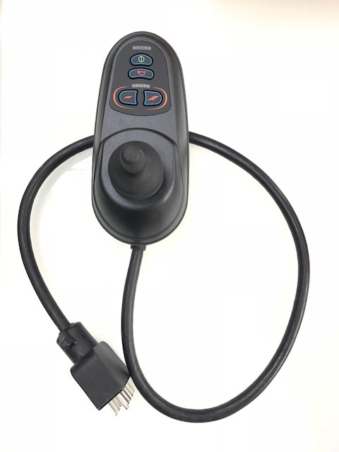

foghornleghorn wrote:The newVSI controller pictured is an all in one brain and joystick pod. No talking backwards and forwards from it to a separate controller.
I'm guessing you are in Singapore where this appears to be the commonly used control.
The simplest version of what it sounds like you want to achieve is 4 buttons:
1. Forward - both motors forwards
2. Backward - both motors backwards
3. Rotate the front of the chair to the right - left motor forwards
4. Rotate the front of the chair to the left - right motor forwards
I would have all buttons only work by themselves. Push one for a command to happen. Push two or more and nothing happens.
It may be better to have the left and right aiming send a time limited burst of power to the motor so one click turns 5 degrees for example rather than having the chair rotate forever if the button is held down.
One thing you need to be very aware of in an example where the driver doesn't have full ability is that an electric wheelchair can exert a lot of force on the person in a situation where they catch their leg against furniture or the wall. Broken bones happen very fast and heal very slowly.
LROBBINS wrote:No, you don't need to use RC. What you have to figure out are the X and Y voltage swings of the joystick pot inside the controller and make a circuit that mimics that. (One exception to this that I know of is the Dynamic Shark series which uses an digital rather than analog joystick pot.) That will be MUCH easier than trying to hack the serial digital signal (which may be of any one of a number of different protocols with a proprietary "dictionary" for the messages).

To see what the joystick pot does you have to open the case and find the wires that go from the joystick to the circuit board. If it's an analog joystick pot it will have one that's + supply, one that's ground, one (or two) that's a center tap half way between those, one (or two) for X output and one (or two) for Y output. The "or two" is because some pots have duplicate outputs that are used as a safety check that it's functioning correctly. Some fancier pots also have a separate output that is switched on when the stick is centered. Each output will = the center tap voltage when the stick is neutral and have a swing above and below that when the stick is moved. If there are two outputs for X (and for Y) they may swing in the same direction or swing in opposite directions. Chances are that this controller has the simplest pot available with just 5 wires: +, -, center, X and Y. In any case all you need to find out is a half-way decent voltmeter (and great care not to short anything when you are figuring it out). If there's actually a label on the pot you can search using the label information and probably find a data sheet which will tell you everything you need to know without even doing that. Then you have to design a switch interface that will produce the correct X and Y voltages.
LROBBINS wrote:The VSI almost surely uses one or another serial protocol to communicate with the rest of the system and hacking that may be a tall order. It may be much simpler to make an adapter that connects to the same leads as the joystick pot and mimics the joystick output. Do a search here for postings by woodygb to see how he's done that for using RC controllers to mimic other joystick controllers - yours will be similar. Years ago I had done something similar just using 4066 ICs connected to head and foot switches to select among a set of simple voltage dividers, but Woody's way is a much more flexible solution.
