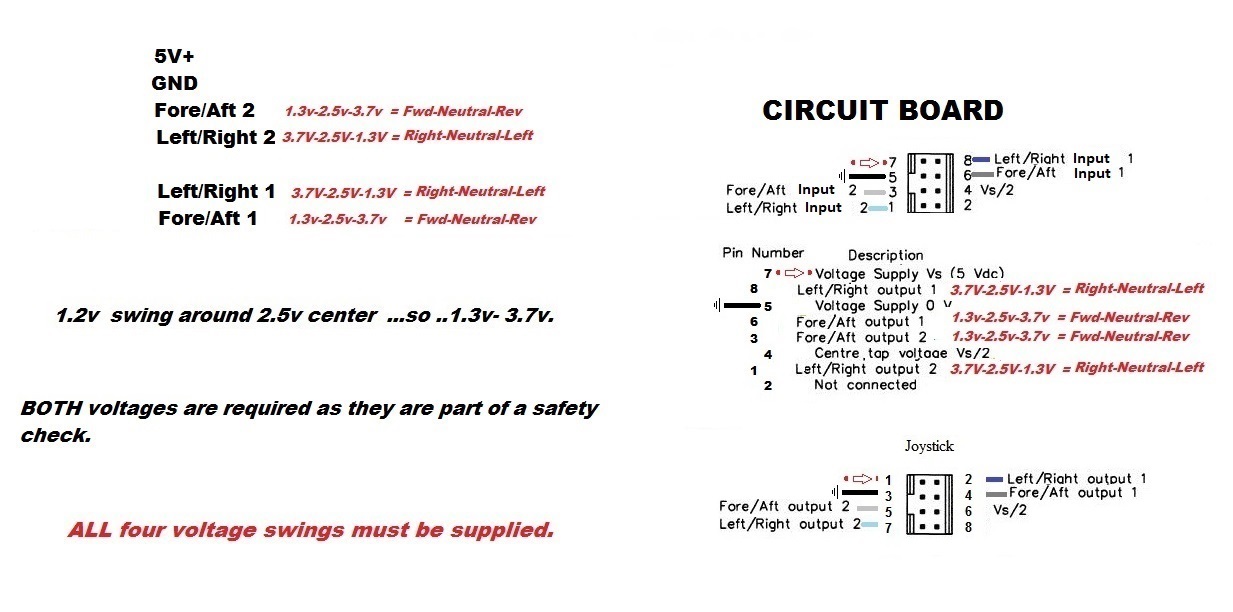

Postby woodygb » 27 May 2021, 12:45
The Vsi will contain a JC2000 or MAID joystick.
https://www.farnell.com/datasheets/30691.pdf
The easiest way in my opinion to control the motors is to emulate the joysticks output.
NOTE:- That each Axis ... X & Y ...has dual ( two ) voltage swings that must match each other within a set % .
The voltage swing is 1.2v - 1.3v each side of a 2.5v center.
Here is a vid of project that I did.... the PP3 battery holder contains everything required ...this being a 5V regulator , Arduino Pro Mini , HC06 Bluetooth module and a MCP4261.
youtu.be/KQy1xbo9tNE

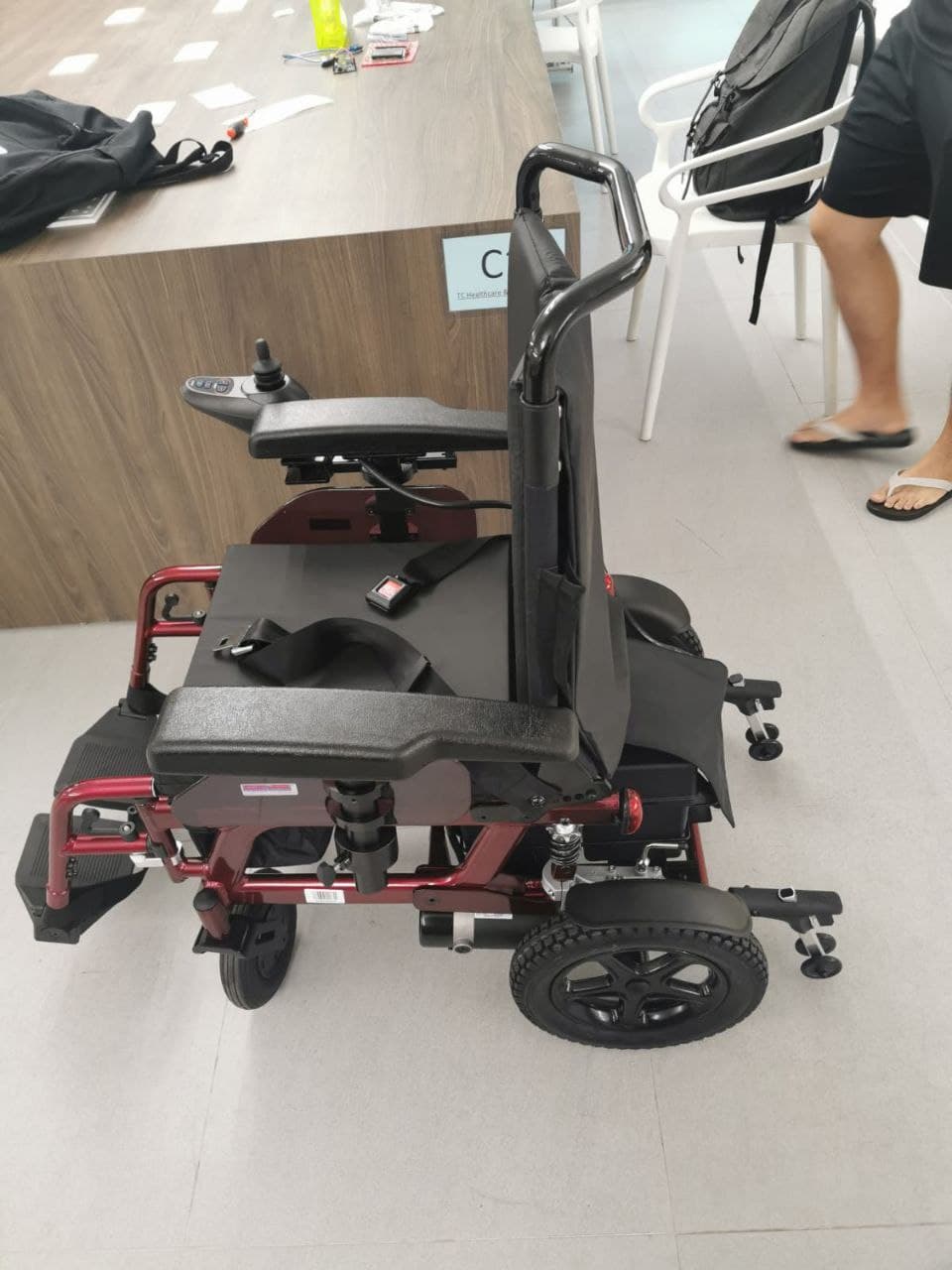

Postby nani13 » 29 May 2021, 09:49

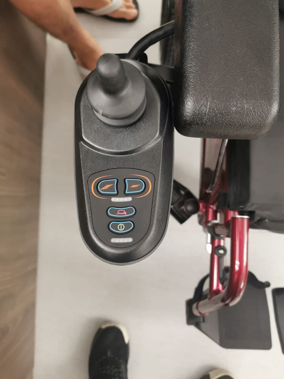

Update: Just received the wheelchair with the controller. Will be opening it up next week

Re: P&G VSI 50A

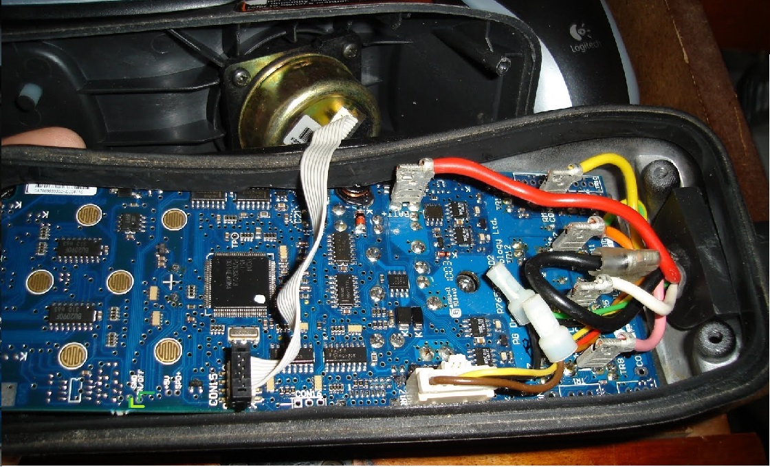

Postby woodygb » 29 May 2021, 10:16
It will look something like this inside.
Note this is the inside of an older 6 button Vsi.
Re: P&G VSI 50A
Postby Burgerman » 29 May 2021, 12:09
The arm tops are on the wrong sides!
Posts: 70432

Postby nani13 » 29 May 2021, 20:04

Re: P&G VSI 50A
Burgerman wrote:The arm tops are on the wrong sides!
It was delivered that way, might need to adjust it tomorrow

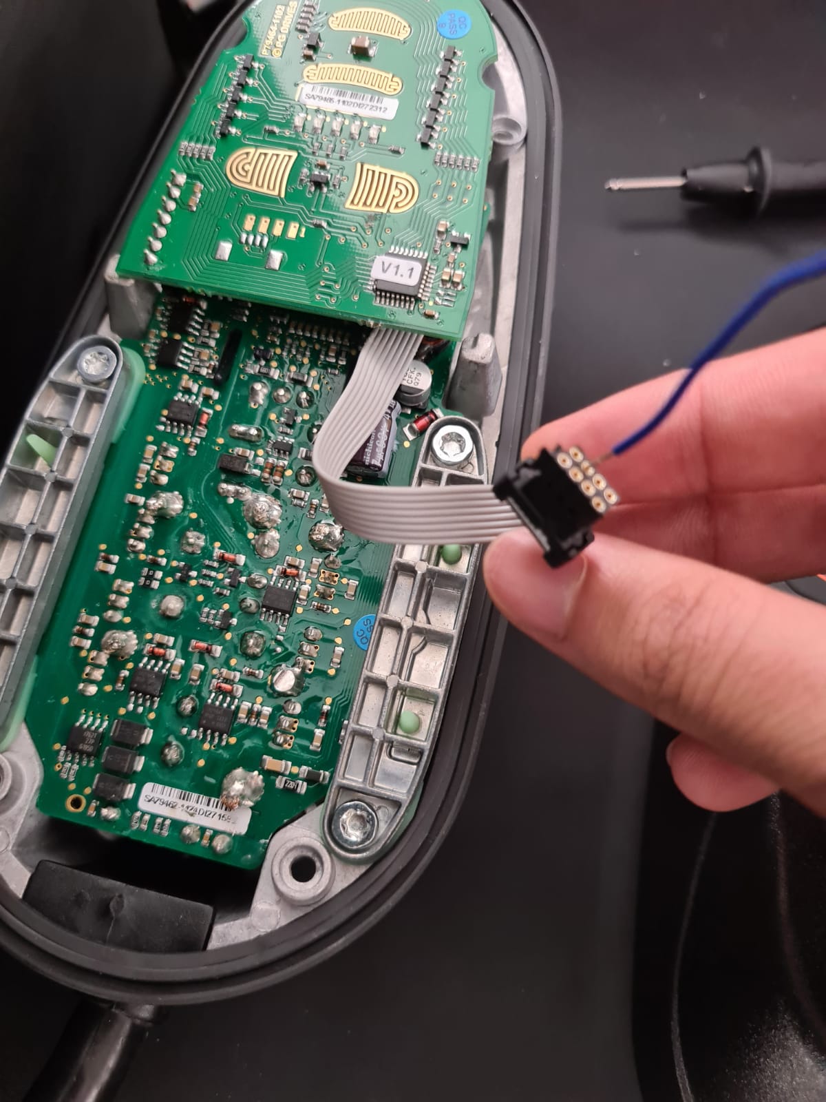

Re: P&G VSI 50A
Postby nani13 » 31 May 2021, 05:59
We have managed to open up the controller, but we are not able to measure the signal given from controller, do we desolder the PCB, or transfer the signal to a breadboard as middle ground to measure it. We measured pin 7 as common ground but we are not able to measure the other pins. The red, black, green, yellow blue wires might be on the other side of the board. Any advice will be appreciated thanks

Re: P&G VSI 50A
Postby Burgerman » 31 May 2021, 08:41
The info you need was already posted here https://www.farnell.com/datasheets/30691.pdf
You do whatever it takes to find out what you need to know to emulate the joystick. Whats stopping you measuring it?
Power the joystick and measure its outputs.
Take it apart properly, just to have a proper look. Then if theres no way to access the points you need to measure extend the joystick wires. Better bet bring it here and I will do it all for you! You already know what you need to know as woody posted this already.

Re: P&G VSI 50A
Postby woodygb » 31 May 2021, 09:52
Nani ...
Control systems with a separate power module have an easily identifiable signal wire ( or sometimes 2 wires ), the VSi is however an All In One controller and as such doesn't have any signal wire.
IF you have an electronics Guru you MIGHT be able to hack in at the boards component level...but I doubt it.
NO signals come from the board to the JC2000 ..only 5v and GND are supplied by the board.
So I.M.O. you either need to emulate the signals that COME FROM THE JOYSTICK ...or get a different control system with a separate power module so that you can attempt to decode the signal going between the joystick pod and the power module.
Woody

Postby nani13 » 01 Jun 2021, 06:57
woodygb wrote:
Am I correctly interpreting this, by sending 5V to the joystick, pin 1 and 3, we shall in turn receive the respective output voltage at pin 2,4,5,7 depending on joystick direction?
nani13

Postby woodygb » 01 Jun 2021, 08:12
nani13 wrote:

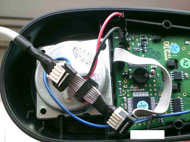

Re: P&G VSI 50A
Postby woodygb » 01 Jun 2021, 08:25
Ribbon
https://www.digikey.ca/en/products/deta ... -R/2391672
Does your ribbon cable unplug from the pods board?.... if so , check VERY CAREFULLY how the 8 pin sockets are crimped to the ribbon cable.
Why? .... Because the numbering system from one end to the other of the ribbon will have changed IF the connectors have been crimped facing opposite sides of the ribbon.

Strange question to ask about the ribbon pitch ...measure yours and tell me what your ribbon pitch is.
The 4 voltages ( 2 off X & 2 off Y ) MUST be 2.5v at start up AND Vs/2 must also be 2.5v.
This might help you ...

I have my interfaces EXTERNAL.
