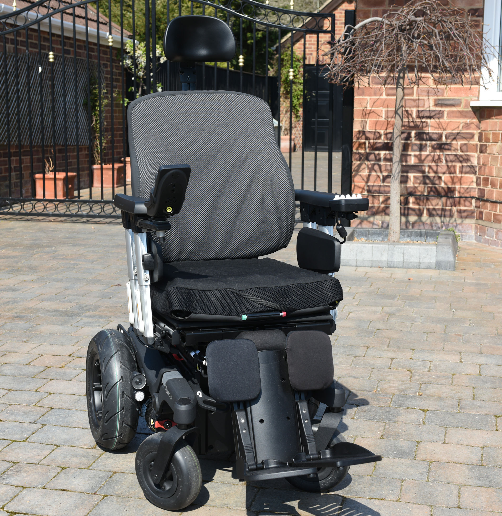

The Q700R has been modded and finished. Other than 200Ah lithium.(I will do the Salsa and the Q700 at the same time. I have only tested it 5 or 6 times indoors, and up and down the street and in the driveway, and once into town and back. It still needs a bolt for the van. As does the Salsa.
Works OK. I dont like that stupid swinging rear axle (sprit level technology!) thing. I am going to bolt it up solid. Which is simple to do. It still has 4 wheel independent suspension. That swinging thing is marketing bullshit that makes the chair behave weird! It was a great idea when the stock chair is super nose heavy. The chair angle tries to follows the level of the ground that the FRONT casters and all your eight were/are on. The swinging rear axle thing allows the rear tyres to maintain ground contact.
And when you move CG back over rear wheels thats wrong! When you fix the daft CG issue that all rear drive chairs have from new, it doesent work.
The original idea was that on the usual wildly nose heavy chair, instead of lifting a rear wheel of the deck over a tree root, or uneven surfaces or at the top of a ramp and turn, and losing traction/control. The rear swinging (spirit level marketing) axle moves to maintain rear wheel ground contact and so control.
But its not needed with centre footplate and seat located rearwards. Because its a CASTER that lifts in those situations. You are sat over the rear. Which doesent matter. The 4 wheel independent suspension takes care of that anyway. What it does do is allow "body roll" like a car. As now the casters (and so chair angle) have less weight over them. So it feels odd. When I get chance, two M8 short bolts will cure that! :shifty:
Other than that it feels EXACTLY the same as the Salsa.

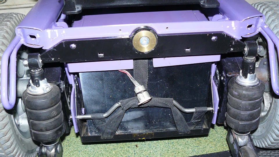

hi bm you just answered a question before i even asked it!i was just about to post asking about this same suspension but on a puma and i wanted to ask if its a good idea this swivel arrangement or if i could just bolt it rigid,this is the puma 40 rear system complete with fake rubber shocks,which are going in the bin shortly!
but is this same as you mention?

Postby Burgerman » 21 Mar 2021, 23:12
Works the same way yes. The Q700 and 500 F and R chairs are a similar design as they are basically newer versions based on the old puma you have. lthough the parts are very different. Maybe the shocks from a Q700 might fit. https://www.sunrisemedical.co.uk/powere ... -sedeo-pro

Postby LROBBINS » 22 Mar 2021, 10:53
Duke,
You think that rubber donuts are "fake" shocks, but the Mooney series of light aircraft very successfully used them. Chosen with care, rubber of the right formulation, and not age-hardened, can be a pretty effective way of converting mechanical stress into heat which is what any shock absorber does.

Postby Burgerman » 22 Mar 2021, 11:48
As used in the original mini, and in the many trailer suspension systems. Even used on some hgv trailers.
But they may be too big as in too high for the job. So lower rating ones need to be used. On some chairs they are chosen by the prescription order form. By reference to the user weight/seating options. So maybe lighter ones are available.
Much of the problem with wheelchair suspention though is that it has limited travel. Frequently under an inch.

So does the Q500/700R you choose which on the order form. But the smaller tyres allow a better seating position. So that you can drive forwards instead of reversing around everywhere as you do in the 500F :fencing

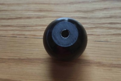

I have just received Q700R wheelchair and have to do a lot of adjustments. One of them is fitting a joystick Knob, Ball, Ø 35 mm ordering number QSE090508. I ordered this item with the chair as an option and thought they were going to mount it but the joystick came like this picture
. What should I do to mount this joystick knob ball? Do I have to cut the rubber and press the joystick ball knob onto the joystick?

Postby woodygb » 29 May 2021, 08:30
Twist and pull ...it is a simple push fit.

If you ordered this with the chair I would ask why its not fitted!
As above. Looks to have a metal insert already to push on?
But if not already drilled:
If you want to do it yourself then carefully remove the existing one. Measure the steel shaft diameter with vernier calipers (ebay digital vernier and these are now cheap). Then I cant see from the picture. If theres already a hole see if it fits. If no hole order a drill a few fractions of a mm (maybe .1 smaller) and drill it. It should now push on. IF its rubber. If its hard plastic you will need to drill the same sized hole and ise some loctite or something. Or drill a small M3 thread hole and tap that for a grub screw.
Posts: 70467
Postby rover220 » 29 May 2021, 08:41
pull standard knob off :shifty: and push ball in, could be no simpler.

rover220 wrote:pull standard knob off :shifty:
That could be painful! :oops: :lol: Especially if they have tight suction holding them on like my C38 knobs.
Postby Scragger7 » 30 May 2021, 05:54
rover220 wrote:pull standard knob off :shifty: and push ball in, could be no simpler.
Exactly.

Postby Burgerman » 30 May 2021, 10:18
If its an official PGDT one thats the case. If its an aftermarket one it may be drilled with a small pilot hole only. I have seen one of those too. So it can be drilled to fit various sized joysticks. But he ordered it with the chair, I think. So it will be a tick, on the prescription form, so a genuine part. And SHOULD have been fitted on arrival. But also should be plug and play DIY - quite literally.
Posts: 70467
Postby rover220 » 30 May 2021, 10:49
The one in the picture is a proper pgdt one with the shim.

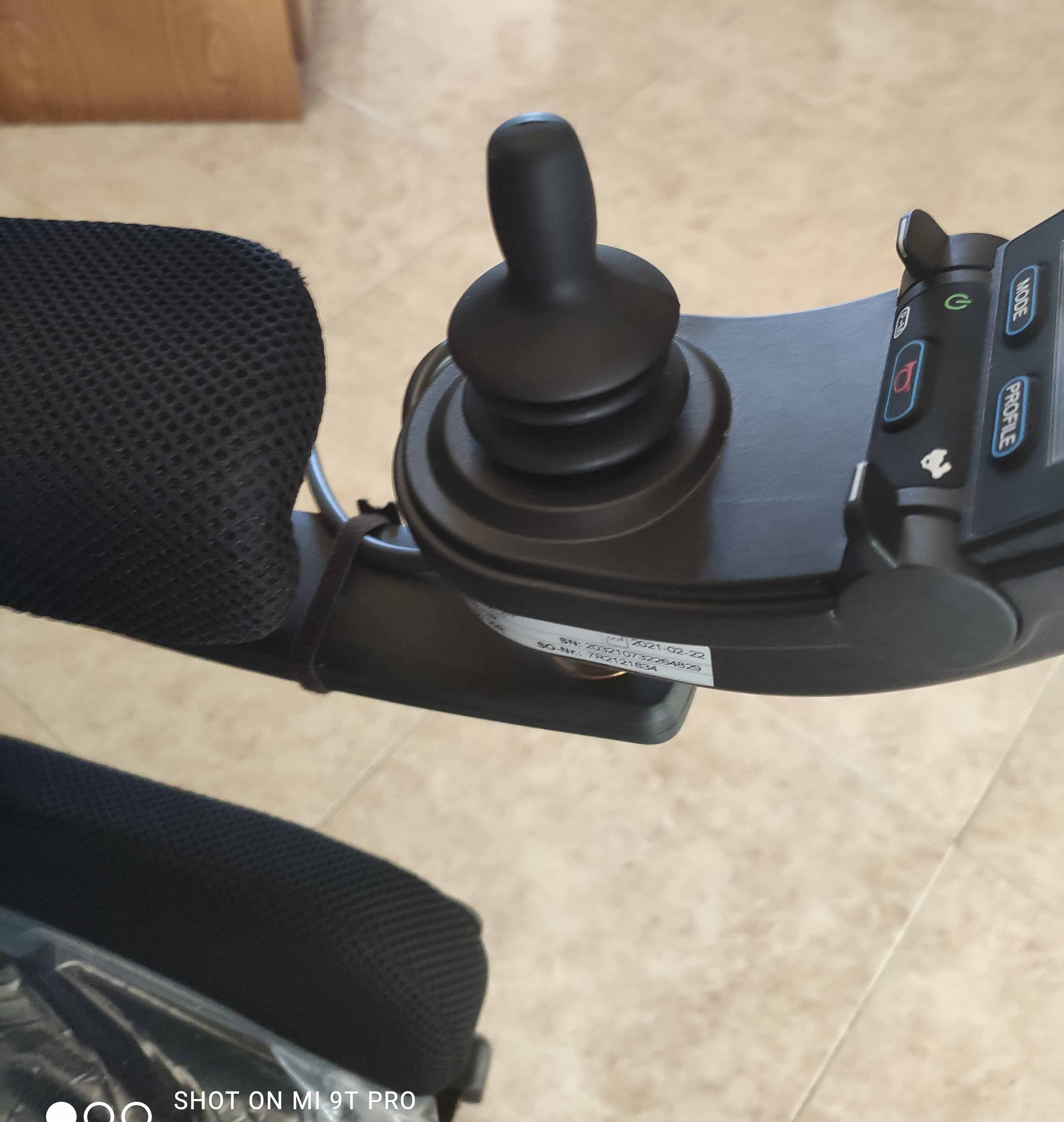

Postby Burgerman » 30 May 2021, 11:20
Joystick looks much too low.

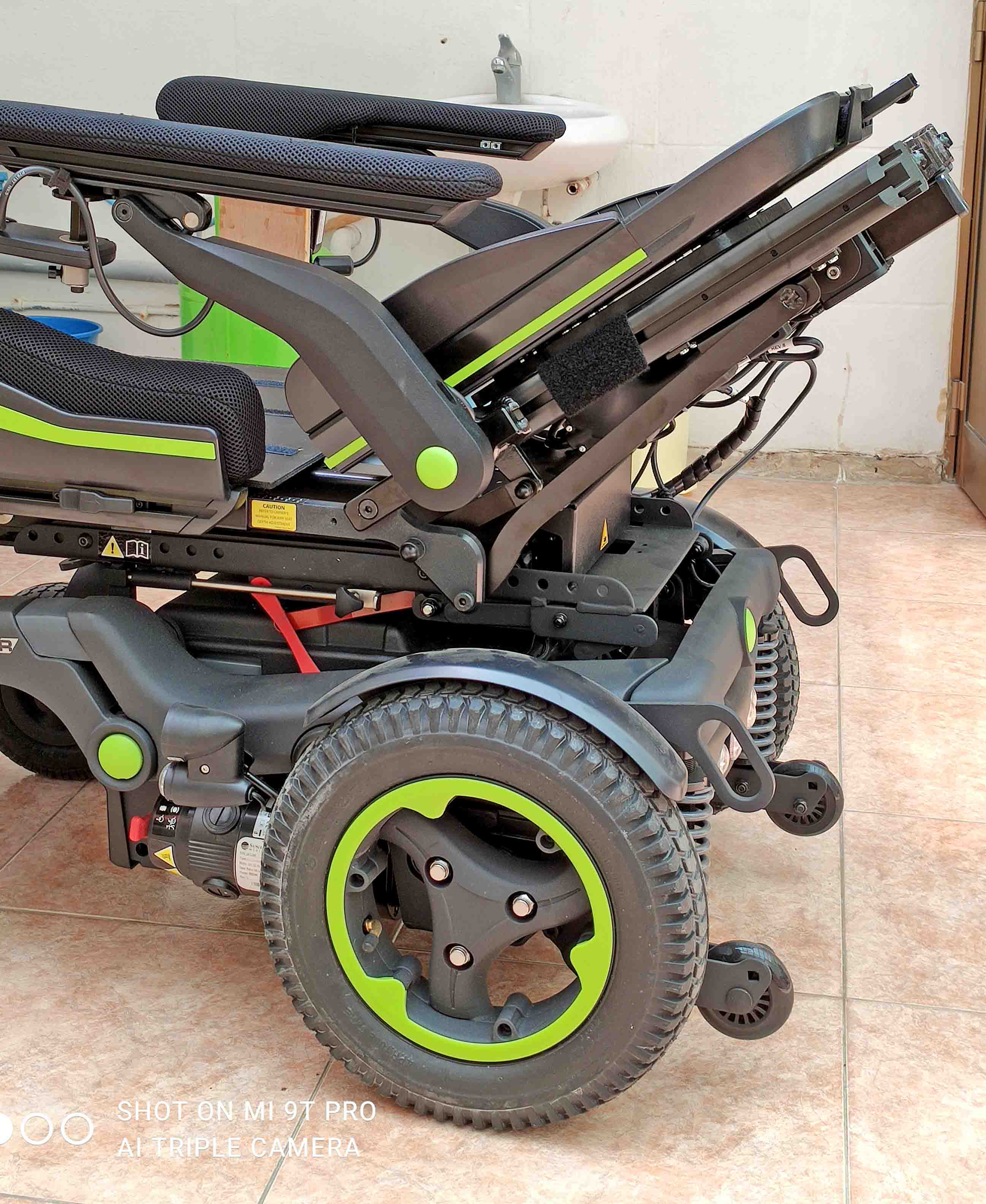

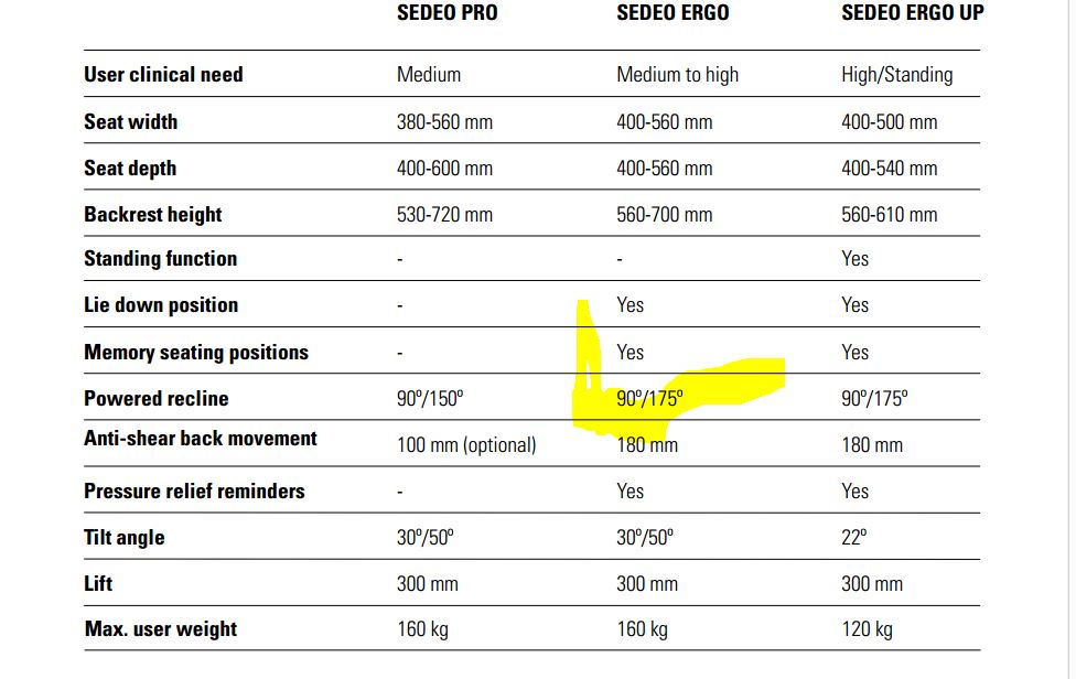

I refer to Q700R chair with Sedeo Ergo seat which I recently got and was disappointed to discover that the backrest does not fully recline as advertised, see picture. I tried to change the profile regarding the recliner to make it recline more but was unsuccessful. Does anybody knows what to change in the programming to make it fully recline to 175 degrees? Or anyone has an already modified profile that can share with me?
I thank you in advance for the help you may offer.

Postby Burgerman » 08 Jun 2021, 22:51
No idea about ergo seating as I dont have it. Why do you think it goes to 175 degrees? As far as I know the only one that does that is the Ergo UP (stander) version at a silly price.
I can see the seat needs to go back around 7 bolt holes... It it will steer like an oil tanker.

Postby Frank » 09 Jun 2021, 03:20
The Ergo seat should recline flat as in the picture.
I already moved the seat back but left 1 hole because the footplates hit the tyres.

Postby Burgerman » 09 Jun 2021, 04:10
Well then I am not sure. It may well be in programming. But its one of those things where you need to be there to do a bunch of tests to figure it out.
Send me a copy of your settings and I will see if anything looks obvious.
Footplate hitting tyres can be helped with the smaller tyres I fitted, and throwing away the mudguards as they act like 11inch wheels and hit first!
You only gain an inch. But thats worth having.

Postby rover220 » 09 Jun 2021, 05:59
it should lie flat, looks like seat depth is short which will limit it iirc
