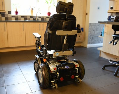

invacare storm
The new storm 4 like my one? Or the old storm that we havent had here now for decades?
This is the storm 4 explore. Below.

The storm once configured as a powerchair isnt bad other than its damned brushless motors. But they figured out I was right and thats now normal 4 pole. No more brushless disaster. So as long as you can put up with its new LiNX controlls should be OK. Personally I would retro fit R-Net... EXCELLENT ride. Better than any chair I tried. But it weighs 192kg.
