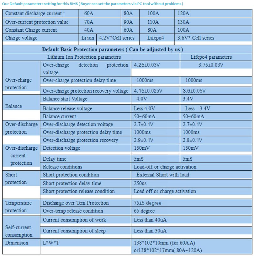

Postby shirley_hkg » 30 Aug 2021, 00:26
terry2 wrote:
steves1977uk wrote:This one looks interesting... https://github.com/Green-bms/SmartBMS
Terry, what's the balancing current on the OverkillSolar BMS?
I can't get in to the android app to see as I don't have the BMS
https://github.com/FurTrader/OverkillSolarBMS
drunk2
Posts: 4454

Shirleys drunk again. But posted a blue spec sheet.
That BMS which is the same as the Overkill Solar marketed version, lets your cells reach 3.75V plus or minus 0.03V and 1 second (so likely nearer 3.85V) before cutting off all charger power with its on/off overvoltage switch. Then it uses its totally feeble balancer of just 50 to 60mA to drag it down to 3.5V. (best of luck with that!) Then it adds the charger full power as it cant throttle it and does it all over again. And again. So its EXACTLY as I said. Only its even worse! At least the cheap nasty ones like the one on my dell laptop battery (all 3Ah of it) has a 100mA balancer!

Postby terry2 » 30 Aug 2021, 06:59
drunk2
That's not not the one with overkill settings flashed.
Re: Revolectrics
Postby terry2 » 30 Aug 2021, 07:01
Burgerman wrote:Shirleys drunk again. But posted a blue spec sheet.
Again since you're too lazy to do your own home work.
https://overkillsolar.com/support-downloads/
That's their own settings files which you flash to the BMS.
Nothing like above pic.
Again. Their BMS uses the very same minute surface mount resistors to try to balance. Anything more than 50mA will send them to heaven. You do not have any clue. And I read that pdf a long while ago. They dont tell you anywhere in it the balance current because it is embarassing for them. They just have 100 excuses about why it will only balance certain super high quality cells and only if YOU balance it properly yourself before you assemble the back. Its a sad joke. Again a triumph of marketing over ignorance
