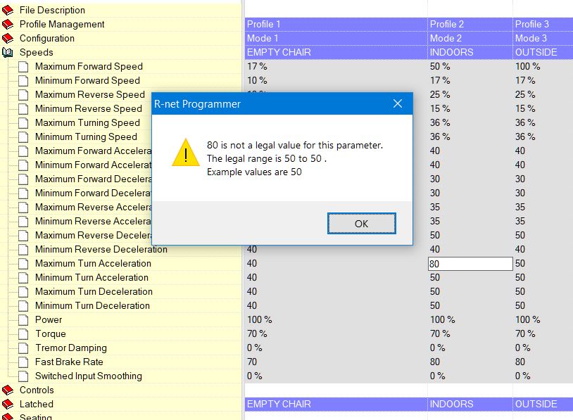

Postby Frank » 11 Jun 2021, 11:29
Thank you for your suggestions and I understand what you want to say. However those were the settings that came with the chair and I am still programming it. I upload the latest settings and they are still not final. I turned all settings you suggested to 50 because they put a limit and I can’t go over 50, please see the screenshot. I wish I would find where I can remove their inhibit.
I do not have normal hand control but still find a way to have some control but not as much as I want.

Postby rover220 » 11 Jun 2021, 13:35
Frank wrote:Thank you for your suggestions and I understand what you want to say. However those were the settings that came with the chair and I am still programming it. I upload the latest settings and they are still not final. I turned all settings you suggested to 50 because they put a limit and I can’t go over 50, please see the screenshot. I wish I would find where I can remove their inhibit.
You need to go into oem factory header and max the settings bedore you can change what you are trying to.
Postby Frank » 11 Jun 2021, 14:37
Thank you Rover, I did that and it's OK.

Postby Burgerman » 11 Jun 2021, 16:47
Dont forget that once you set all the turn accelerations and decelerations to say 80 to 100 you must disable the gyro. Or it will be terrible and jerky!

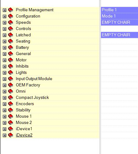

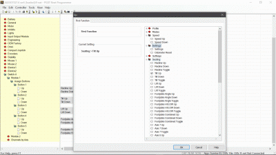

I refer to the Ctrl + 5 switch box, I understand that one can assign a different function to a button. But I cannot see any Assign Button programming in my settings. Does anyone know how to do? Thank you.

Postby Burgerman » 11 Jun 2021, 19:49
Yes its rght at the end or the programming list. On mine.
Beware, motor compensation set to high for your chair.
AX20070214 ver5 (loaded).R-net
(4.37 KiB) Downloaded 135 times
Posts: 71087
Postby Frank » 12 Jun 2021, 08:37
I will check again and make sure that motor compensation is set at 40.
Regarding assign buttons here is my list. You said it’s at the end of your programming list, what is the name of your list where you have the assign buttons? Thank you.

Postby Burgerman » 12 Jun 2021, 09:02
Switch-it
As in the file I posted above, right at the bottom.
I dont understand why you are not seeing that in your file.
Did you download your settings file to the desktop? And edit it?
Posts: 71087
Postby Burgerman » 12 Jun 2021, 09:05
You ARE using the SUNRISE OEM version of the software right?
I see it in the FIRST file you attached on this page. And then its missing in the s.r-net file you atached later.
Posts: 71087
Postby Frank » 12 Jun 2021, 13:39
BM, now I figured out why certain settings were missing. I also had the generic software and probably I used that to open the settings. Now I am opening the file with the OEM software and those settings are showing up. So with your help I managed to solve this mystery, thank you so much.
I understand to change the function of the CTRL+5 box’s buttons I have to go to the heading SWITCH-IT. Right?

Postby Burgerman » 12 Jun 2021, 14:42
Look carefully.
download/file.php?id=15836&mode=view
Thats why I posted this screenshot.

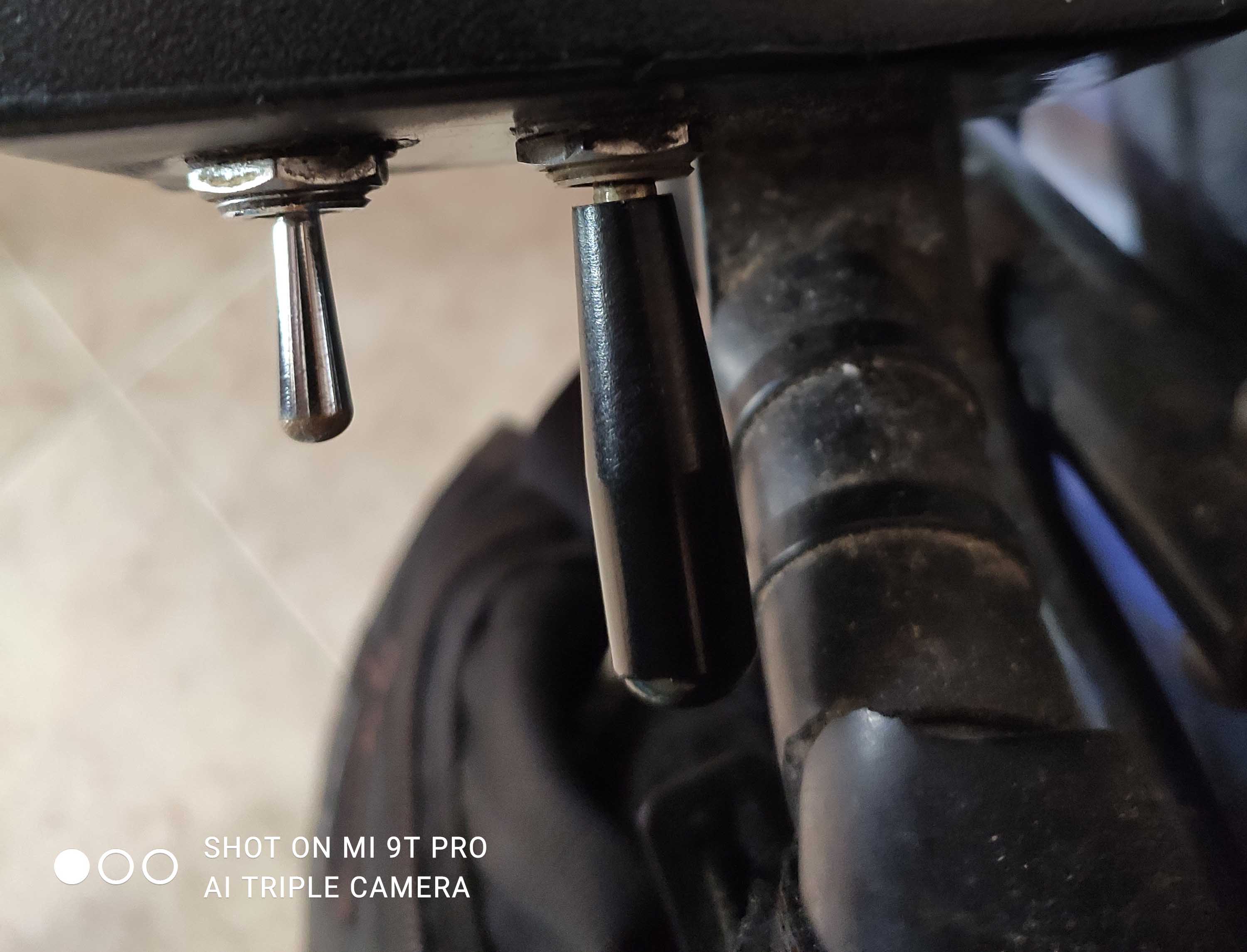

Postby Frank » 17 Jun 2021, 16:19

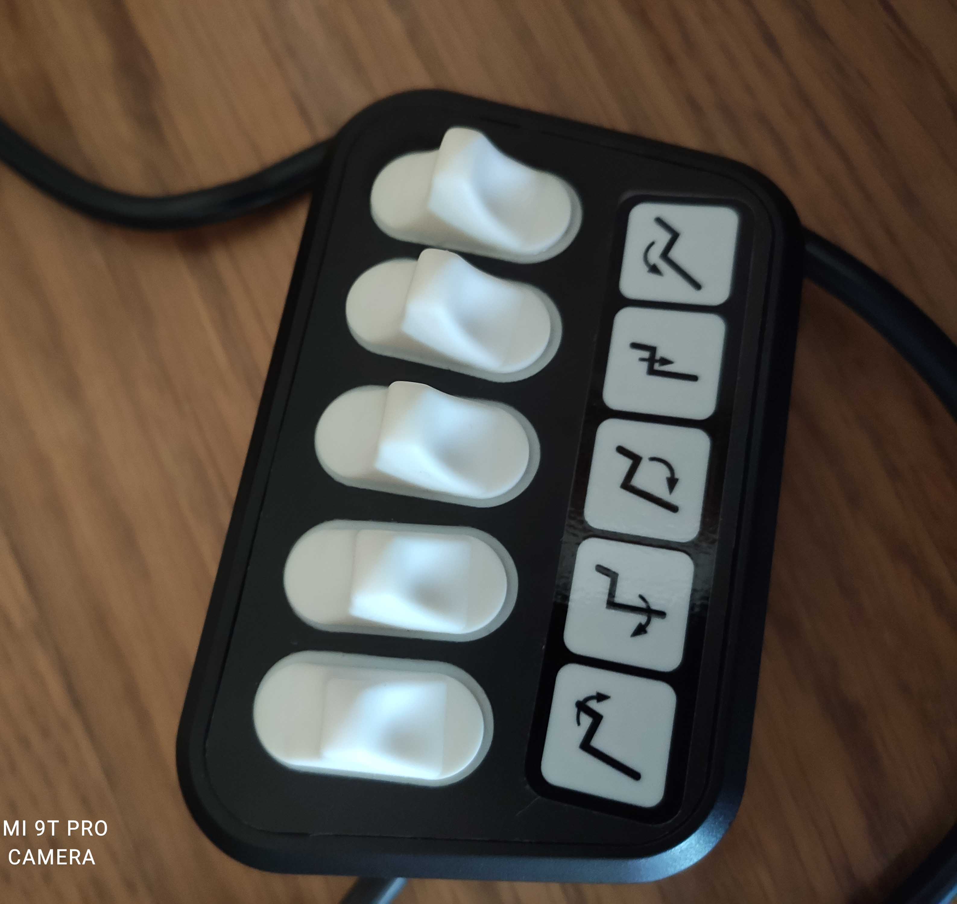

I refer to the CTRL + 5 switch box. I have one with toggle switches. I want to attach an extension to these toggle switches so it will be easier for me to operate them. Has anyone opened one of these boxes? I want to know if there are small metal levers (like those found on toggle switches, please see the second picture) under the white rubber/plastic cover? And can the white rubber/plastic cover be replaced if damaged?
As always thank you for your help.

Postby Burgerman » 17 Jun 2021, 23:03
No. And no at least by you as parts unavailable. And the price of that part is 700 dollars...

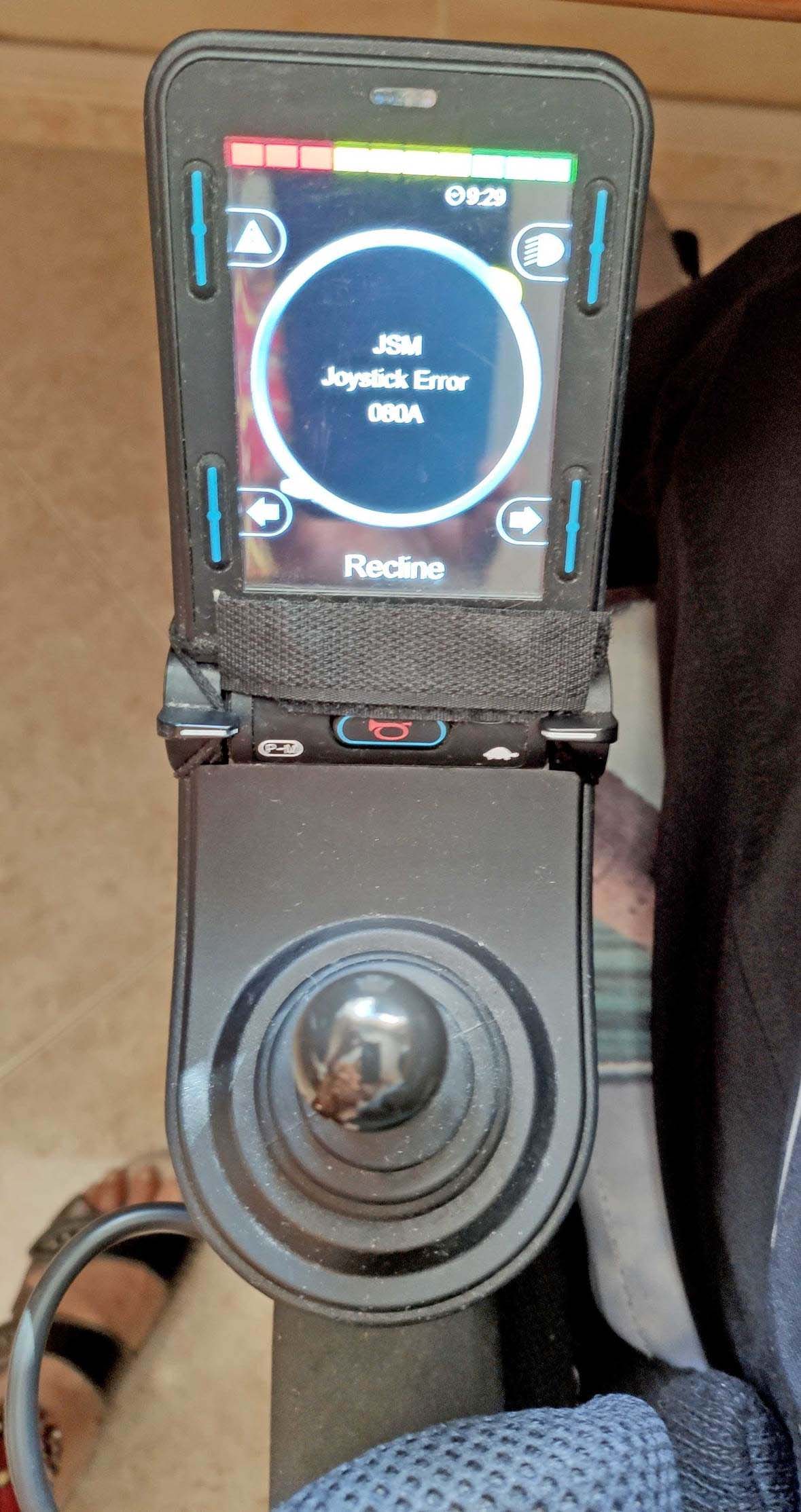

Postby Frank » 03 Jun 2022, 10:59
I am having JSM joystick error 080A. This error is not happening because I am touching the joystick while switching on the control box. The control box may switch on well but after a while this error comes back. When the control box switches on correctly and I drive the chair and release the joystick the chair stops but after a while the chair MAY start to move slowly on its own. So sometimes the joystick is not holding in its center and this is very annoying and can be dangerous. I checked the plug of the joystick for looseness and made it tight as much as I could. It may work good for some days but then the problem comes again. Has anyone experienced this type of joystick problem?
