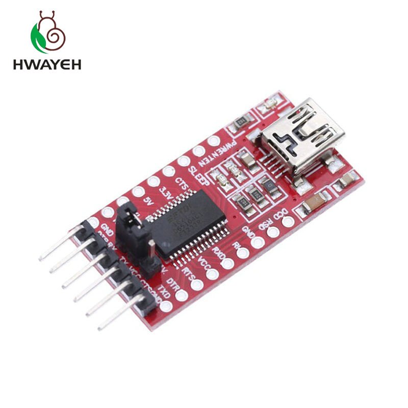

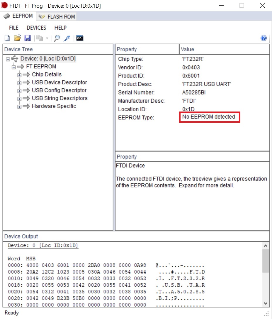

Actually it looks like this FT232RL board is not programmable. I can connect to it using the FT_Prog Utility software, and I can see it when I do the "Scan and Parse" function, but it says "No EEPROM Detected" and when I check the two boxes for inverting the RX and TX and then program it, when I scan it again right after it doesn't have them checked anymore. I also tried changing the PID with the software just to see if that would stick and it didn't either.
...That board is using a FAKE FTDI Chip.... A50285BI
http://www.starlino.com/ftdi-chip-real- ... thers.html

Postby woodygb » 18 May 2021, 15:39
If it's a cheap FTDI then it is almost certainly a FAKE.

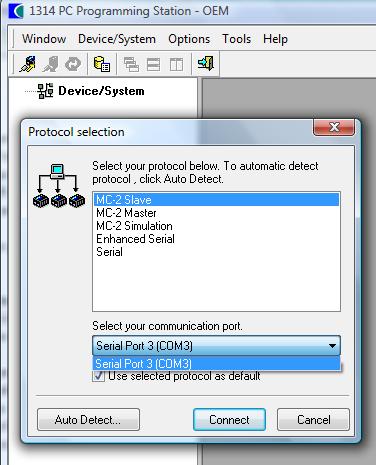

Postby FL1PP3R » 29 Oct 2021, 13:55

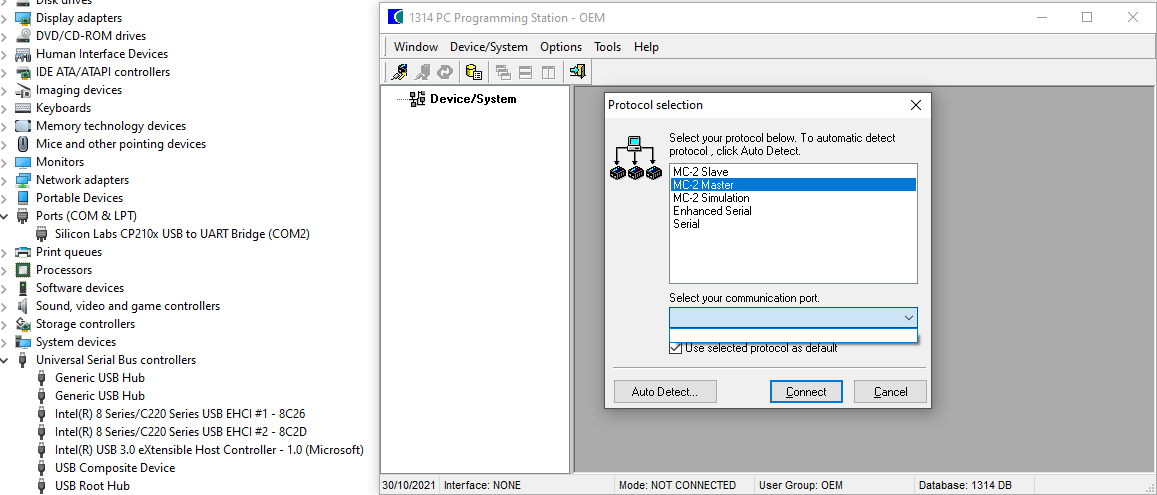

Hey Everyone,
It's been a few months but I'm finally having a go at connecting to my ctldc1466 with the 1314 pc software and I think I may have run into some issues. Firstly, do I need to have the controller connected to the USB-CAN tool for the 1314 software to recognise a com port?
I've installed 1314 PC Programming station version 3.12, I have what I think is the correct A+ USB CAN tool, I have replaced my LXNpy2s.dll file with Woody's version, and have added the QM_USB.rar file to the program folder also. When I look through the software provided with the USB-CAN tool the closest thing I can find to QM_USB.rar is LM_USB.rar, I have tried renaming the provided file from LM to QM with no success.
I can start the 1314 pc software and connect to the MC-2 simulation; however, I cannot select a com port in any connection mode, the 1314 software does not seem to recognise any com port at all. I have tried reassigning the com port in device manager for the Silicon labs CP210x USB to UART bridge with no success.
I'm sure I'm missing something basic, but I thought I'd ask the experts here before I start purchasing more hardware
Thanks in advance
FL1PP3R
FL1PP3R
Posts: 9
Joined: 02 May 2021, 01:51
Postby woodygb » 29 Oct 2021, 14:01
Simply plugging in the A1 CAN USB should give you a Com Port....what COM PORT does Windows Device manager say?
You are correct in the need to use LM_USB RENAMED as QM_USB.
NOTE THAT THE 1314 SOFTWARE DOESN'T RECOGNISE COM PORT NUMBERS ABOVE 8 ...or was it 10 ...I cannot recall exactly.
Postby FL1PP3R » 29 Oct 2021, 15:07
Thank you for your help with this Woody, the very quick reply is much appreciated
Device manager sees the USB-CAN A1+ at COM1 now, I've reassigned it between COM1, COM2 and COM3 with no success.
Whenever I try to connect with anything other than MC-2 Simulation I get a "list index out of bounds" or "E0023: Initialisation of communication interface failed" error message.
Other than uninstalling everything and starting again from scratch I'm not sure what other options I have.
Thanks again

Postby woodygb » 29 Oct 2021, 15:30
Does the 1314 software see the COM Port?
I assume that you have the controller turned ON ?

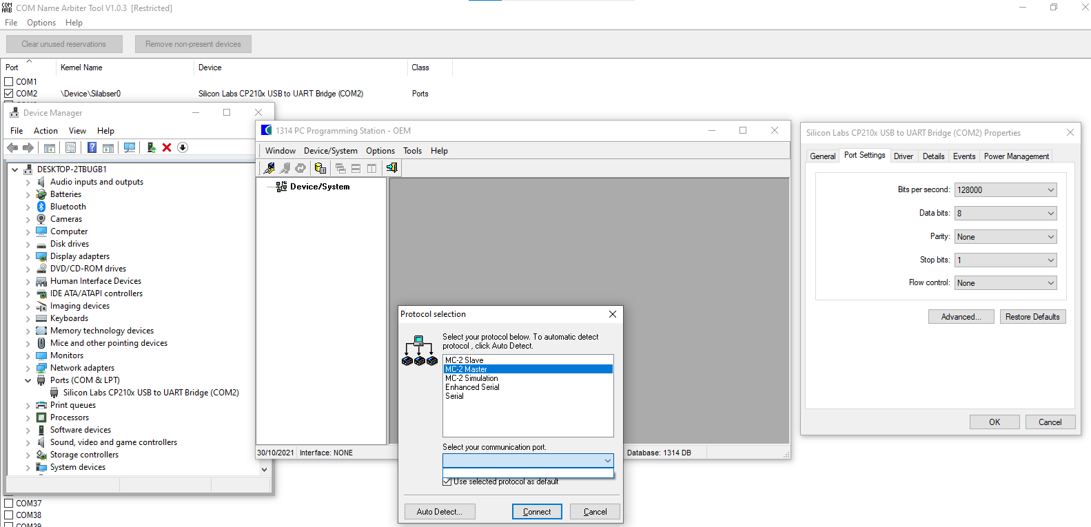

Postby FL1PP3R » 29 Oct 2021, 23:17
The 1314 software does not see a com port at all. I've tried with the controller on, with the controller off, swapped CAN-H and CAN-L, reassigned com ports, replaced the LXN4py2s file with the downloaded one from this thread, replaced QM_USB with the renamed LM_USB supplied with my device.
I've attached a screen shot of the 1314 software not seeing a com port at all, while device manager clearly shows it on com 2.
What else should I be trying?
FL1PP3R
Posts: 9
Postby Burgerman » 29 Oct 2021, 23:32
Go to device manager. At the menu at the top choose SHOW HIDDEN DEVICES.
Now start at the top, go through every device and delete every last one that is greyed out. Its safe. All of those are devices not connected.
Restart.
Try again with installing your driver and running the software.
Alao, What does this little program say? You need to run as administrator to actually change stuff.
ComNameArbiterTool.exe
(51.53 KiB) Downloaded 116 times
Posts: 69671
Postby FL1PP3R » 30 Oct 2021, 00:15
Thankyou for your help Burgerman, I've deleted all of the greyed out items in device manager, uninstalled the driver for the A1+ USB-CAN, restarted my pc and ran the program you provided, unfortunately it hasn't fixed my issue. Hopefully someone can spot something in the attached image I need to fix.
FL1PP3R
Posts: 9
Postby woodygb » 30 Oct 2021, 00:45

woodygb wrote:The USB 1309 is FTDI based but it is given it's own Curtis specific VID and PID (vendor/product ID) ... USB\VID_1FA1&PID_00C8 .
It's possible to reprogram the FTDI Chip with this 1309 Curtis custom VID/PID using http://www.ftdichip.com/Support/Documen ... elines.pdf.
I have done this myself and although I can communicate with a controller the access level is defaulted to USER as there is still an error....this appears to be down to Curtis programming the chip with a specific I.D. identifier.
The 1309 config is also "silent" so you don't realise what is being installed as the "Wizard" display is turned OFF in a small file called DPInst.xml

The latest Curtis 1314 software only supports a 1309 as a USB input .... the 1309 also has the access level embedded / coded into it for the latest 1314 software version.
So it is simple enough to change the VID and PID , but unless you change the other code you will only get very limited programming level access.
The chip/cable that I recommend uses a 3.3v UART SIGNAL ... a 5v UART has not worked for me.
So ...it's possible to make a "clone" of the genuine 1309 and, together with a registry hack , set up ALL access levels.
NOTE:- I will NOT reveal ALL the ACCESS levels hack codes as they are beyond the need for reprogramming a Wheelchair.
Feel free to P.M. or email me.
