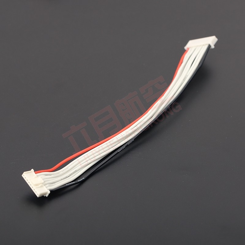

Is the double ended one male to female, or male on both ends?
I like to leave a lead permanently in the pl8 and connect to that instead of wearing out the pl8 socket and this looks ideal. Could also cut one end off to make a longer cable up.
10 x male to female lead posted to the UK - how much paypal shirley?

I'll send money when they are confirmed as definitely male to female as can't tell from the picture.

Never saw a double male end lead ever.

Postby shirley_hkg » 10 Oct 2021, 12:24
foghornleghorn wrote:
10 x male to female lead posted to the UK - how much paypal, shirley ?
HKD $186.
Postby shirley_hkg » 10 Oct 2021, 13:27
foghornleghorn wrote:Only interested in 8s for wheelchair charging. Any of the multi boards has always seemed like extra for no point and ….
Have to make your own, by T-joint the females to a JST pigtail.
Postby shirley_hkg » 10 Oct 2021, 13:39
HKD $186.
That's a male to male one .

Shirley I'd like to get 10 of the pigtails if possible please. Male (the one that goes into the pl8) on 1 end. I'll refit a JST-XH on the other end. I think you have my address. If you can confirm the cost with shipping to the US, I'll paypal you the funds today!

Postby shirley_hkg » 11 Oct 2021, 01:00
Arima wrote:
Shirley I'd like to get 10 of the pigtails if possible please. Male (the one that goes into the pl8) on 1 end. I'll refit a JST-XH on the other end. !
Please send another HKD $100 and you'll have them with your ZXD together . cheers

Postby shirley_hkg » 24 Oct 2021, 11:44
As PL8 discontinued so is its related parts.
Seller has not enough pigtails , so you will receive 5 pairs of these below . drunk2
Hope you don't mind . cheers
