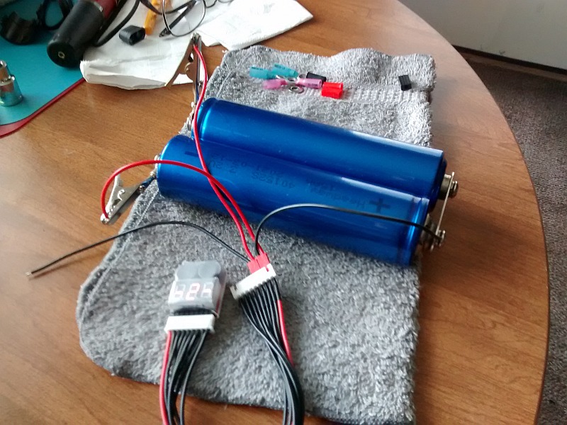

40152 cells finally arrived. The orange connecting blocks do not slip nicely onto the cells. The only way I'll get these on is to use a clamp like a press. Is this normal or do i have the wrong blocks? They are not far off from being a good fit but I can easily see one of the blocks splitting.
Thxs

Postby Burgerman » 23 Sep 2021, 19:19
All the ones I ever bought were a tight hand push fit. Needed a ligh tap with a hammer when doing many at once.

Even after putting a clamp on these would not go together. Didn't realize there are 38120mm cells also. Put the ruler on it and these assembly blocks are definitely 38mm. How it is I have so much bad luck. Hopefully evassemble will send a rush replacement.

This will be an add-on pack. 40152 cells give me the size and weight I can handle. My brain won't commit to a full lead replacement until I live with these and experience the use pattern. I realize this is not the most efficient configuration but it will be a great experience for me.
Not fond of things hanging off the back of my chair so I'm considering a 2in aluminum box enclosure under the butt cushion.

Headways are OK for that. Higher C rated.
Ah. The clue is in the name. 38 x 120mm. So you have the 15Ah ones?
Posts: 70452
Postby Arima » 24 Sep 2021, 19:57
Yes 15Ah. Hopefully I don't suffer the deep discharge dilemma.

Burgerman wrote:Buy metric allen screws. Stainless. Dont use the split shake proof washers only flat washers.
I think you are telling me the screws that came with the cells are to short? Been waiting weeks for the correct orange assembly blocks and bus bars. Figured I would measure the screw length after mocking up the pack with all the terminals connected. Seriously doubting if the correct parts are ever going to show up. So what is a replacement for bus bars...all I can think of is wire with terminal ends? When packing the cells is it okay to have them touching each other...or they need a millimeter between each? Still looking for a box (to hold the cells) that can be sat on.

They should not touch. The can is connected to the negative. I am telling you to use allen bolts, the correct length with some blue loctite, and only use a FLAT washer. You could use terminals for every connection. And some cable. Very much work...

Okay no touching! I can get bolts. Curious why the button head screw style is less desirable? Yes terminals would be a pain in the ass.

Postby Burgerman » 05 Nov 2021, 20:20
They come loose as the battery flexes and bets banged around. And you cant get them reliably at the correct tightness. They are cheaply made. Allen bolts are better. They need
to be surgically clean connections and threads locked. Or you will get issues.

Burgerman wrote:They come loose as the battery flexes and bets banged around. And you cant get them reliably at the correct tightness. They are cheaply made. Allen bolts are better. They need
The threads on my cells are filthy. I don't like the idea of running a tap in and out...the material feels soft. Can I use a brush like this...https://www.amazon.com/gp/product/B0719 ... LB5XE4F35P or would brass be better?
Bolts are on the way. They should be torqued to...26 inch lbs. and do not exceed 35 inch lbs?

Postby Burgerman » 21 Nov 2021, 11:58

Postby Arima » 21 Nov 2021, 23:04

Postby Burgerman » 21 Nov 2021, 23:31
Are those supposed to be new? Never saw a thread like that in a headway. Maybe a clone or used or old. You can use a tap by hand if a screw wont screw in easily.

Postby ex-Gooserider » 23 Nov 2021, 02:21
Minor caution on taps - the most common style has a good bit of taper on the tip, which is intended to gradually start cutting the threads into a non-threaded hole. If you use them on a blind hole the tap will bottom out before you have cleaned up more than the first few threads. DON'T try to force the tap in as there is an over pressure vent valve on the bottom of the hole on one end (I forget which one) and you don't want to damage it... By the same idea, be careful about screw lengths.
What you need is a 'bottoming' tap, sometimes also called a 'plug' tap that has no tapered section and instead has full threads over it's entire length...
However a much simpler thing that I find works well for cleaning up threads and is arguably safer for soft materials is to get a plain bolt the right size and grind or file a lengthwise groove in it to make an imitation tap...

Postby ex-Gooserider » 04 Dec 2021, 05:50
Arima wrote:I think this is the first time I've seen mention of a valve. One end of the cell looks like it has vent holes...so that might be the one. 10mm bolts look like they should be fine. Great idea about making a tap! Put a little oil on it and worked a bolt in going back and forth without any trouble. Dirty connections cause more resistance correct?
As BM said, so does oil, though it's probably less bad than dirt. I would flush them w/ contact cleaner or similar (alcohol, acetone?) before assembly. That said, bare stainless will have a tendency to 'gall' and cause it's own problems so I'd be inclined to use lock-tite or similar to avoid that.
I know I've seen multiple mentions of the valves in the headway cells, and you are probably right about them being on the end w/ the holes. I am pretty sure I saw it on the actual Headway manufacturer site, and also in the documentation I got with the batteries and also downloaded from Headway...
At any rate, overly long bolts are going to be problematic - either they will bottom out before properly making contact with the wiring hardware, or they will punch through the bottom and damage the battery internals...
