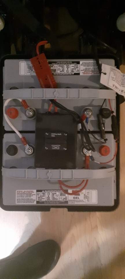

Also the cable in the pic with a label and fuses can I use a Anderson sb50 to connect it instead of having it " hard wired " like it is?
Posts: 1101

Postby fishinjunky » 20 Dec 2021, 17:57
Label
Posts: 1101
Postby fishinjunky » 20 Dec 2021, 18:08

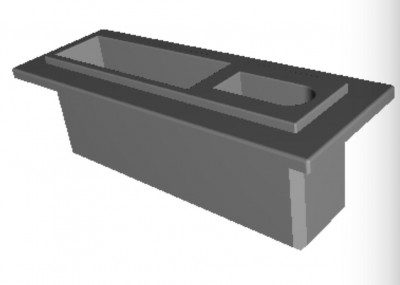

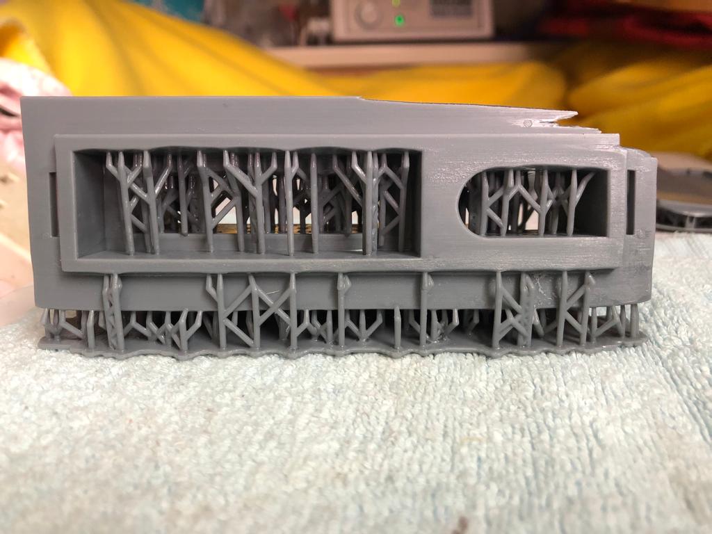

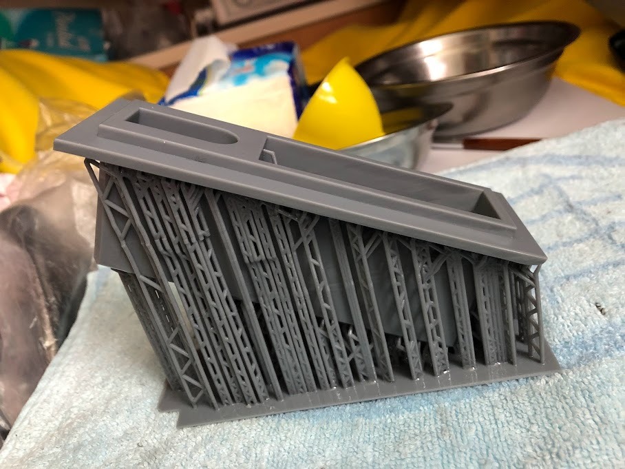

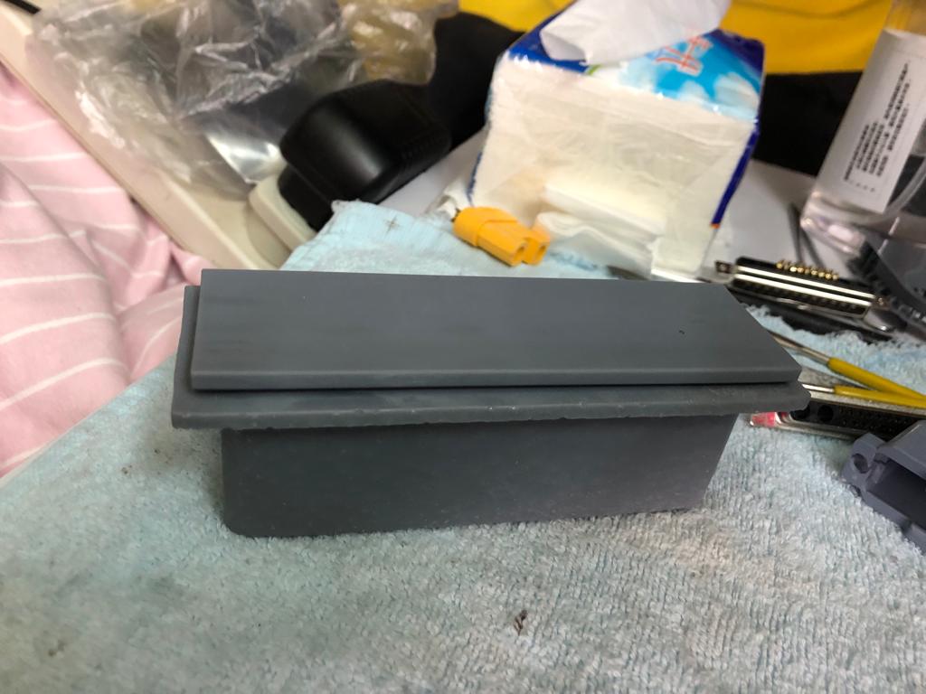

Postby shirley_hkg » 21 Dec 2021, 00:38
Battery box has room left, after 8 of these 230Ah cells.
I'll incorporate both PL8 & BMS charging into my next pack.
Dsub + XT120 connectors.
Postby shirley_hkg » 21 Dec 2021, 00:45
cheers
Postby shirley_hkg » 21 Dec 2021, 00:47
:dance
Postby shirley_hkg » 21 Dec 2021, 01:58
:dance
Housing for the connectors. cheers

Postby expresso » 21 Dec 2021, 04:43
fishinjunky wrote:Do you guys think 8 of the 230ah cells I posted above will fit my box?
Box measurements:
Length: 342mm
Width:   291mm
Hight: 254
i wonder what those little fuses are for on your batteries - and that breaker looks large - 120A ? looking at the connectors RED ones - they look like SB50 - from the wire thickness - but hard to see for sure - looks different than mines - one of these days i want to open my breaker box to see what is in there for real -
SB 50 come in Red also - my other chair has the Red ones from sunrise - before then they had the black - i guess they dont do all of them the same then
