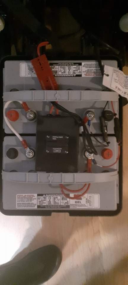

What would be better a fuse or the existing breaker on the power cable of my chair?
And what size and type of fuse would I use?
If you look at the picture you can see how big the breaker is and it may not fit with the lithium cells. Could I replace it with a fuse and larger diameter cabble?
Posts: 1101
Postby swalker » 13 Jan 2022, 04:26
I used a circuit breaker (which can be reset) and mounted it where it could be easily reset if needed.
Of course you could use an appropriate fuse, but if the fuse blows, you will be stuck until it can be replaced.

Postby expresso » 13 Jan 2022, 04:43
i had those thoughs also - worried about a fuse -
but they all come fused from the start - and 80A is the common size fuse - dont want to jinx myself - never blew a fuse before ever
i did use a breaker on my first pack chair - 100A its under my seat in the front - the idea was it can be reset if something - i still cant do it - but anyone else would be fine
never had to -
now i have a fuse on my new chair 125A - no room for a breaker inside the battery section - if i had to change it to a breaker - i have to run a longer wire outside to the front of the chair and mount it there - i hope the 125A fuse if fine -
i did another pack for a friend same thing 125A fuse -
you making me worry now - i may carry a extra fuse and tools to have someone replace if if worst case - would be a pain to explain but can be done by some one else
have you ever blew a fuse before - ? swalker
Postby Burgerman » 13 Jan 2022, 07:48
If you ever blow a fuse it is at times when you take maximum amps. I know I can blow 80A fuses in literally the first time I attempt to draw a lot of current. When do I draw the most Amps? I CANT destroy 100A fuses on demand.
So a 125A fuse is definitely adequate and safe. So I always fit 150A fuses to every chair KNOWING that its got at least a 50% extra above what I can do. And I know too that this is a safe thing to do as the fuse is only there to protect the cables. And that the fuse is definitely going to fail before the cables.

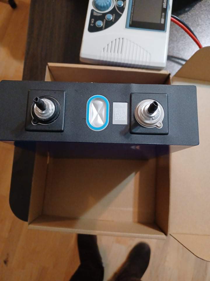

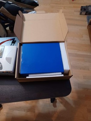

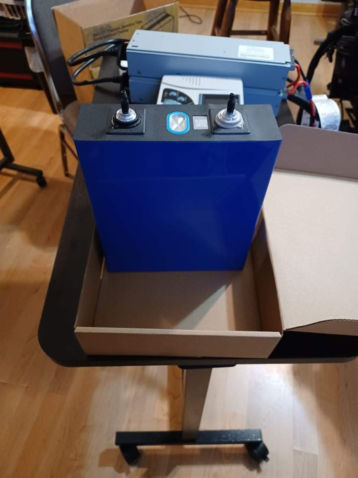

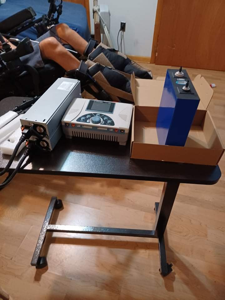

Postby fishinjunky » 13 Jan 2022, 17:30
Here's a picture of the iCharger 4010duo, 24v 69amp psu, and one of the eight 200ah cells.
My future setup is going to be the new iCharger dx8 duo coming out ( its can balance up to 4amps in sync mode) and a Shirley psu.
The cells were packaged really well.
Posts: 1101
Postby fishinjunky » 13 Jan 2022, 17:31
200ah cell
Posts: 1101
Postby fishinjunky » 13 Jan 2022, 17:32
200ah cell
Posts: 1101
Postby fishinjunky » 13 Jan 2022, 17:33
200ah cells

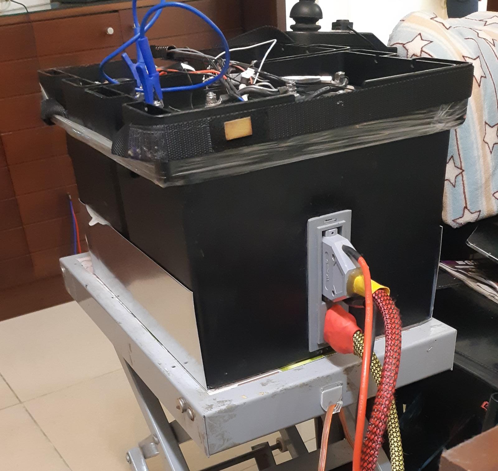

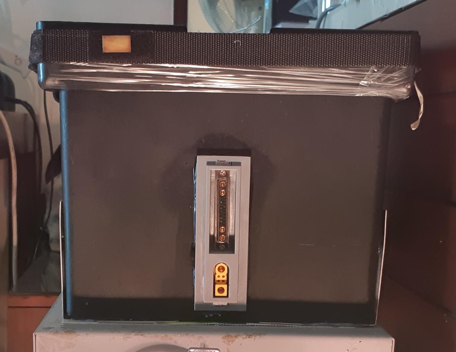

Having done a set a while back , I have my own set of the CATL 230Ah cells.
BMS & PL8 ready .
Posts: 4657
Postby shirley_hkg » 14 Jan 2022, 03:21
I bought only 8 cells withoue any spare , so it'd be unnecessary to do cell matching / screening at all.
Hook it up and charge directly.
My PL8 can't read cells 2,3 correctly , so this initial charge and balance will be using BMS and a power supply .
Cells came in with unknow SOC, but they did read 26.19V when assembled. I am quite surprised that ZXD2400 recorded 190Ah was put into the pack for the first charge , excluding all balance wasted. Cell capacity seems good.
Dsub is to feed PL8 for monitoring only. cheers

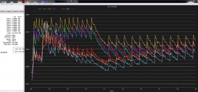

I set the charge volt a bit lower and raised it to 3.6V when it is partially balanced, to avoid prolonged exposure to over voltage of the high cells . :dance cheers
My PL8 cannot read cells 2&3 correctly. They should read as the average of their own. banghead
Glad to have alternatives , when PL8 is impossible. :clap :dance cheers
