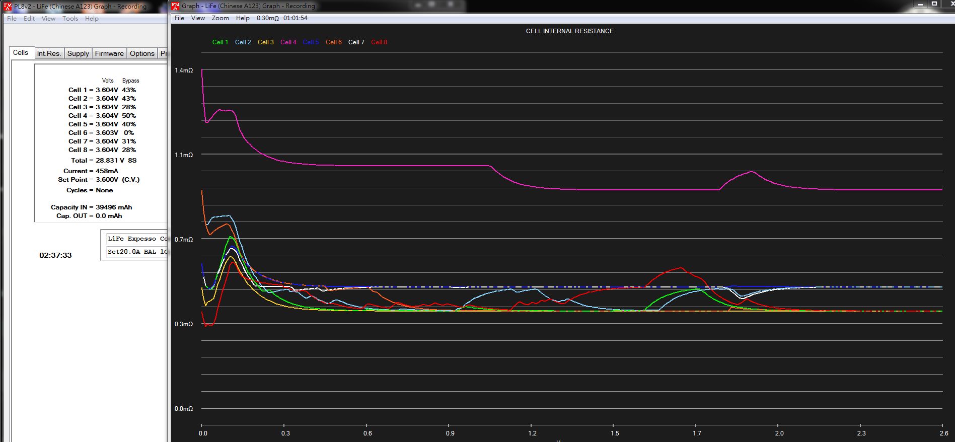

PL8 took 30 minutes to re-balance it, so it was basically balanced.
Cell4 has higher IR due to a 100A LittleFuse there.
