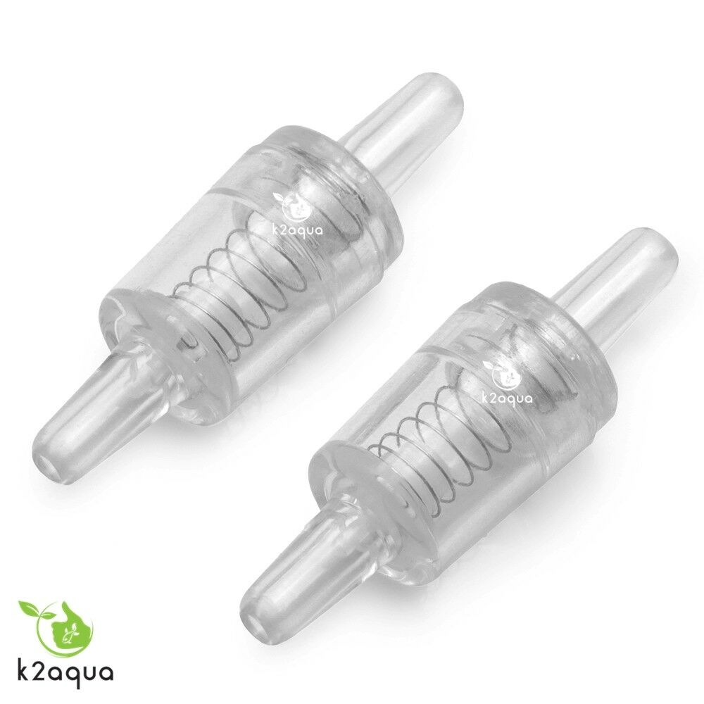

All 3 pumps allowed air to slowly escape via the piston in the tube. All same make. Swapped by Amazon...
But I suspect they will whatever the make. Its only a tiny loss but we are talking about very tiny differences in pressure here.
So I gave up on trying to get a perfect non leaky pump. And ordered those tiny one way valves instead. So that now THEY prevent air leaking back out from the pump. I should have done this to start with...
So the only difference is that I am now adding a one way check valve, directly after the pump. Maybe 2 or 3 inches from the end. Then the pressure n the cushion and pipework etc doesent slowly fall as you watch!
THESE work. https://www.ebay.co.uk/itm/283318275086
These also work, with spring - image below.
The other cheap ones with silicone only inside in various colours dont and are rubbish!
THIS post now UPDATED viewtopic.php?f=2&t=10285&p=172223#p172223
You put one way valves to prevent air leaking back out from the pump. Does that mean that the silicone grease is no longer needed? And that it is okay to use the pump that came with Roho?

Postby Burgerman » 20 May 2021, 09:23
You might get away with the roho pump. With a 1 way valve. But it tries to pump a lot of air at once. due to its diameter. So personally I would still use the smaller one. It allows better control. Try it.
When you assemble he pipes. Use a small smear of evo stick or other contact adhesive like bostic or rubber solution glue or something. It acts as a lubricant and seals all the push on connections because surprisingly, those do leak air slowly. I tested with soapy water when looking at were the air was going!
Yes, no silicone grease needed. Other than on the threads of those little plastic air valves. Or those leak slightly. But you can use vaseline or ordinary grease there.

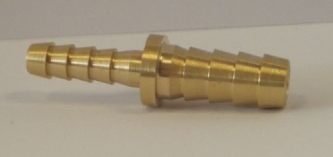

BM, In the picture of your digital gadget where I highlighted in yellow it looks there are two tubes that come to one tube, are you using a y connector there? (please see picture)
You also mentioned about a brass reducer (please see picture), where are you using it?
As always thank you for your help.

Postby Burgerman » 21 May 2021, 16:07
If you order the tubing from my link the Y connector is included.
You dont need the brass connector.

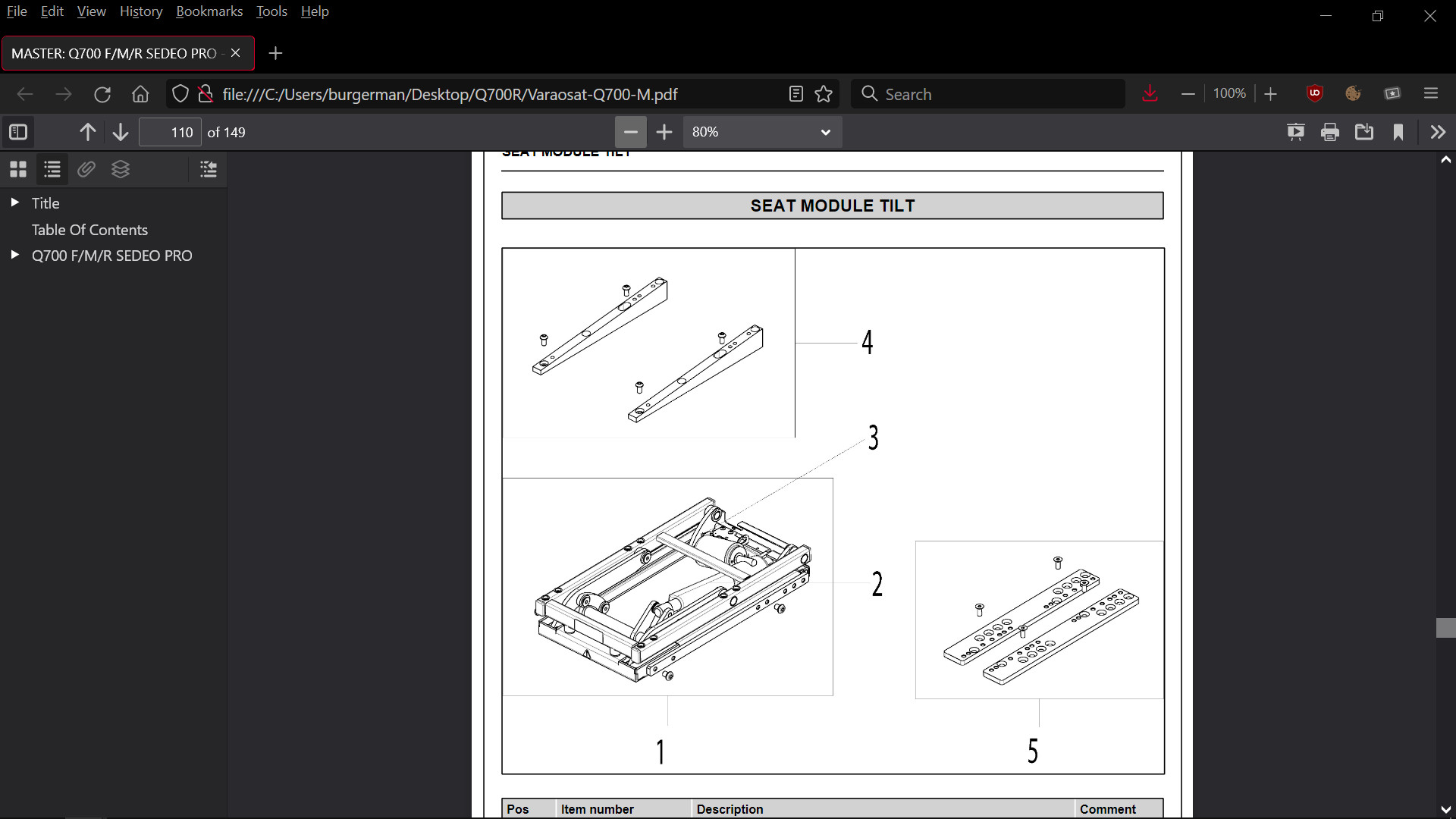

Why not adjust the seat dump base angle instead?
Posts: 69775
Re: PINNED - Cushions
Postby steves1977uk » 20 Aug 2021, 23:15
Not possible BM as the seat frame has the suspension springs under the seat on my old chair, and it has a piece of wood at the front of the seat to stop the cushion sliding forwards.
I've always used a wedged cushion.
Posts: 4395
Postby Burgerman » 20 Aug 2021, 23:30
Well theres also these (part no. 4 here) that go under the seat. Either way around...
Posts: 69775
Postby steves1977uk » 20 Aug 2021, 23:50
On my Dietz chair that would be easy, but not on my old daily chair which I need a new cushion for! :)
