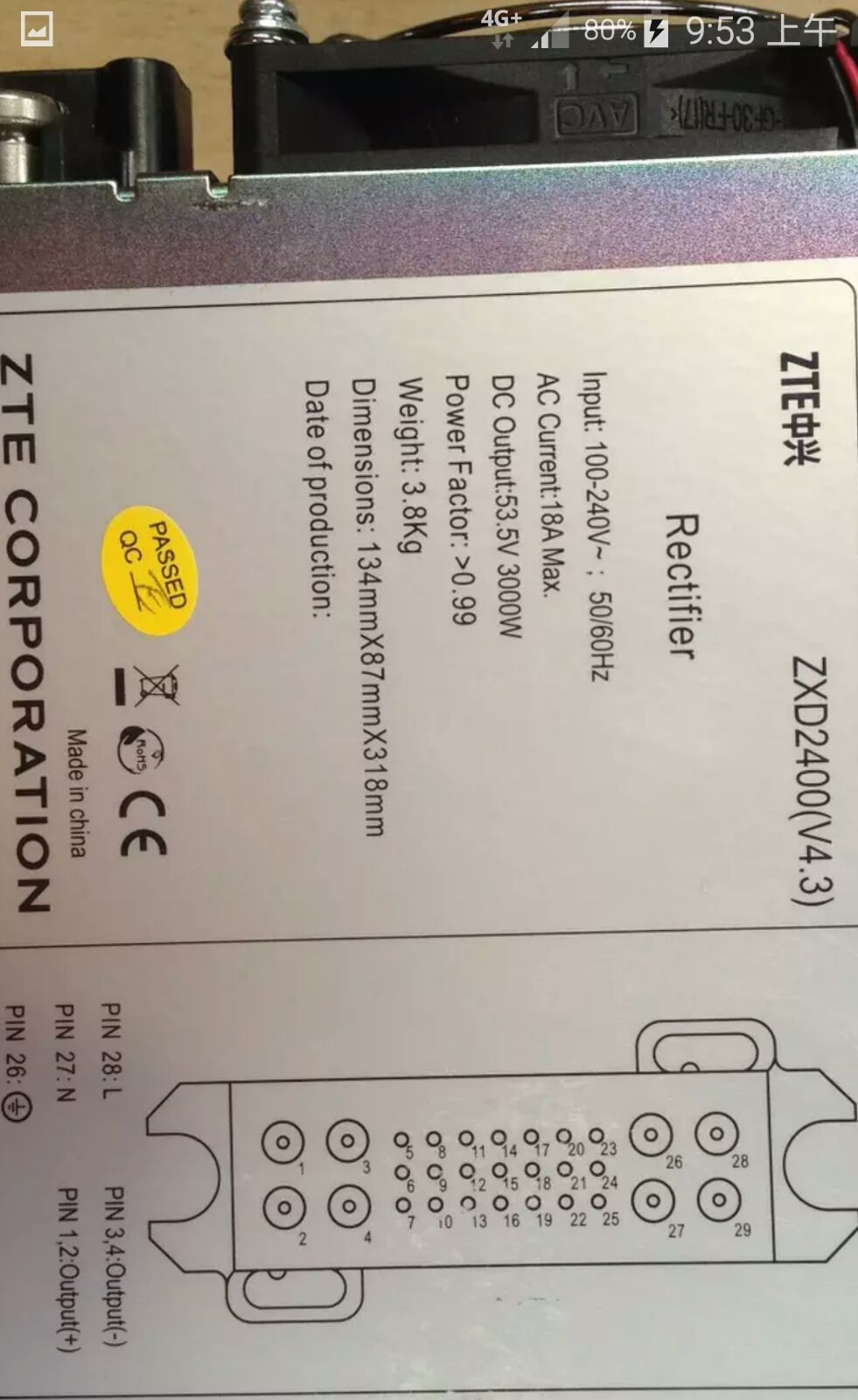

fishinjunky wrote:I didn't realize the ZXD was that compact. I can see the size compared to the PL8. .
No. You still haven't. It's 40% slimmer (without the aluminum outfit) in its stock case.
