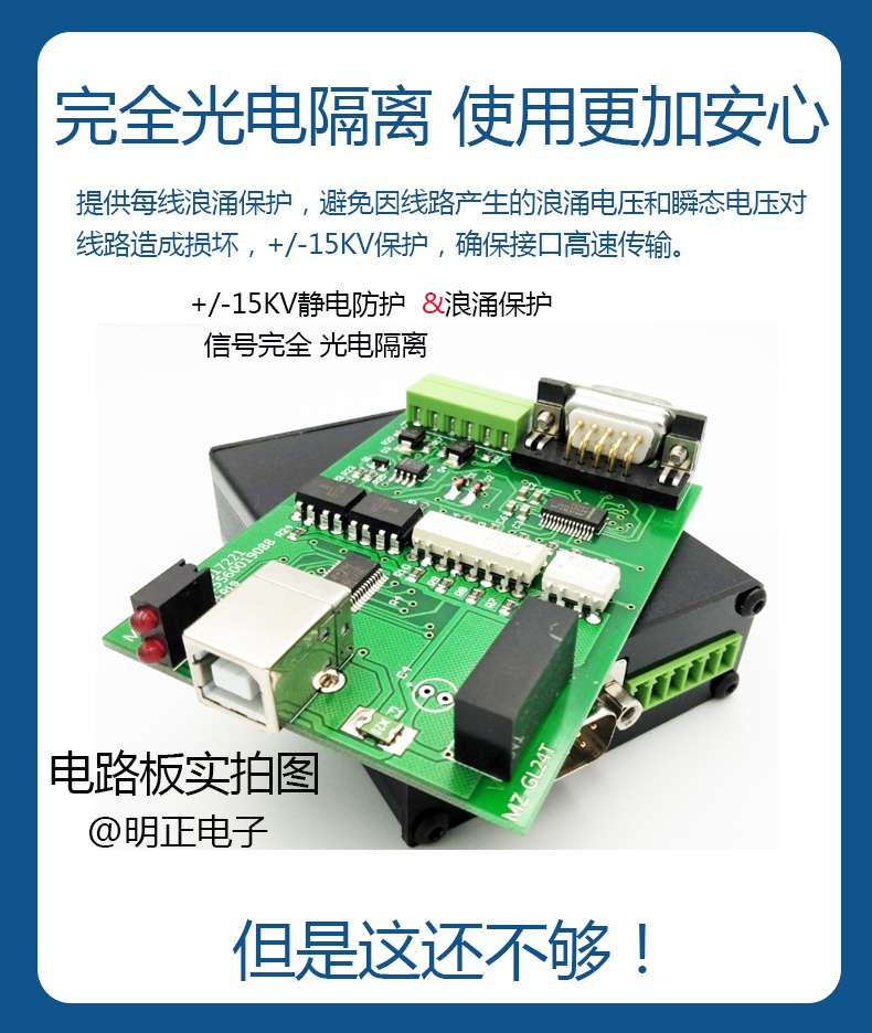

Postby shirley_hkg » 28 Apr 2022, 00:26
Would this be a candidate for our FUMI3 substitution ?
@$25 US
Posts: 4568
Postby shirley_hkg » 28 Apr 2022, 00:29
It has optic coupling , and a fuse breaker.
Posts: 4568
Postby snaker » 28 Apr 2022, 02:43
I think any serial usb cable with isolation protection will work.
This industrial one seems overkill.
https://www.amazon.com/Moxa-UPort-1150- ... B07S3ZCTSC
Posts: 1247
Postby shirley_hkg » 28 Apr 2022, 06:31
and connect as woodygb's diagram , doesn't it ?
As it is isolated , it is safe and do no harm when connected
revertedly. Right ?
Posts: 4568
Postby woodygb » 28 Apr 2022, 08:13
snaker wrote:I think any serial usb cable with isolation protection will work.
You will need TTL serial not RS232 Serial.
https://www.sparkfun.com/tutorials/215
@ Shirley ... The RED Positive pin has been deliberately located in the middle position ( this is common practice on most R/C hardware ...see pics below ).... thus it will always be in the correct "safe" position and only the Data and GND connections will be swapped over.
Postby shirley_hkg » 28 Apr 2022, 11:43
So , new owners of PL8 have way to use BM's DevCCS. Need not bother FUMI3 anymore . :clap :dance
Posts: 4568
