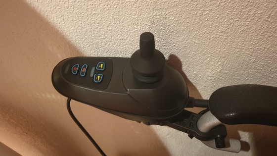

Hi All
My name is Norman and I live in Brighton in the UK.
I just got this a few weeks ago MobilityPlus+ Ultra-Light Instant Folding Electric Wheelchair | 24kg, 4mph
https://mobilitypluswheelchairs.co.uk/collections/electric-wheelchairs/products/mobilityplus-ultra-lightweight-instant-folding-electric-wheelchair
I have had to return it one time already to get it reprogrammed.
Sorry to say, it needs more changes again to help the reverse.
But I do not want to keep returning it every time I want small changes made.
Tried today to use the Mobility Programmer and sorry to say it does not work with this model.
After a few searches, I found a smiler unit by another manufacture https://www.aliexpress.com/item/1005004207683422.html?
Mine is the same unit and has the same model number X2445B-QX01. But mine is made by Yanteon
Yet when you go to the Yanteon website, they do not even list this model http://en.yanteon.com/proclass.aspx
I have emailed Yanteon and L-faster to see if they can help with what software it uses.
Also, I have emailed cw-industrialgroup to see if I could buy one from them and just up grade it.
I do like the wheelchair, but the controller is not as good as my old wheelchair.
If anyone can help on how to program this Yanteon X2445B unit, I would welcome your feedback.
Many thanks
Norman

Re: Norman - Brighton UK - Controler X2445B
Postby Burgerman » 19 May 2022, 19:37
I am not aware of any programmer that we can get hold of that could program it. It may not even be the programming but the whole way that the phone book full of computer code was written. You may be a little stuck. This is a an issue with these cheap chinese chairs.
Postby Norman M6NBP » 19 May 2022, 20:10
This is why, I would also like to know if I can change the joystick controller, with a much better make.
Any recommendations will be welcome

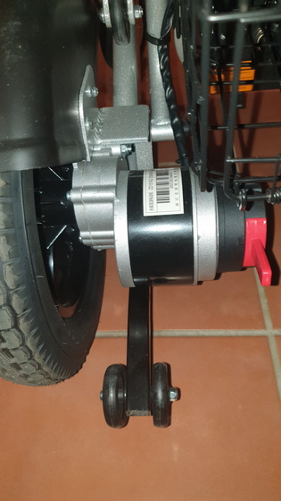

Postby Burgerman » 19 May 2022, 22:39
If the motors are simple DC permanant magnet then yes. But it will not be cheap unless you use used parts.

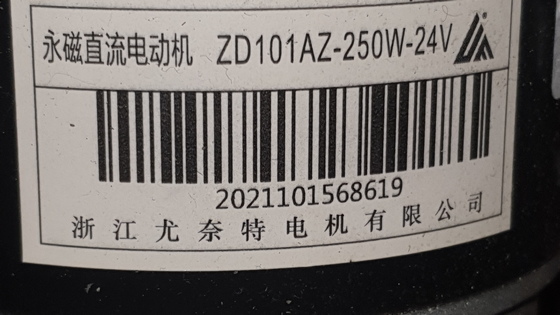

Postby Norman M6NBP » 19 May 2022, 23:15
This is what is on the wheelchair
Norman M6NBP
Posts: 10
Joined: 19 May 2022, 15:17
Postby Burgerman » 19 May 2022, 23:19
That doesent help.

Postby woodygb » 21 May 2022, 00:02
Norman M6NBP wrote:This is why, I would also like to know if I can change the joystick controller, with a much better make.
Your joystick pod is described as a
X2445 Brush Electric Wheelchair Controller
http://en.yanteon.com/products/show-308.aspx
Curtiss Wrights VSi would be a suitable replacement BUT it would require adapting the wiring of the VSi to your brakes and motors.
