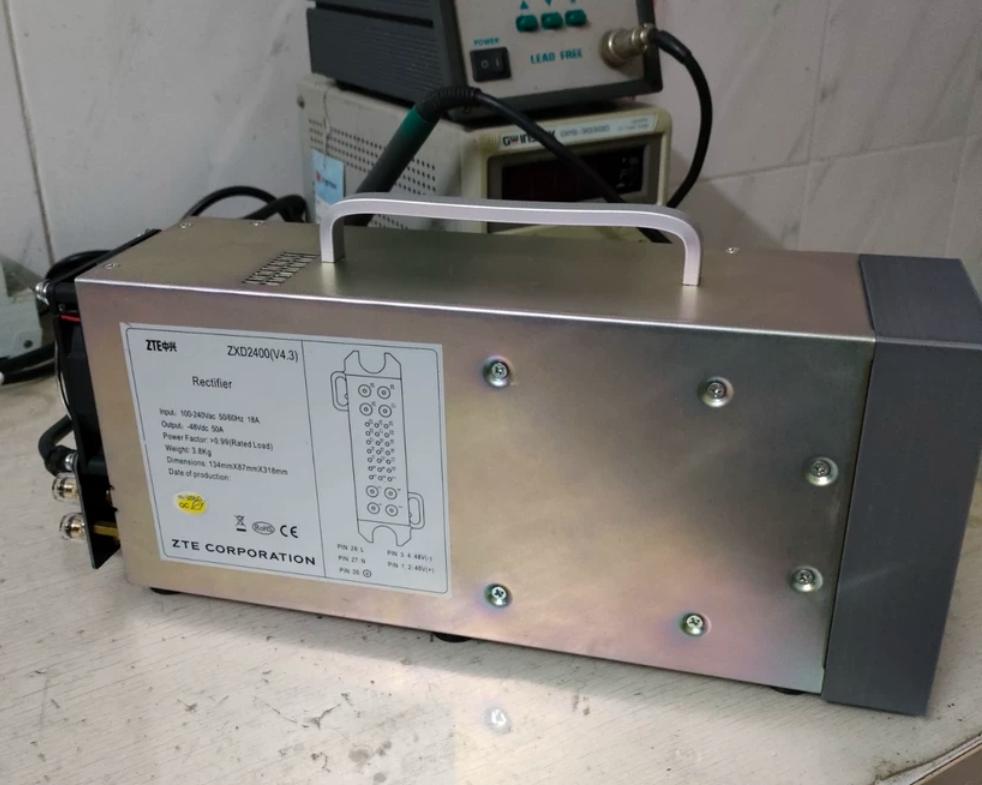

Postby fishinjunky » 26 May 2022, 13:32
Testing a Anderson SB50 + XLR split cable.
12.5A will be fine, in cool days.
10A is more comfortable , all year round.
This unit is QUIET.
You'll get a nice ZXD, Jeff. cheers
I really should have gotten 2 of these but like BM I'm in savings mode for now. Will you have any available in the future?
This is by far the best psu a person can get especially for the price. From what I've seen simular power supplies go for 400$ or more
The server 24v psu type I'm using is risky with a iCharger.

Postby shirley_hkg » 26 May 2022, 16:06
fishinjunky wrote: Will you have any available in the future?
Quite possible, when we met a minimum lot.
This is by far the best psu a person can get .
We should get an adjustable PSU.
I had no expectation of it when I diy the first unit.
It is good , and not one died so far.
Do need more consideration when use on 117V.
