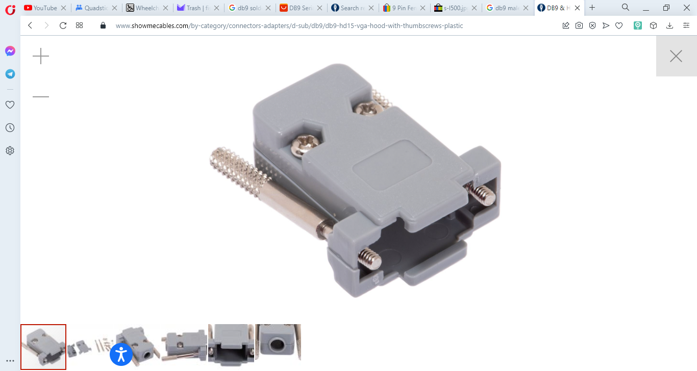

im going to replace my balance cable connectors from 3 mt30 connectors to a single DB9 connector. while keeping the main charging cables separate using a SB50 connector. Where in the U.S can i find good quality db9 connectors atleast 5amp rating. heres links for male an female db9 solder kits but i want the male db9 with thumb screws an the female db9 with jack screws like in the screenshots i attached. That way i can secure them together. Any thoughts help or links will be greatly appriciated :thumbup:
db9 male kit
https://www.showmecables.com/db9-male-s ... it-plastic
db9 female kit
https://www.showmecables.com/db9-female ... it-plastic
housing with thumb screws for male db9

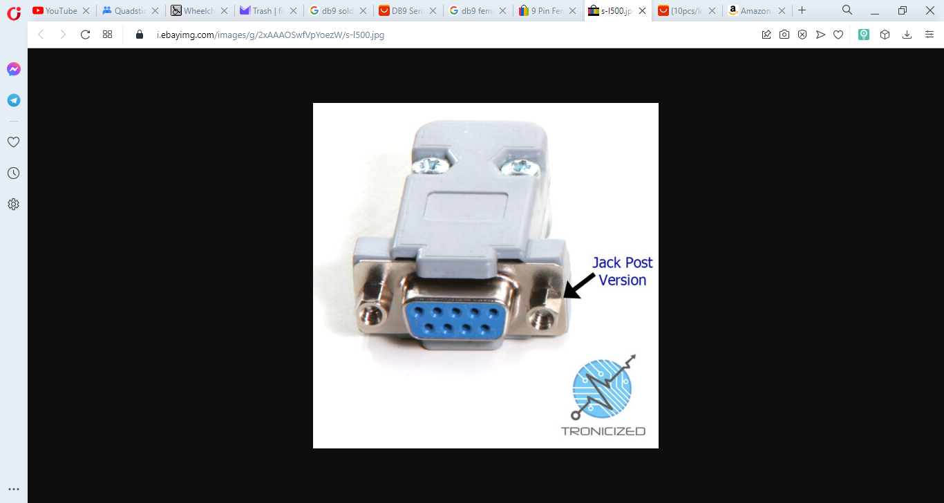

female db9 and housing with jack screws

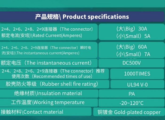

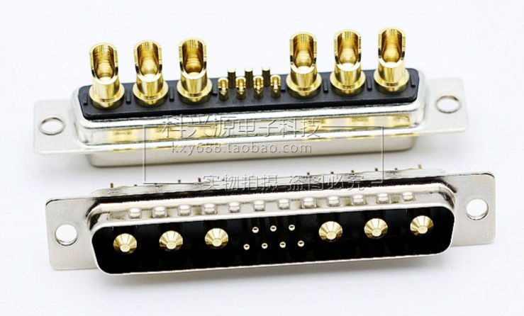

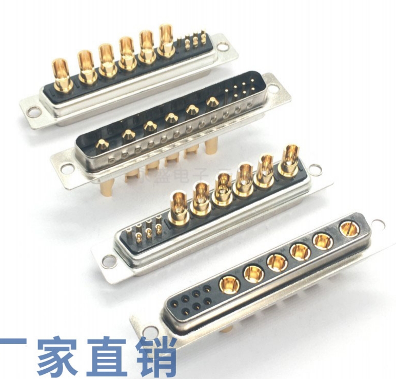

I'll either use the d-sub same as yours or the one shirley_hkg posted the HY2+9P one but the 2 big contacts are only 30amps an the small contacts are 5amps. I sometimes charge at 45amps but not any higher so the connector would need to handle that. We just like the sb50 connectors a lot they give such a good strong connection. Bm which to you think has a longer life span in the same application a sb50 or a d-sub?

Postby shirley_hkg » 10 Jul 2022, 15:49
These are better.
Single large pin rates 40A. You will have 2 for each main cable . @$4.3

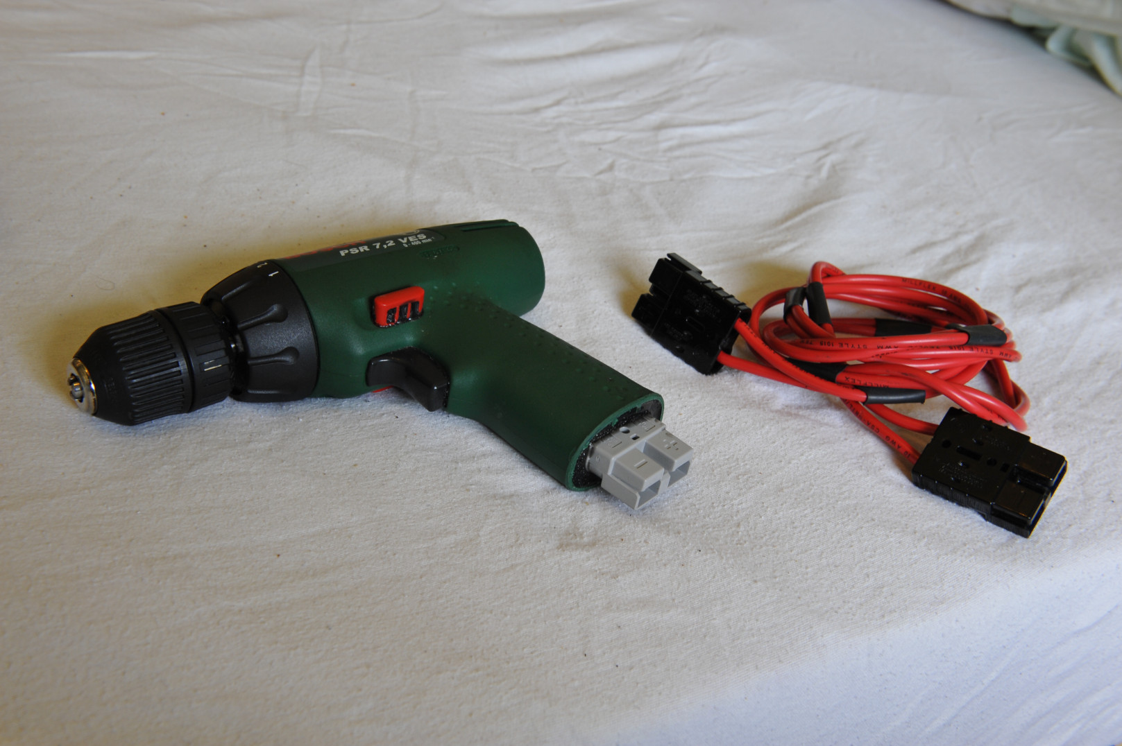

Which last longer? Probably anderson. But they only have 2 contacts. You would need lots! You should fit anderson too.

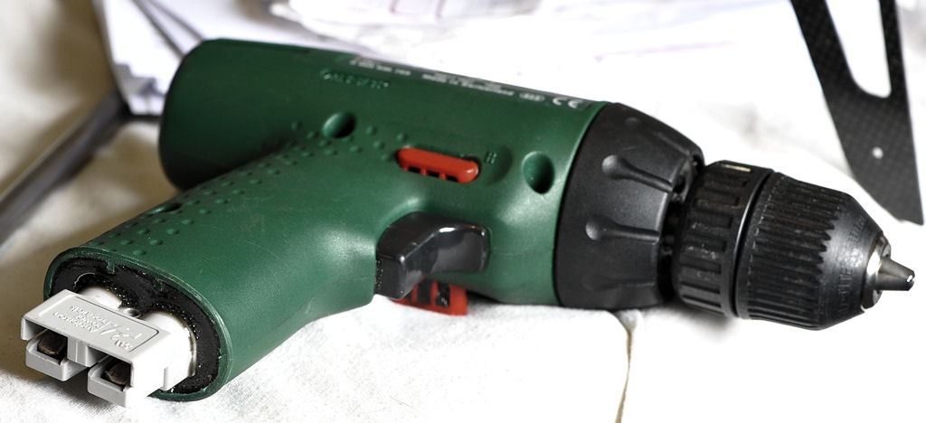

I have one or two on everything. Drills, aboyt 10 chargers inputs and outputs, vehicles, chairs, my bed, inverters, solar system panels and connections and outputs in my room, lots of things like car polishers, etc. Even on my RC stuff like the goggles I use on FPV planes and quadcopters. And on my patient hoist. That thing always has a partly dead battery. It frequently refuses to lift me even if full as the batts are too high impedance. And it just bleeps. It only does about 3 lifts per charge even if the batt is new..
Posts: 70438
Postby ex-Gooserider » 12 Jul 2022, 01:32
I agree, but I find that I like the smaller 15/30/45A powerpole connectors better for most things as they aren't as huge as the SB-50's... My chair that is still on lead bricks, I have the main charge / power wires done w/ PP-75 powerpoles in a compact 2X2 block, w/ a matching jumper block to bridge the two 12V batts to make 24V... I then put a pair of wires to a smaller pair of the PP-connectors across the otherwise empty 24V pins, which I use to connect anything I want to run off 24V...
This lets me make lots of jokes about my 'cordless' drill that runs off my chair....
Postby Burgerman » 12 Jul 2022, 08:30
Ditto... I too have a cordless drill.Now its corded. It runs better off the chair. Or the van. Or the lawnmower. Or the solar system. Or any of my power supplies or reserve battery. Or wherever I happen to need it. And its always "charged".
Hacksaw, black epoxy, soldering iron. Much cheaper than a new battery. When I say everything has an anderson on it I mean it! :D

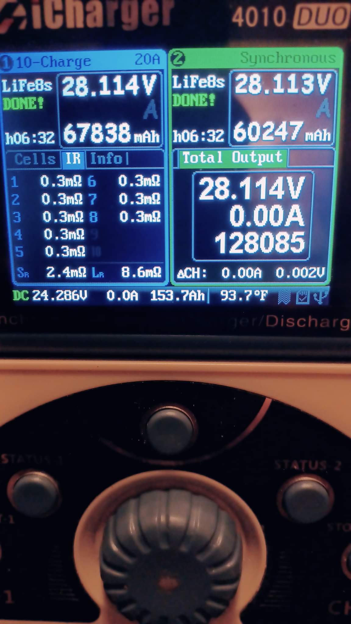

This picture is around 5hours after a full charge has finished an the cells have settled I plugged back in to check voltages an I see cell 8 is around 0.011 Volts higher than the others. Is this a problem?
Posts: 1089
Postby Burgerman » 19 Jul 2022, 23:54
No. All cells have a slightly different self discharge rate, and that charge voltage is higher than the full voltage (and there isnt one) So they were all held at 3.55 or 3.60V for at least 15 to 30 mins after balance finished? Then all are 100% full.

I was checking on IR of the cells while charging at 20amps. I noticed cell #1 is 0.3 IR an the other 7 cells are 0.4 IR. But when not charging all 8 cells show 0.3 IR. Is this something I should be concerned about?
What would you guys consider a high IR in a 200ah cell?
What would you guys consider a low IR in a 200ah cell?
IR while charging at 20amps
IR while off charging

Thhe resistance of a cell is lower than that of its connections, cables, and the chargers ability to measure this. Dont let this worry you.

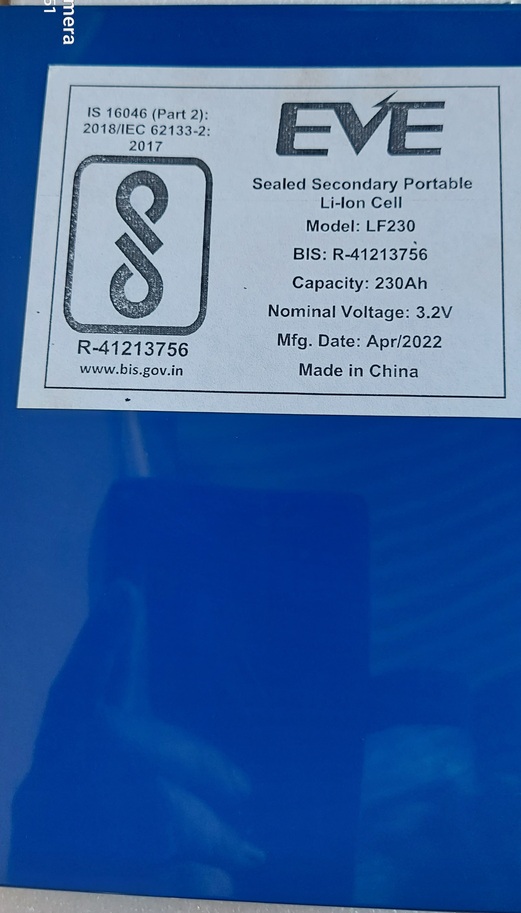

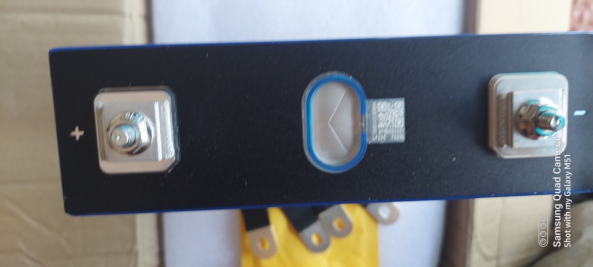

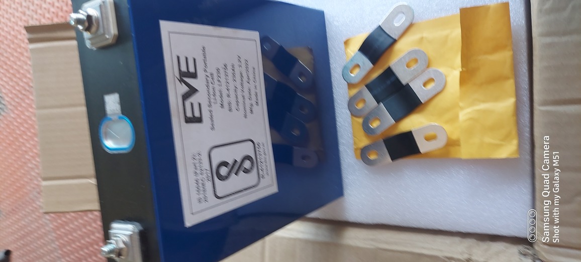

Postby Furio » 10 Sep 2022, 17:14
A set of lifepo cells arrived. Not a familiar brand, 230ah.Is anyone using this make of cells?
@BM Please give a preset for charging individually and as a set.Thanks.

Postby Burgerman » 10 Sep 2022, 17:19
Can you show a link to the supplier?
EVE are well known.
So I can see prices and dimentions etc. Thanks.

Postby Furio » 11 Sep 2022, 10:27
Hi BM,
The supplier is from India and he doesn't supply the cells abroad. The cells cost US $132 each. I am attaching the specs.
EVE-230Ah-Lithium-Iron-PhosphateLiFePO4-LFP-Battery-Cell-Product-Specification.pdf
(154.75 KiB) Downloaded 126 times
