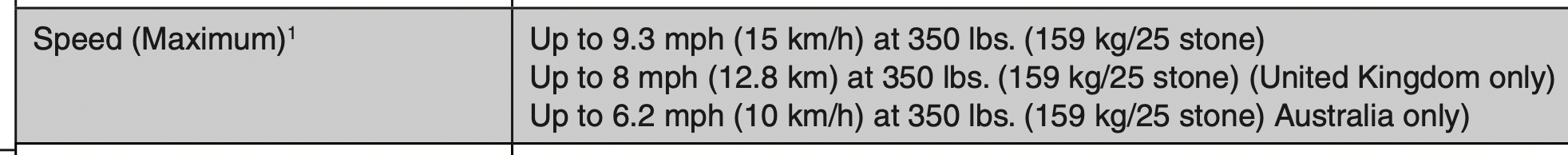

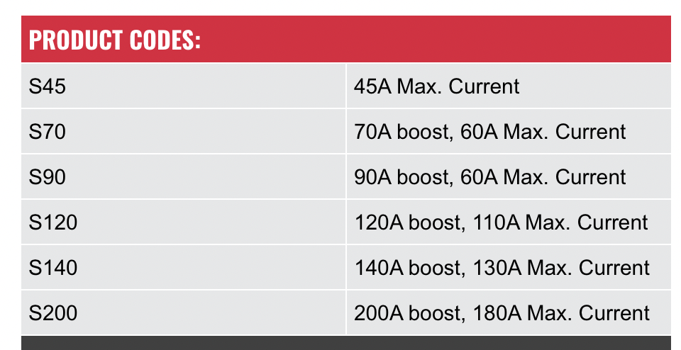

Anyone know what make of mobility scooter controller Pride mobility use?
Also the scooter has two motors, so I don't know if it has two single output standard scooter controllers aka like S-Drive?
Or whether it would use a powerchair controller like R-Net?
When I got my sunrise scooter it was capable of 15kph, but limited to 12kph for UK.
But cos it was a single S-Drive controller it was easy to overcome with one of Woody's leads and the PGDT OEM software
I was hoping the Pride scooter would be as easy to change the programming. AKA remove the nazi wall as BM puts it.

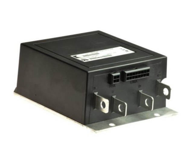

I think I've found the controller type. I would guess it's two of these curtiss wright
Can we access curtiss wright stuff?

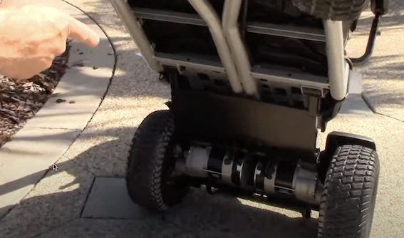

Two motors?

Postby Burgerman » 30 Aug 2022, 22:25
Pride use a lot of curtis instruments stuff. Not curtiss wright, thats a UK company that make R-Net, and other controllers like pilot plus, and their scooter controllers etc.
Curtis Instruments make all prides Q-LOGIC chair controllers etc for them.

Postby woodygb » 31 Aug 2022, 00:50
Scooterman wrote:The USA version is called the Wrangler.
As John says ... CURTIS INSTRUMENTS not Curtiss Wright.
Neither the cable or the software is a problem for that controller .
https://cdn.curtisinstruments.com/produ ... ual_en.pdf

Postby Scooterman » 31 Aug 2022, 06:53
Thanks BM, and thanks Woody for the Curtis manual, that's really useful, I've saved it to my mob programming folder. :thumbup: So it should be simple matter of removing the top speed nazi wall, just as you helped me with my existing 15kph scooter Woody.
Ah, Curtis AND Curtiss Wright, different companies, different countries, well I never! They shouldn't have similar names like that as it confuses Einsteins like me
I will read through the manual, but it's got to be a separate controller for each motor. I was thinking that with two separate controllers it must be difficult to sync them. But I suppose if the throttle output branches off to each controller, then the controllers are gonna output same voltage to each motor and scooter go in a straight line, and not crab off into the nearest ditch :ambulance

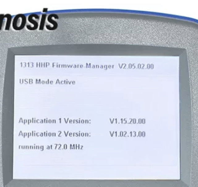

Postby woodygb » 18 Sep 2022, 11:02
Maybe it wouldn't be the hand programmer. 1313- 41.. , the option? Seris Maybe the 1313-4101 is the most suitable?
A little research has suggested that the 1313 Hand Held with software version 01.037.000 should work.

Postby FelipeOliveira » 20 Sep 2022, 23:42
Hello Woody, would this be enough in your opinion?
