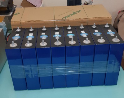

Postby FJC10 » 13 Dec 2022, 15:11
Burgerman wrote:You need to measure cell impedance, and cell self discharge rates individually. Not just capacity to see that all are similar and low. That alone will take a month sat to test.
And not promising.. photos. DALY BMS shown has an unbelievably low balance current capabilty of around 30mA... So while it looks pretty. It is actualy pretty useless. Even if he had a clue how to configure it. So I would certainly test.
I understand, wouldn't you buy it? Everything you see in the photos is sold to me for 750€ shipping included. Do you think the risk/benefit/"speed of delivery" is justified?

Postby shirley_hkg » 14 Dec 2022, 10:32
These EVE -105 cells are difficult to deal with , especially those use 4mm threaded terminals .
Go for CATL. They are good , even used stuffs .

Postby FJC10 » 14 Dec 2022, 16:44
shirley_hkg wrote: These EVE -105 cells are difficult to deal with , especially those use 4mm threaded terminals .
They are LiitoKala, I don't know if you also call them EVE.
What exactly do you mean by "difficult to deal with"?
He sells that whole set for 750€ shipping included, and I think it is a very good price. And I only really need 8 cells, because with 105 Ah I have enough, I have now 108 Ah Headway and I have enough, but I want to reduce weight and make the assembly easier and safer than with the 72 Headway cells that I have and these prismatic cells weigh half as much for the same energy or twice as much energy for the same weight and many fewer connections and points where they can fail, I think. A cleaner assembly.
I would sell my Headways and 8 prismatic cells and the rest of BMS and solar station battery pack and I think I would get everything at a very good price, unless you say that these LiitoKala are very bad and will give me more problems than the Headway.
Where can I buy quality CATL at a good price in Europe?

Postby Burgerman » 14 Dec 2022, 18:16
Headway cells are 10C rated. And high quality. So you can safely pull half that from them with no real problems. With the flat prismatic cells which are more energy dense, but much lower C rate you really need all 16 cells. Or will probably have problems. They are much less electrically "strong".
When shirley says difficult to deal with he means they have a very short small thread drilled into the terminal. Which was very problematic. Many on here fave stripped them without using much force or found them to have pulled out or come loose causing balancing issues or worse.

Postby FJC10 » 14 Dec 2022, 23:15
Burgerman wrote:Headway cells are 10C rated. And high quality. So you can safely pull half that from them with no real problems. With the flat prismatic cells which are more energy dense, but much lower C rate you really need all 16 cells. Or will probably have problems. They are much less electrically "strong".
Is 8x 230Ah CATL better or would I also have lower C rate problems or something?
8x 230Ah CATL batteries will also fit in the wheelchair slot, cleanly and without many connections

Postby Burgerman » 14 Dec 2022, 23:17
The more Ah you have the less c rating is needed. Because with double the battery Ah you take less Amps from each Ah.

Postby shirley_hkg » 15 Dec 2022, 00:23
I bought 100 cells and they seemed perfect , but some cells got high IR for no reason (just during storage).
Go to pages 160, 163, 203 of this thread.
I now use CATL .
https://www.wheelchairdriver.com/board/ ... start=6270
and next page .
